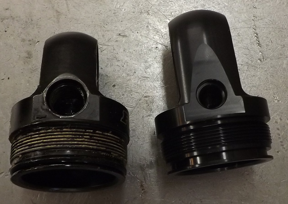

pontoontodd Posted May 15, 2016 Author Share Posted May 15, 2016 One thing I'm changing while we're going through the struts is swapping out the top caps with some that have a bigger bearing. The fronts were both badly worn and don't have as much time on them as the rears. These also have a smaller hydraulic port which matches the smaller hoses we're using now. The bushings I'd made before (bottom) were super too since we're using 12mm bolts and the old bearings have a 1/2" hole in them. The new bushings are easier to make and should hold up a lot better. Quote Link to comment Share on other sites More sharing options...

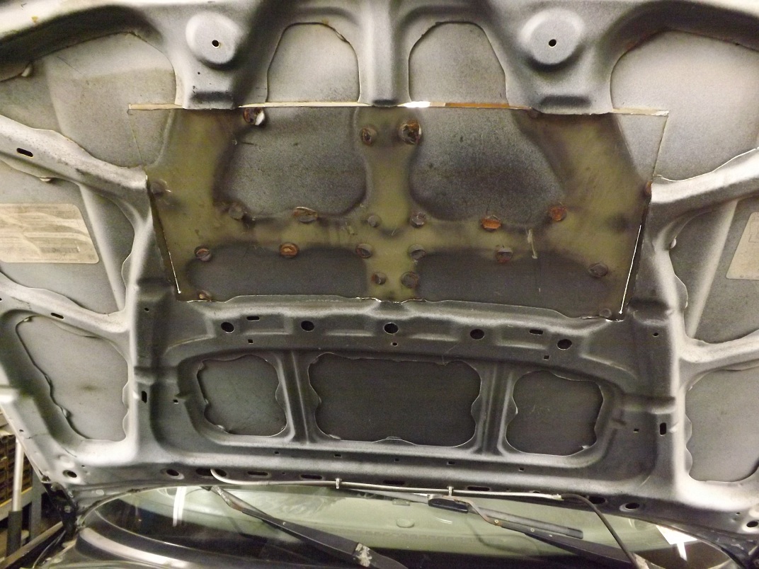

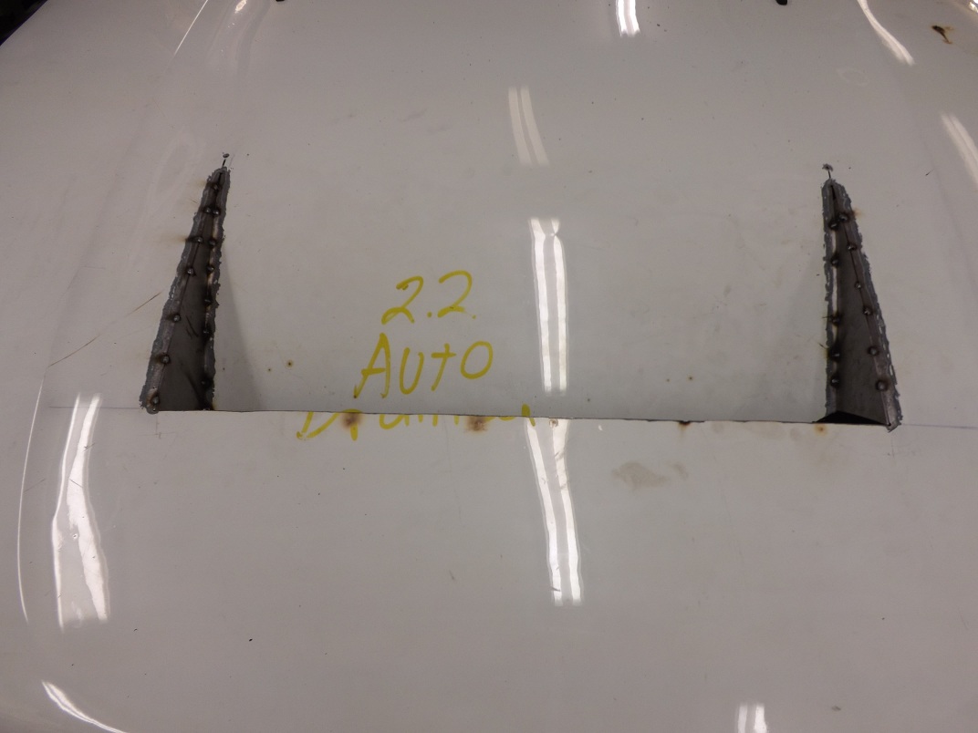

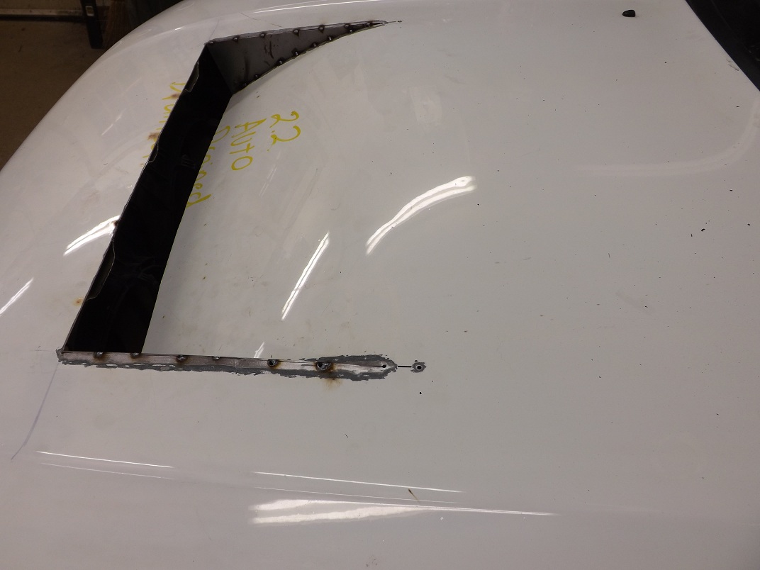

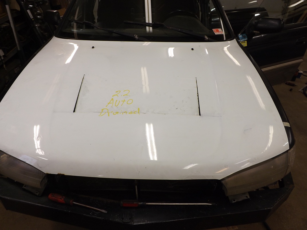

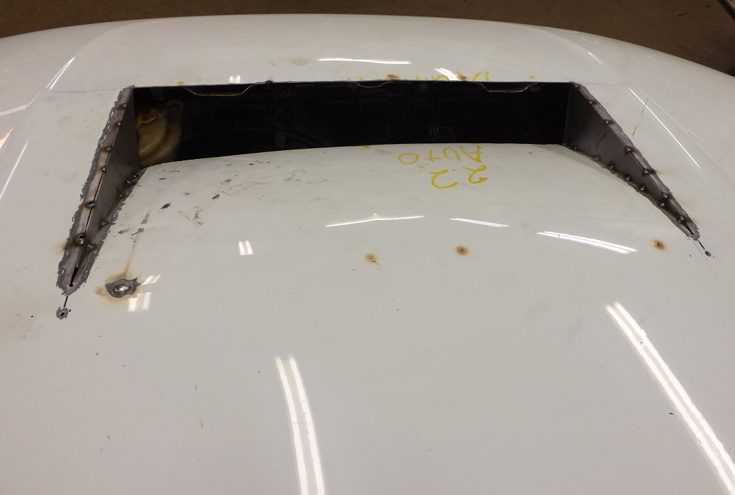

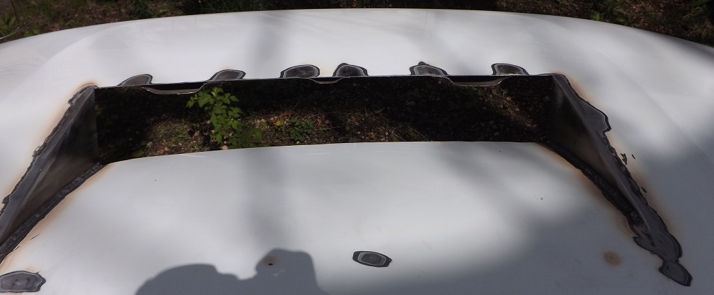

pontoontodd Posted May 26, 2016 Author Share Posted May 26, 2016 Here is the vented hood we tried. Started by cutting a U shape. Cut out some of the ribbing under that section. Bent it down as far as we could while leaving about an inch of clearance between the flap and the accessories. Tack welded in some pieces of sheet metal on the sides. Welded and sanded it. Still in the primer / sanding phase. A few days ago it was 80F so we did some cooling system testing. Unplugged the radiator fans for better consistency, removed the air dam, covered the rear heater core, and taped a piece of cardboard over the vent in the hood. My friend brought his bluetooth OBDII plug and loaded the app on my tablet. The temp gauge doesn’t register until the ECU says about 110F, then gets up to the bottom of the thermometer (middle of gauge) at 150F and stays there until it gets over 210F. 230F is about the top of the thermometer picture, almost 3 / 4 of the way up the gauge. So the gauge is very non linear. It did seem to normally register a rise in temperature slightly before the ECU but they otherwise followed each other consistently. Going up the highway at 65mph with the AC on the temps only got up to 200 or 210F. By this point the cardboard had blown off the vent, it clearly had higher pressure underhood than above. On the interstate at 80mph the temps crept up to and stabilized at 230F with the AC off. We put the air dam on, didn’t seem to have any effect. Then we taped over the hood vent more securely this time. It may have increased the temps a couple degrees being blocked off. Perhaps with the fans on the vent would be more helpful. Then we removed the cardboard from the hood vent and the rear heater core. Without the rear fan on, it lowered temps to 226F. With the fan on the temps immediately started dropping, going down to about 210F. We were then able to run the AC and the temps went back up to about 226F. So the hood vent and air dam seemed to do almost nothing. The rear heater core without fan was good for five or ten degrees, with the fan it dropped temps about 20 degrees. Turning the AC on raised the water temp about 15 degrees. After that we put the stock hood back on. The next day driving around town in 87F weather with the AC on full blast and the radiator fans plugged back in it ran at the bottom of the thermometer except for one time it started to creep up a little bit, maybe 220, and then went back down. Never turned on the rear fan. The day after that it was in the low 80s. We drove the OB out to our friend's test area outside of town at 60-65mph. AC on the whole time, temps at the bottom of the thermometer. We took the Subaru out in his yard and beat on it pretty hard. Everything was quite overgrown but I was hitting some of the little jumps faster than I think we have in the past. After a while I noticed the temp gauge was at the top of the thermometer so I turned off the AC and turned on the rear fan. After the temps dropped I turned the AC back on. When we headed back on the highway I had to have the rear fan on most of the time to keep temps at the bottom of the thermometer. AC wasn’t blowing very cold on the way home. Last year we were able to drive down to the off road park on a 90F day, beat on the car all day, and drive home, all with the AC on full blast the whole time and no rear heater core and no overheating. Then in TX during the race at about 70F we could only run the AC a small percentage of the time by the end of the day. The next few days down there in the 80s we had to run the heat quite a bit to keep the car from overheating. Now we never have to run the heat but occasionally have to run the rear fan if we want to run the AC in the 80s. So even without using the rear heater core it's better than it was in TX but not as good as it was last year. Next week I'm getting a new AC condenser and evaporator. They're both pretty beat/dirty. I'm also getting a 2" Mishimoto aluminum radiator for early 90's turbo Legacy and used fans and overflow bottle. Seemed like the most likely thing to fit and hook up. Quote Link to comment Share on other sites More sharing options...
Uberoo Posted May 27, 2016 Share Posted May 27, 2016 For whatever reason you are not getting enough airflow through your radiator to effectively cool the engine even at speed.Non of my cars have needed a fan to keep cool above 30 mph because the car was pushing enough airflow through the radiator.Why wont yours? *Do you have a 2.2 or 1.8 radiator hooked up to a 2.5L engine? *Can you see through the radiator/ac condenser or is it plugged solid? *Are you using an OEM thermostat that is operating properly? Driving down the road at any speed above 30 the car should be ~200*F because its not generating enough heat/work to really be working the cooling system,At 60 mph it takes about 40 hp to maintain 60 mph on a flat level road with no wind.In other words,about the same as a 1.0L geo metro.If your overheating at that speed on flat ground something is very wrong with your engine. Do you have enough coolant,and is it the proper mix for summer weather?Do you have enough oil in the car?Are you sure you don't have a blown headgasket( quite likely if your running at 230+*F). Something is not right if it is struggling to stay cool, from the factory it was basically designed to do 80MPH+ through death valley for hours at a time with the AC on and not overheat. The vented hood,the rear heater core,fans,etc are all masking some problem and until you find out that is it will continue to run hot.Period,end of story. Quote Link to comment Share on other sites More sharing options...
Uberoo Posted May 27, 2016 Share Posted May 27, 2016 These articles will better inform you about what goes on under the hood,and maybe even give you ideas on how to modify your cooling system in a meaningful way once you get to the root cause of why you are overheating. http://www.autospeed.com/cms/article.html?&A=113176 http://www.autospeed.com/cms/article.html?&A=113177 http://www.autospeed.com/cms/article.html?&A=113178 Quote Link to comment Share on other sites More sharing options...

pontoontodd Posted May 31, 2016 Author Share Posted May 31, 2016 For whatever reason you are not getting enough airflow through your radiator to effectively cool the engine even at speed.Non of my cars have needed a fan to keep cool above 30 mph because the car was pushing enough airflow through the radiator.Why wont yours? *Do you have a 2.2 or 1.8 radiator hooked up to a 2.5L engine? *Can you see through the radiator/ac condenser or is it plugged solid? *Are you using an OEM thermostat that is operating properly? Driving down the road at any speed above 30 the car should be ~200*F because its not generating enough heat/work to really be working the cooling system,At 60 mph it takes about 40 hp to maintain 60 mph on a flat level road with no wind.In other words,about the same as a 1.0L geo metro.If your overheating at that speed on flat ground something is very wrong with your engine. Do you have enough coolant,and is it the proper mix for summer weather?Do you have enough oil in the car?Are you sure you don't have a blown headgasket( quite likely if your running at 230+*F). Something is not right if it is struggling to stay cool, from the factory it was basically designed to do 80MPH+ through death valley for hours at a time with the AC on and not overheat. The vented hood,the rear heater core,fans,etc are all masking some problem and until you find out that is it will continue to run hot.Period,end of story. I have to thank you guys for hounding me about the head gasket issue or looking at some other cause of the overheating. I've checked several times, even used the head gasket leak tester. Over the weekend we drove down to the Smoky Mountains. At one gas stop I left the engine running and looked in the overflow bottle and saw tiny air bubbles coming out the overflow hose. Maybe one every few seconds, 1/16 or 1/8” diameter. So the engine probably has a bad head gasket. Temps were in the 80s all weekend, had to run the rear fan quite a bit of the time on the way down, AC running the whole time. I had to shut off the air going up long grades a few times each day the whole trip. We met up with our friends who brought their street legal woods buggies down to do some sightseeing and hit some trails. Saturday we circled around Smoky Mt National Park mainly on paved roads, some of which (32) were miles of switchback turns. Not really my thing but I practiced using the turning brake a bit trying to keep up with them. That paved section of 32 was the only time I struggled to keep up. We did get to a one way road (Heintooga Round Bottom Road) that leads down to the Cherokee reservation. At the top a Jeep was heading down so my friend decided we should wait and use the bathroom so we wouldn’t be stuck behind them the entire time. Then a guy in a Subaru Crosstrek headed down the trail. Then a girl in a Mazda came flying in and shot down the road like she wasn’t even going off pavement. Then someone else in a late model VW headed down. That road was pretty fun, a little rough but driveable in basically any street car. Fortunately everyone we caught up to (all the cars we saw head down plus a few more) moved over to let us by, which was not the case on most other roads. We passed the Subaru shortly after starting but it took us a while to catch the Mazda. We weren't going super fast, just running a decent pace. For five or ten minutes after we passed the guy in the VW he was keeping up with us, then we got to some rough sections and never saw him again. We stopped in Cherokee for ice cream. Started heading back to Gatlinburg and stopped to watch the elk. They wanted to head back to the campsite to clean up so I decided to loop back on the Blue Ridge Parkway and hit the one way road again. Ran it a little faster this time. We did come across a native American family driving an 80’s monte carlo up the road the wrong way. Got back to the elk crossing area and took some pictures. We put on about 200 miles that day. Sunday we met them at the campground again and went to Max Patch, which is a 360 degree view of the Smoky Mts on a big grassy hill. Rode some interesting dirt roads down from there, probably the roughest trails we were on that weekend, again could have probably driven them in a stock Subaru. At one point we stopped in a parking area to use the bathroom and a minute after shutting off the Subaru coolant started steaming out from under the hood. The stock heater hose that's still in place had burst in the middle. I was able to reroute the hoses going to the rear heater core to just bypass the stock heater core. Fortunately we didn't need heat and got kind of lucky that happened in such a convenient spot. So I obviously need to replace the head gaskets. I have and will read up on this, but what else should I check or replace while the engine is out and torn apart? It's going through a quart of oil every 500 miles or so. I think it would make sense to hone the cylinders and replace the rings and bearings. Should I get reground cams? Should I replace the timing belt or oil pump? Is there some 30k mile $1000 JDM engine that would bolt in and plug in? How much work is it really to get an H6 to run in this car? One of my friends does have a 2.5L from a first gen OB sitting in his barn but I think it needs head gaskets also. I'm still going to replace the condenser and evaporator since those are both beat up and dirty. I'm going to see how well the thicker first gen legacy radiator and fans fit too, probably still try to make that work. It's nice to have some extra cooling capacity in case something gets clogged up or we develop another head gasket leak or something. Quote Link to comment Share on other sites More sharing options...
