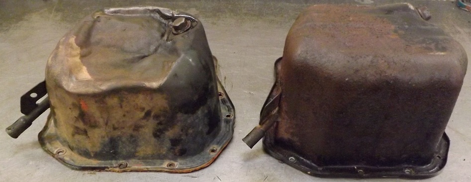

pontoontodd Posted March 22, 2015 Author Share Posted March 22, 2015 The oil pan is badly smashed in again. So bad this time the oil pickup tube was bent up a bit (found that out when trying to put a good pan on). The guard was bent up and the engine must be moving around quite a bit on the mounts since the valve covers appear to be rubbing on the crossmember slightly. The rubber in the engine mounts has been cracked for a long time. I got group N engine mounts, expensive but hopefully they will keep the engine in place better. Changed the guard a bit to make it easier to remove, farther from the oil pan, and a bit stronger. Hopefully it isn't too low now. Eventually I'd like to put a piece of 10" C channel under the oil pan. Quote Link to comment Share on other sites More sharing options...

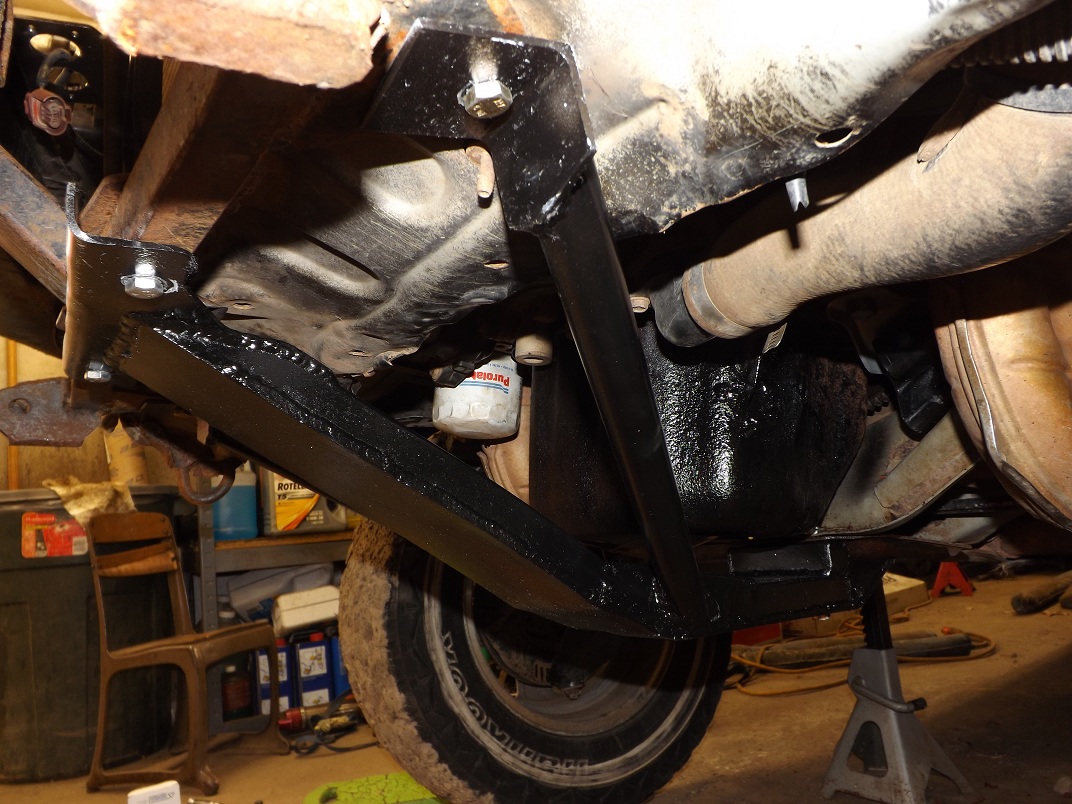

Uberoo Posted March 27, 2015 Share Posted March 27, 2015 (edited) and people say that long travel ifs doesn't help offroad...The long travel subi kicked a55 off road,it certainly seemed to go through that snow better than the stock subaru,and a hell of a lot better than the bronco.. ALSO: you might be able to keep the skidplate from bending if you make some bolt on supports from the crossmember.The skidplate right now is like 1/2 of a truss,lots of bracing on one side,but nothing holding those braces up. Edited March 27, 2015 by Uberoo Quote Link to comment Share on other sites More sharing options...
pontoontodd Posted March 27, 2015 Author Share Posted March 27, 2015 and people say that long travel ifs doesn't help offroad...The long travel subi kicked a55 off road,it certainly seemed to go through that snow better than the stock subaru,and a hell of a lot better than the bronco.. ALSO: you might be able to keep the skidplate from bending if you make some bolt on supports from the crossmember.The skidplate right now is like 1/2 of a truss,lots of bracing on one side,but nothing holding those braces up. The long travel definitely helps. Even with the 1.5" lift on the stock struts it was able to get up that 5' steep hill and the Impreza can't though. It does ride much better than the Impreza now. We definitely would have bent some struts on the Outback if we had driven it that hard on the stock suspension. And that Bronco has some city boy tires so that was holding him back some. We've done a little more tuning since then and the front is great now. Plan on going out Sunday to see how well it does in the mud/dirt, maybe some small rock piles. We have a bunch of other ideas on the front ends. One is to have a more solid lower rad support and have rails that connect either end of that to the bumper and then down to the swaybar mounts. Also instead of the rectangular tubing under the oil pan something like a 10" C channel that could sit up higher and surround the oil pan. If I did another one from scratch that's how I'd do it anyhow. How were you thinking of tieing it into the crossmember? Right now it bolts to the middle of the crossmember behind the oil pan. Any ideas on a shorter radiator or raising/tilting it for better approach angle? Something like a Cherokee rad and fans would be good but they're too wide. I've seen someone put the rad and fans on top of the engine but with no hood. Quote Link to comment Share on other sites More sharing options...
Gloyale Posted March 27, 2015 Share Posted March 27, 2015 Tie the front of the skid/lower rad support to the recovery hooks. Strongest point. Otherwise. Th Lower rad support will just keep pushing up every time the plate hits the ground. Been there, done that Quote Link to comment Share on other sites More sharing options...

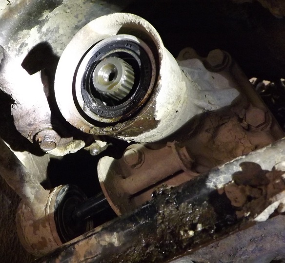

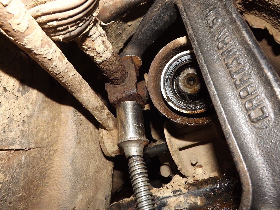

pontoontodd Posted April 2, 2015 Author Share Posted April 2, 2015 Here's a little trick I figured out that might help someone down the road. I got the nut off the top of the shift linkage bolt but couldn't break the bolt loose. I was starting to round off the hex head. I put the nut back on so I wouldn't damage the threads and put a big socket over the bolt head and pressed it out with a c clamp. If you learn nothing else from this build thread, you should learn never to buy a car from the midwest. Quote Link to comment Share on other sites More sharing options...
