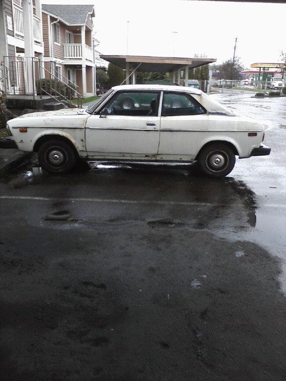

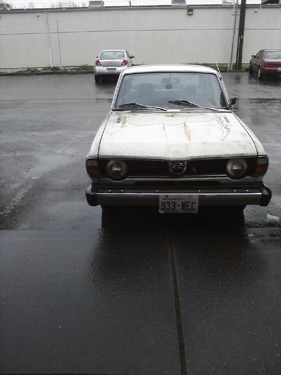

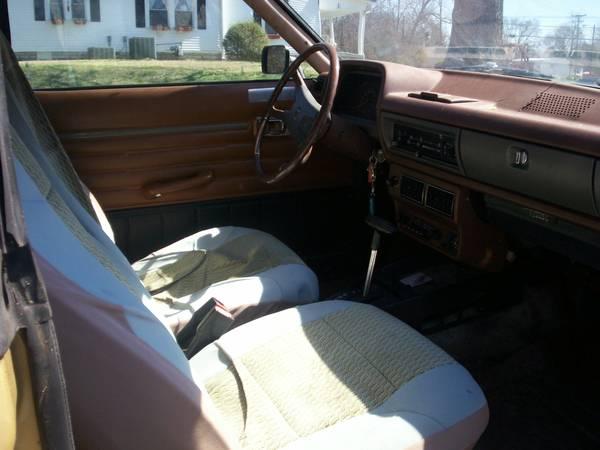

Saw one of these up in the PNW on craigslist. I am considering purchase and shipping it down here to Texas (I have some friends at Fort Lewis from when I used to be stationed there that can look at it and get it to me). It's a 1978 DL 2 door manual. There are signs of rust and body damage, but looks to be a decent shell if I plan on ripping everything out eventually anyways.
I would like to find one to eventually build up to this:
I would appreciate any advice on this. I understand it'll be expensive and costly, but figure finding one of these is hard enough, especially since these are almost impossible to find down here in Texas.
Thanks,
Ian

Hmmm... First thing I can see in the photos is the air vent/cowl panel is raised up. This suggests one of two things:
  • It could mean the bonnet hinges have broken away from the inner cowl area - Quite common on these models and not particularly difficult to fix, just needs some welding.
  • It could be caused by rust - This is a bigger issue, again very common and not at all simple to fix!
Just from the photos alone I suspect it may have severe rust in the cowl. This is a complicated section where three different panels all join up to make the spare-tyre-hold-down-tray (not really sure what to call it - the parts manual refers to this as the 'Duct Assembly') and the metal/panels under and behind the dash area. Rust here is what usually sends these models to scrap and once it starts it is amazing how fast it spreads!
If you go and check it out make sure you check right up under the dash (move the sound deadening if you have too - usually you can already see the water is leaking if there is any mould or discolouration).
Hopefully I am wrong and it is simply the bonnet hinges that have broken loose but make sure you check!
On a separate note the car on Craigslist is a two door sedan and will never really look like the hardtop in the Youtube clip you linked to or even a coupe as the roofline and side glass are tall like the 4 door sedans and wagons.
Sorry if this seems negative but it is best to be forewarned! Who knows you may be fully prepared for a welding project! Indeed, rust is not seen in the same light in Australia as it is in the US.

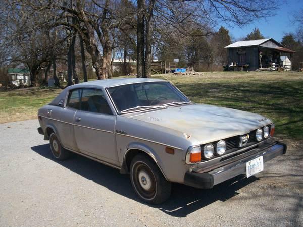

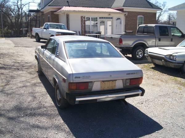

Well, found one on Craigslist that looks pretty promising. The only problem is that I don't have time to travel out there to look at it anytime soon. It does give me hope that I can find one eventually though, even if I can't get this one.
I would be interested in hearing others thoughts on a possible restomod. I understand that a restomod with modern components will be very expensive and everything will have to be custom. I am prepared to spend the amount to do a restomod and personally think the benefits outweigh the disadvantages. Though I may not have thought of every factor in the decision yet.

Yep that one certainly looks more promising! Looks to be less rusty than the first one you posted too (plus it is a hardtop!).
In terms of a 'restomod', anything is possible! it usually depends on time, effort and $$$$$! In other words plan/work out a budget and then double it! Can you do the work yourself? That will save some  of the expense.
Also, although you do not mention this, do you want it to be FWD or AWD? These models are not a simple conversion to AWD as the rear boot floor is really low (unlike the equivalent wagons or Brats) and it would be complicated to do (at least without a lift - which has been done).
Still, if I had the money I would do it too! A Subie restomod would be cool and not all that common.
