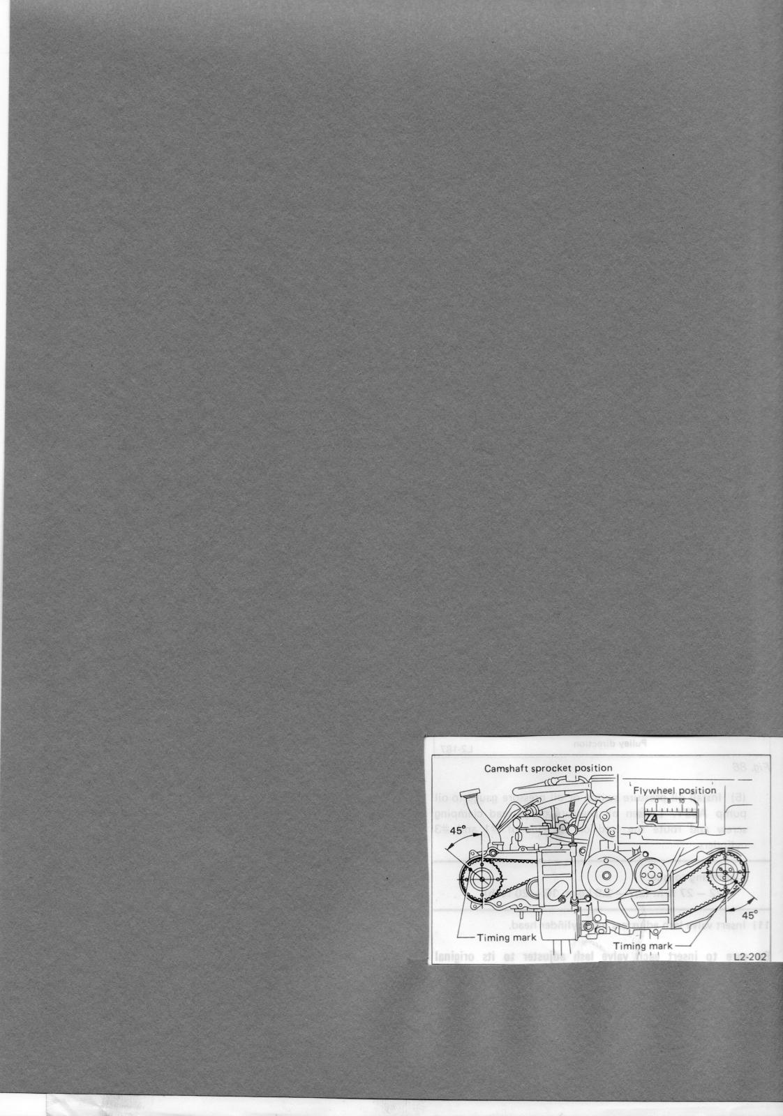

Here is a drawing of the front of an EA82. You can see the alternator/water pump 'V belts'. The outboard timing covers are removed and you can partially see the 'flat, cogged, timing belts'. You have 2........or you used to have 2 and or parts thereof. There are small rubber covers on the inspection holes. One can pry the covers out and peek inside to see if the belts are damaged. I think your belts are gone.
Print several copies of the image; one for looking, one for spilling beverages onto, three for getting dirty when you do your own belts.
There are several notations on the drawing; 45', timing mark, camshaft sprocket position and flywheel position. You will figure them out in a couple days. If your girlfriend has small hands, she may be able to help you and gain 'timing belt cover removal zen'. Vocabulary required.

#33 Malcontent
Malcontent
    New User
  • PipPip
  • 21 posts
  • Humboldt
Posted 02 April 2014 - 07:40 PM
You sir are a scholar and a gentleman. I thank you for your time and patience. 5 stars for you.
