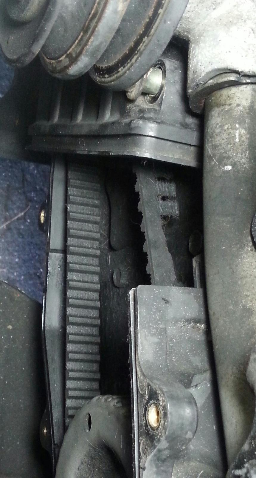

nichzimmerman Posted April 14, 2014 Author Share Posted April 14, 2014 Thanks for the help guys. I wish I could provide friendlier editing but I'm using a smartphone and it defaults to a single paragraph when I post. I did not have time to take the center cover of this morning but I took the left and right off. both belts were still attached but the driver side belt had damage. see the attached picture. could something like this cause the belt to jump a tooth and throw off the timing? These belts were replaced 40,000 miles ago does this mean I probably need to replace some of the gears? ive never worked with timing belts before. This is an SPF I engine and my Haynes manual says 17 to 24 psi is normal. mine was 24. the compression on the good cylinders was 165 and the Haynes manual suggested low compression on 2 cylinders of the same side is indicative of a head gasket leak and there's oil on the bottom side of those cylinders. that's all that went into my diagnosis. Thanks again for the help! Quote Link to comment Share on other sites More sharing options...

MilesFox Posted April 15, 2014 Share Posted April 15, 2014 YOu get spark and fuel pressure because the belt is still turning the distributor which sends the spark and fuel signal to the ecu, although since half your belt fell apart, i'm sure it is a few teeth off if not more, being out of time. Ineresting belt failure pics. I have only seen the snap cleanly, shear off some teeth while the belt is intact, or unravel into a 50 ft long ball of wire. Def. do the water pump while in there. avoud chan stores and stick to smething like napa and go with an aisin brand mfg'd new or napa's alltrom brand for oem supply (made in japan) Quote Link to comment Share on other sites More sharing options...

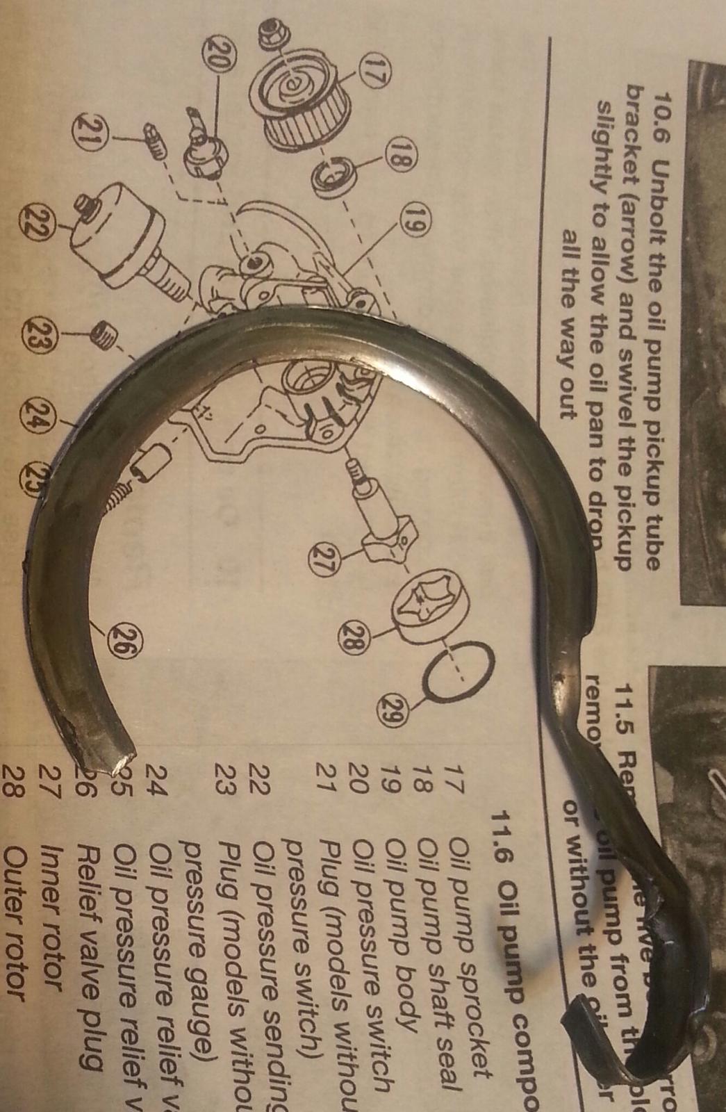

nichzimmerman Posted April 19, 2014 Author Share Posted April 19, 2014 Update: the driver side timing belt had bad wear on the side facing the engine and lots of belt fibers were inside the cover. I found that the oil pump sprocket (seee pic of part and diagram) had lost the inside ring which apparently keeps the belt on the sprocket. The ring had cracked, come off, got mangled up, then started eating away at the belt. Im relieved to figure out why my belt failed so soon, but I cant seem to find a replacement part anywhere online. Is this the sort of thing a dealer can get for me or where else can I look? Thanks. Quote Link to comment Share on other sites More sharing options...
ruparts Posted April 19, 2014 Share Posted April 19, 2014 hi, that guide ring is pressed onto the drive gear, it is not available as a replacement part. the oil pump has one on both sides of the gear if i remember correctly. you should be able to replace the drive gear with one from another pump if you can locate one. i would suggest you replace all the timing tensioners and idler because it seems like your belt had been rubbing this shoulder ring which indicates that something is misalligned and causing the belt to run toward that side. anyway a new timing set and drive gear for the pump should get you going. check the bolt hole for the idler gear sometimes that hole is wallowed and lets the idler tilt and shift the belt, tensioners wear and tilt slightly, same issue belt runs offline. Quote Link to comment Share on other sites More sharing options...
