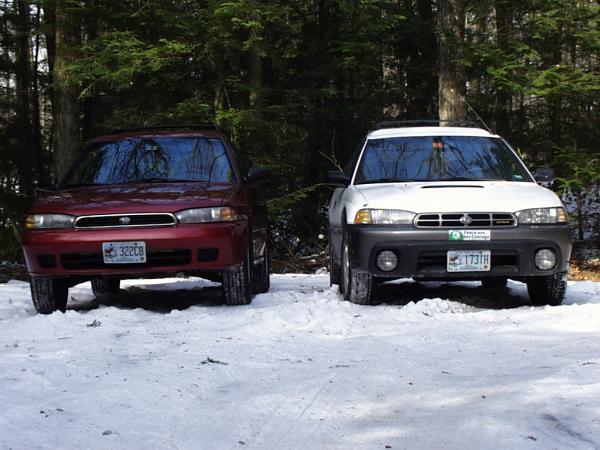

If you buy new KYB's for a 98 outback, you can re-use your Legacy springs. That's what the red one in my picture has, and you can obviously see it's not sitting lower than the outback next to it.
