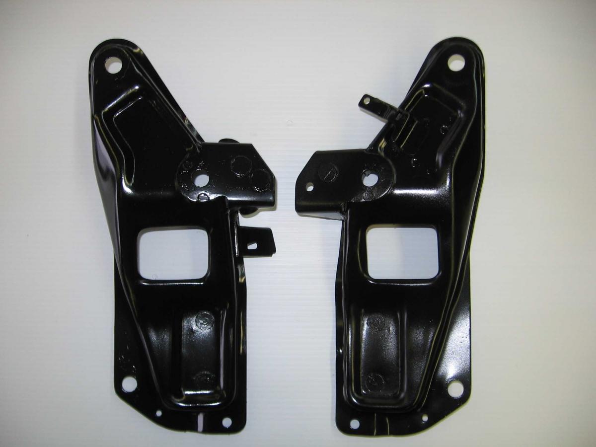

One small detail that is easy to overlook is the radius arm mounting plates. The auto trans plates on your car don't have the attachment point for the manual trans cross-member. You'll need to grab a set of these from the donor car too.
Attached File  EA81 Radius Arm Plates Manual Trans.jpg   73.33K   10 downloads
The swap is well worth it IMO.
