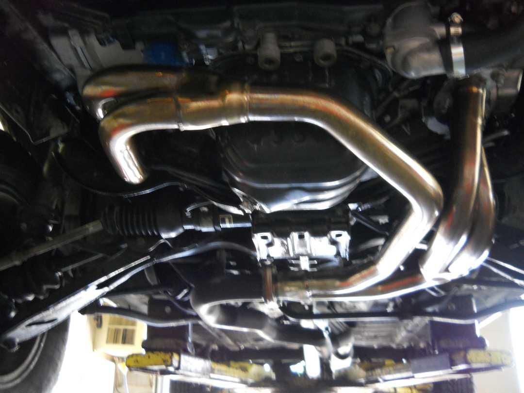

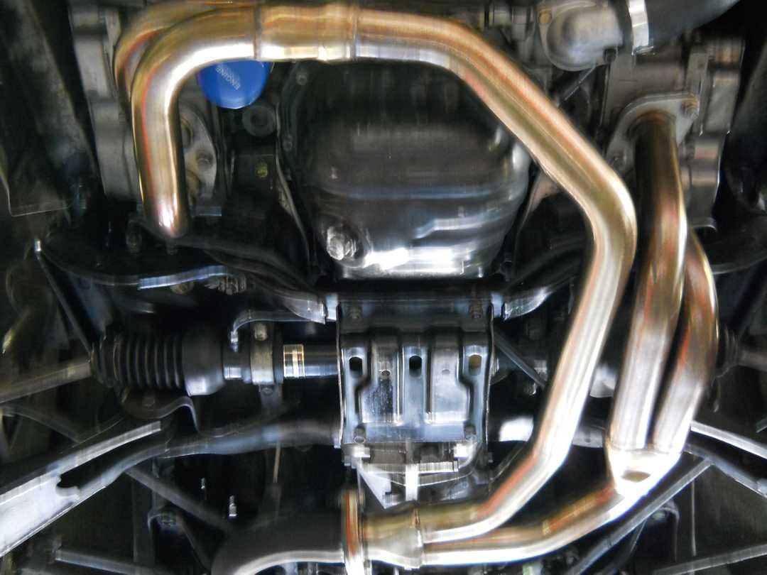

I cut the flexible sections off of EJ pump's lines leaving only the metal sections at the pump. I silver soldered some old brass fittings on to those EJ lines.  Standard EA PS lines bolt right up now. Future repairs will just take stock EA P/S lines from now on. I have several thousand miles on this setup and it works great. I will be happy to snap a quick picture if you keep hounding me about it :) This is on my 1983 GL FT/4WD Wagon with an EJ22 and power steering. All the hard and soft lines after the pump are stock EA. The lines at the cross-member are a little tight but it fits like a glove.
Attached File  EJ22 under front -1.jpg   81.28K   63 downloads Attached File  EJ22 under front -2.jpg   91.06K   63 downloads
You can sort of see some of it in these pics. I'll snap a quick picture of the modified lines up top this weekend if I get time.
