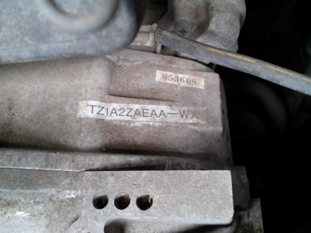

This is a 4EAT Phase 2 trans code right?

maybe you're hearing heat shields or another noise, or the tranny's fluid level is off or ???
anyway - I looked around briefly and the number on the pic you posted is typical 4EAT number for Imprezas around 1999 +/- it seems.
