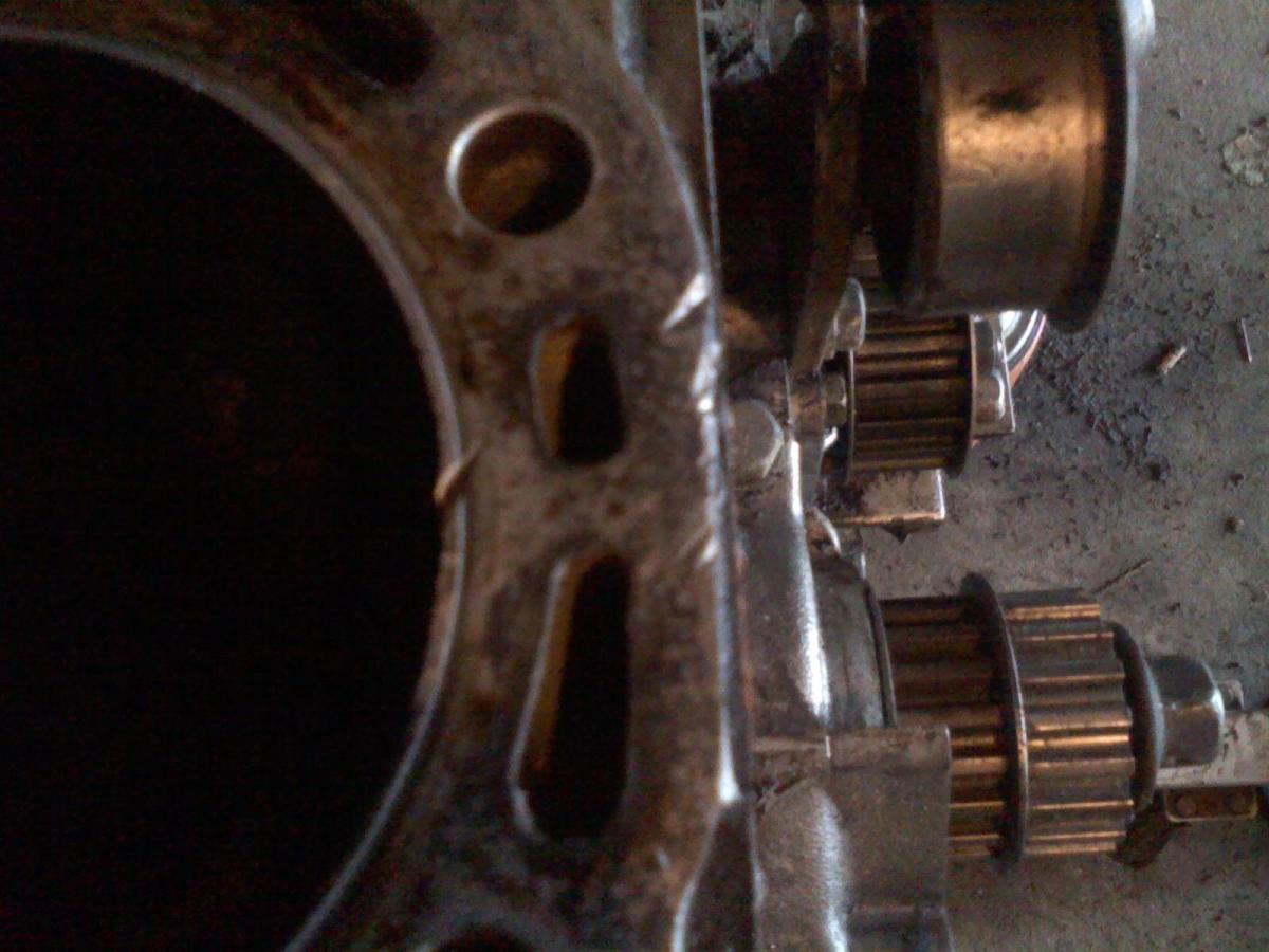

So I bought a engine (short block) has damage to one cylinders has a nick at the top of the piston lip thinking of having it decked but it will be ~.060
too much?

Pic

Would like to hear others reply to this one.  My inexperienced view is that as its on the outside some Devcon would suffice (Plastic welder adhesive). Saving that decking.

If it wasn't into the cylinder liner it wouldn't be that bad. Clean up the very end of the cylinder with a half round file wrapped in 300 grit sandpaper.
Wire brush the heck out of the top of the block with lacquer thinner & then JB Weld epoxy the dents. Gently flat file the excess.
Check the deck with a ground straight edge & feeler gauge to make sure its flat.

I also thought about weld and then file it out sand and hone

i almost feel like jb might be better for squareness I.E. effort in  squaring it up after all that heat. i got some jb out there, ill get a move on after my back quits grinding

If it can be decked that much I've got a guy to do it and if the side effect is more hp what the hell its like 60$

 hi, i want to say that if you shave the deck, you should do both halves to make the engine "equal" on compression side to side,, but most i want to say i saw some head spacer plates for the subaru, i think it was rock auto, basically  they look like a head gasket but solid, .020 if my memory is right,  and were not expensive.. if you can locate those the deck height dimention can get back close.  ( confirmed, rock auto  > subaru >1987 >gl >1.8sohc > engine > cylinder head shim ,, 6 available.) if you deck it might want these.
 i agree the clean and fill aproach others mentioned is worth a try, the head gasket will do the rest , FEL-PRO perma-torque.  that part on the cylinder  liner edge is the main thing.

.016 is the Factory spec on the limit to how much can be taken from the surface.
.060 is way too much.
Get a different block....they are easy to find.  Sorry Subruise if you are trying to sell that it's toast.......parts block or experiment

The cylinder liner does not reacht the top of the block......it's cast into place not pressed.
There is a "cap" of aluminium over the top of the iron sleeve about 1/8" thick.....
One of the reasons you can't deck them far......that cap gets thinner and becomes a little ribbon of aluminium that soaks with heat and can melt or deform at that point.

+1 on .060 being too much. On top of what G said, it'll move the mounting points for the intake inboard making it very difficult if not impossible to get the intake bolts in. NEVER weld the head surface on an aluminum block unless you have a very experienced welder and a good machine shop. The heat alone can cause cylinder and block warpage you can't fix properly. The block has to be pre-heated, welded, controlled cooled and then checked for squareness and line checked through the cam and crank bores. Pretty sure the cost would be more than $250. If you don't have the money for a block, JB weld the pits as suggested, level everything with 300 grit wet/dry sand paper and a block of wood. Put your heads on and add 5ftlbs to the required torque. JB is tough stuff. It'll hold.
