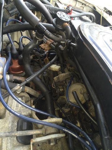

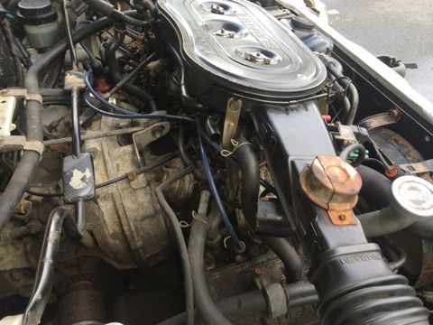

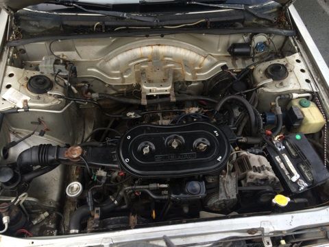

Haight...Check the throttle cable....make sure it's not too tight.......then check the choke.......see if it's staying hung on  the high idle cam/not opening.
If that isn't it.......check for vac leaks around the base of carb and intake w/ starting fluid.  Also......the hitachis can be picky if the Air Bleed hoses are removed or capped......they need to be on there, but restricted a bit with orifice factory setup........Can you post pics of your engine bay????
If all that checks out it's time to open the carb.

#15 Haight
Haight
    USMB Regular
  • 281 posts
  • Seaside, OR
Posted 27 April 2014 - 12:48 PM

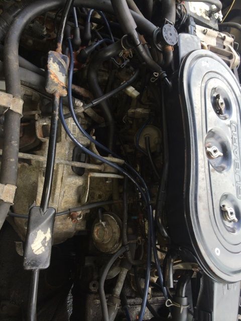

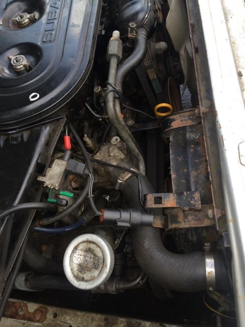

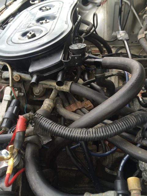

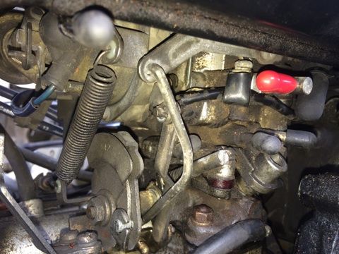

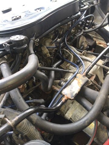

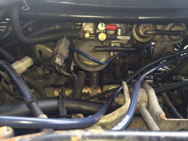

No worries haha. Here are those pics Gloyale. Let me know if you need more specific pics.
