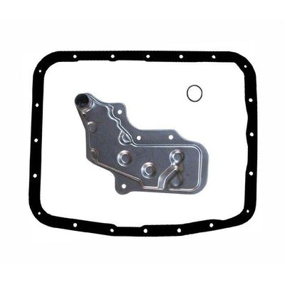

So this "Automatic Transmission Filter" is what some call a "pickup screen"?
http://contentinfo.a.../TF222/image/4/
They dont really get dirty so they dont need replaced? All of the ATF goes threw that screen right? So the majority believe the Auto Trans Filter/Pickup Screen is not worth replacing?
So a '93 Legacy Auto Trans (4EAT) doesn't have any other filters besides "Pickup Screen" & the external option from Subaru? I have read that adding a extra filter to a 4EAT is a good option to help operation & longevity. Would a in-line filter be usable or would it restrict flow too much? What about adding extra magnets inside the pan? How do you all feel about using additives in the tranny, Any specific brand that you stand by? Because wanted to use a cleaner before the fluid change & a additive with the new ATF.

IMO, adding any extra tranny filter is not worth the effort, unless you plan on pulling a trailer over hills and mountains. Under normal driving, the 4EAT tranny does not over heat and require anything special. I don't recommend any additives, ordinary ATF is all you need.

The filter screen is a single flat plastic mesh.
