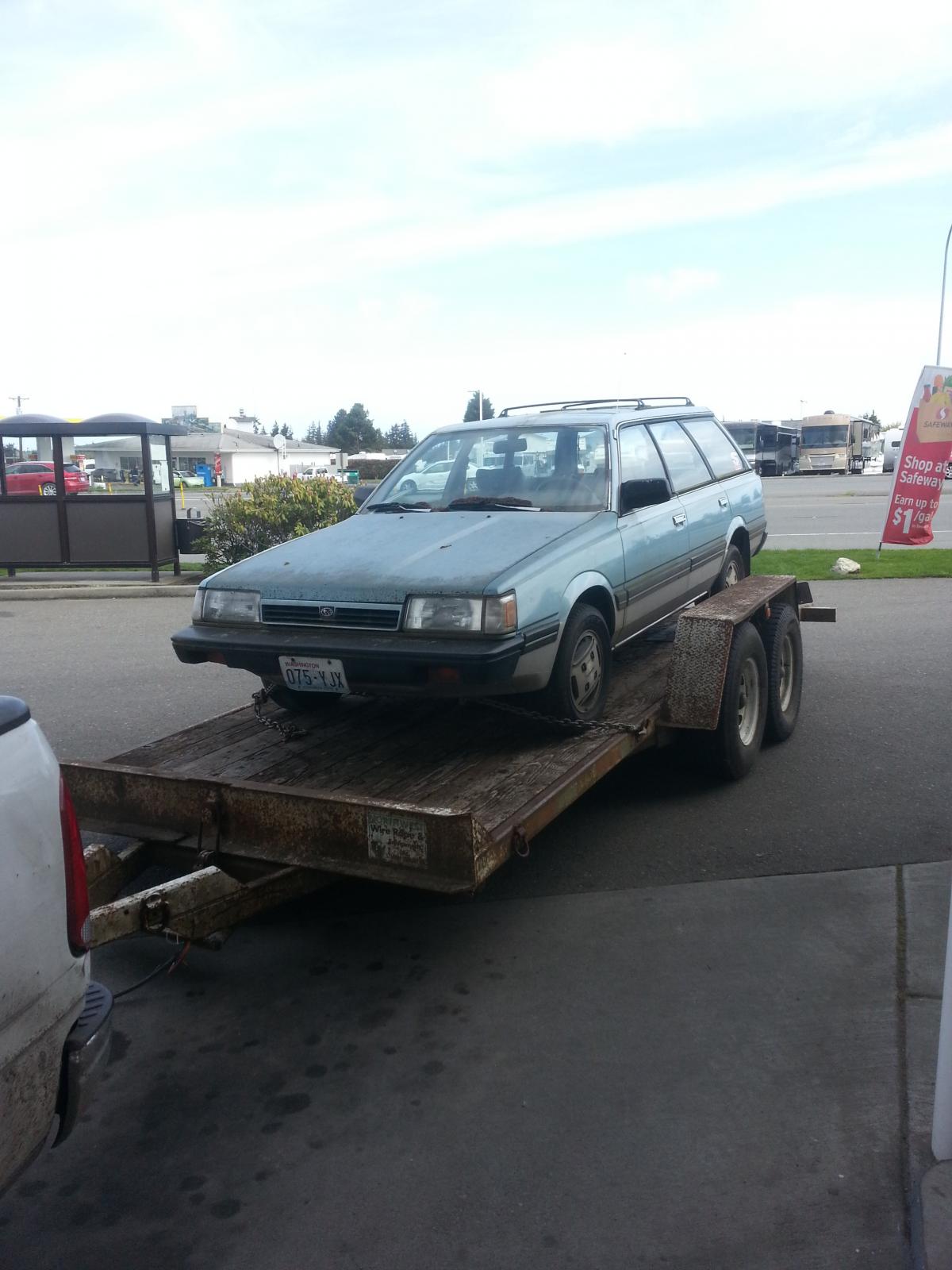

I cant cure my addiction. I recently added another roo to my family. I now have three in my driveway. I got this little turd for basically free, I traded a camper trailer frame for it! After a sketchy five hour trip we made it home!   Attached File  trailer.jpg   151.31K   42 downloads
At some point in the poor cars life some tweakers stole it. The ignition switch was torn apart and the radio was gone. When the PO got it back it just sat in his yard for two years. Over that time the fuel pump seized, maybe it was from the ethanol degrading. No start. Through a new battery in it. It wanted to live so bad. So i listened for the fuel pump. Nothing. So i threw in another pump i had. Nothing. Wtf i know i have power! so i whacked it with a wrench, and it turned on! The car choked to life with a low rumble and black smoke on old gas. It had maybe been half an hour since i got home. I sputtered down to the gas station and put some fresh gas in it. the car sounded awesome. Later i found that it was only stock exhaust but the bottom of the muffler was gone. When i got home i decided to whack the old fuel pump just for fun. Sure enough it worked, Score!

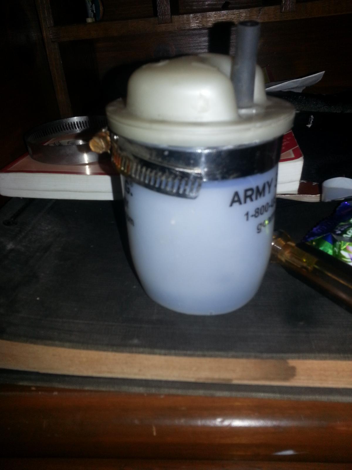

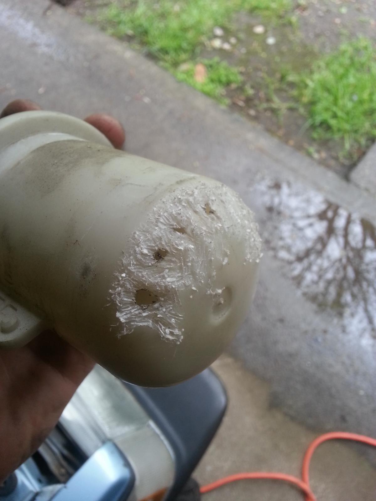

Found out why the heater settings didnt work.
Attached File  mice.jpg   128.15K   44 downloads

Damn mice! Ive heard of them chewing wires but this is weird. Fixed!
Attached File  fix.jpg   116.2K   37 downloads

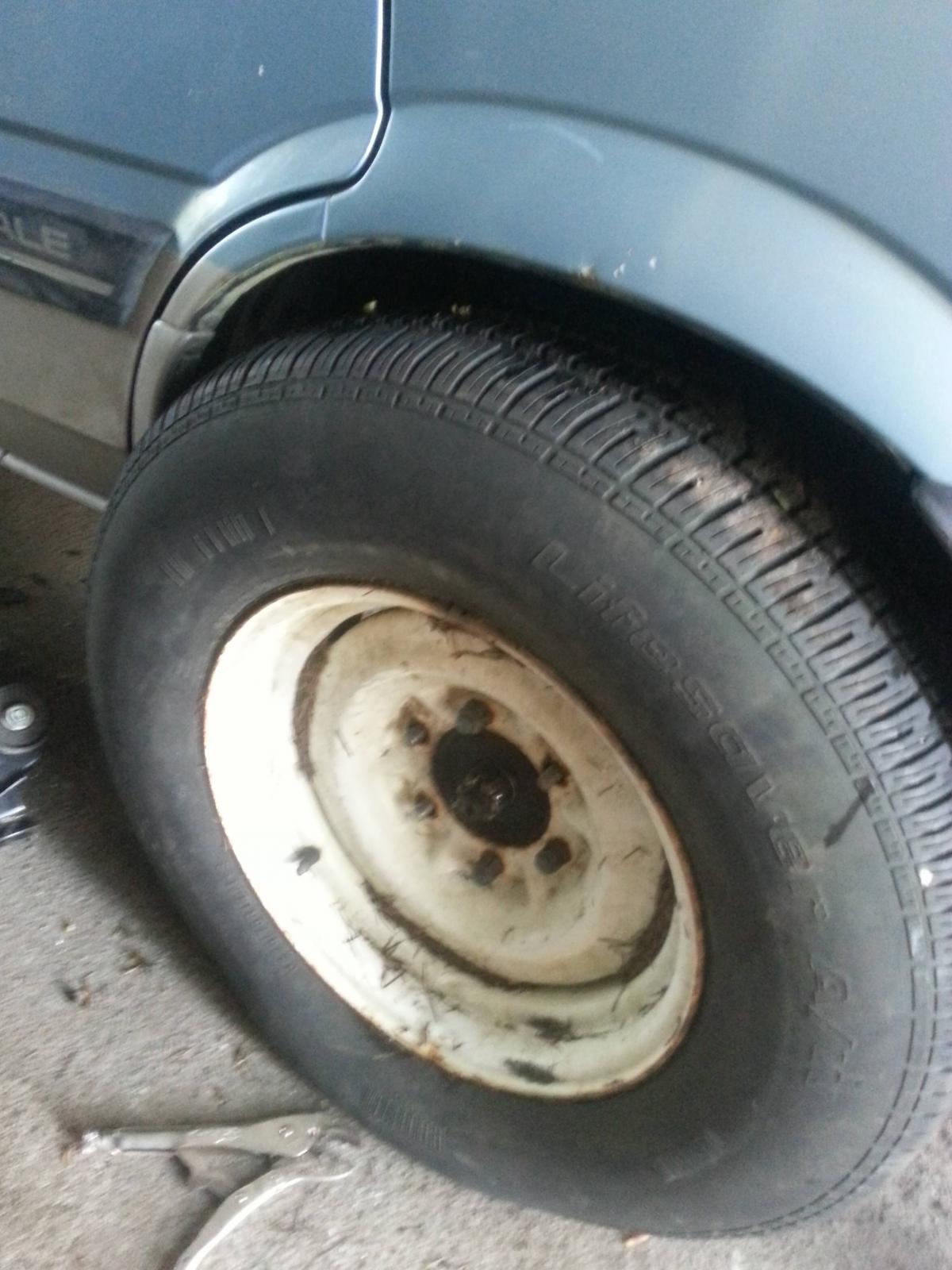

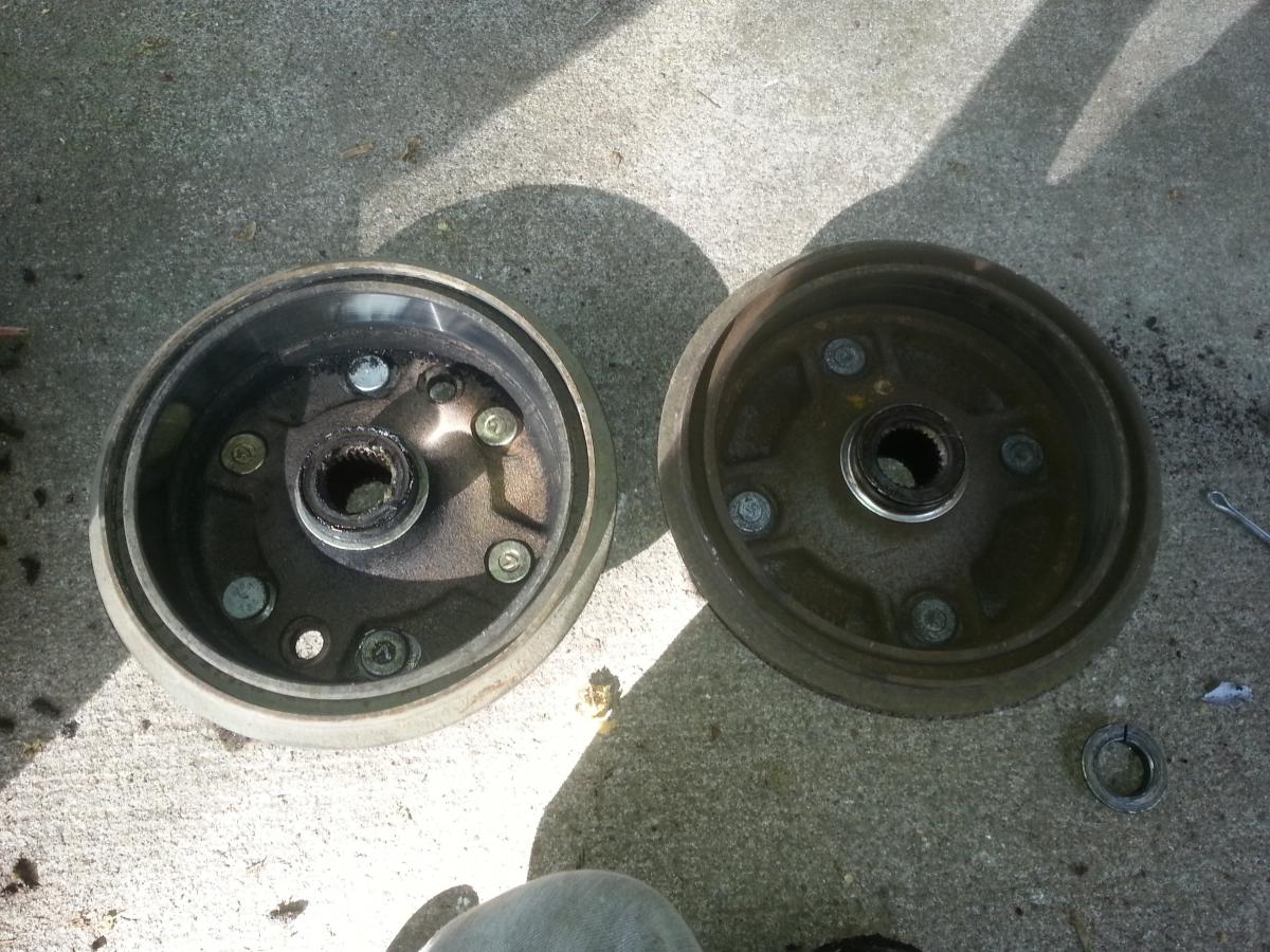

Earlier this winter i wrecked my beloved 84 gl wagon Oliver. Some day Ill fix him. But for now i borrowed its 6 lug hubs and drums. I had no problems mounting them on the ea82. I did have to reset one drum self adjuster but the other slid on fine. I measured and compared them side by side and they seemed identical.
Attached File  image.jpg   180.08K   34 downloads
Attached File  Them.jpg   295.56K   38 downloads

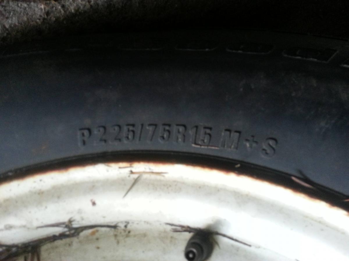

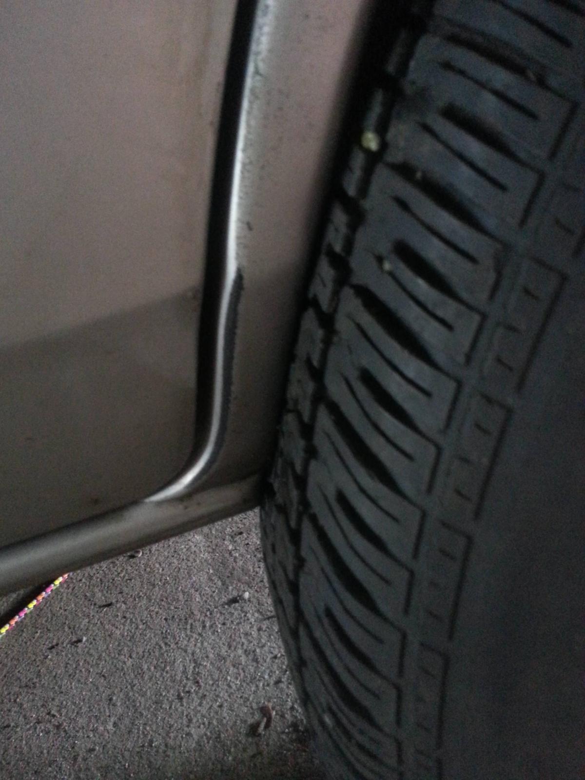

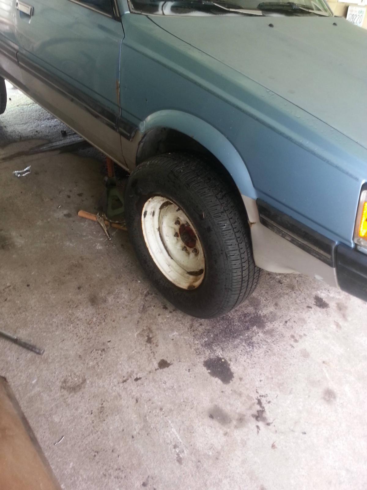

Until i order my 4'' lift i decided to make it Rwd. Who cares if i blow up the push button anyway. I need to hunt for a cheap duel range.  Here are some wide 27'' tires stuffed under with no lift. Its not even drivable like this they rub soooooo bad. I put some cool smaller tires on for sliding around.
Attached File  damn.jpg   216.39K   27 downloads
Attached File  sqush.jpg   177.63K   34 downloads
Attached File  snug.jpg   182.35K   33 downloads
Attached File  size.jpg   65.17K   28 downloads
Attached File  front.jpg   172.05K   22 downloads

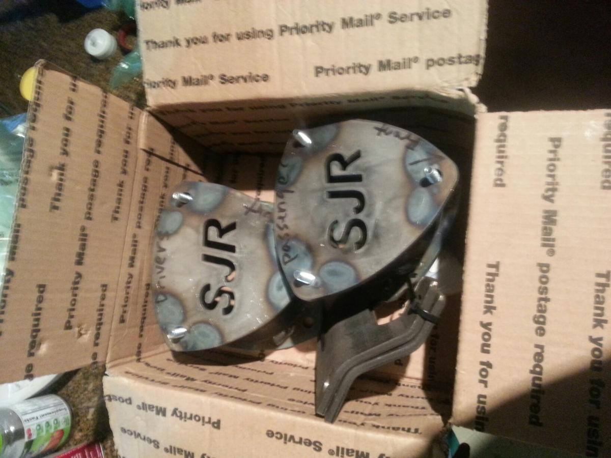

Just ordered some lift pieces from SJR. I only ordered the strut pieces as i can build the rest.

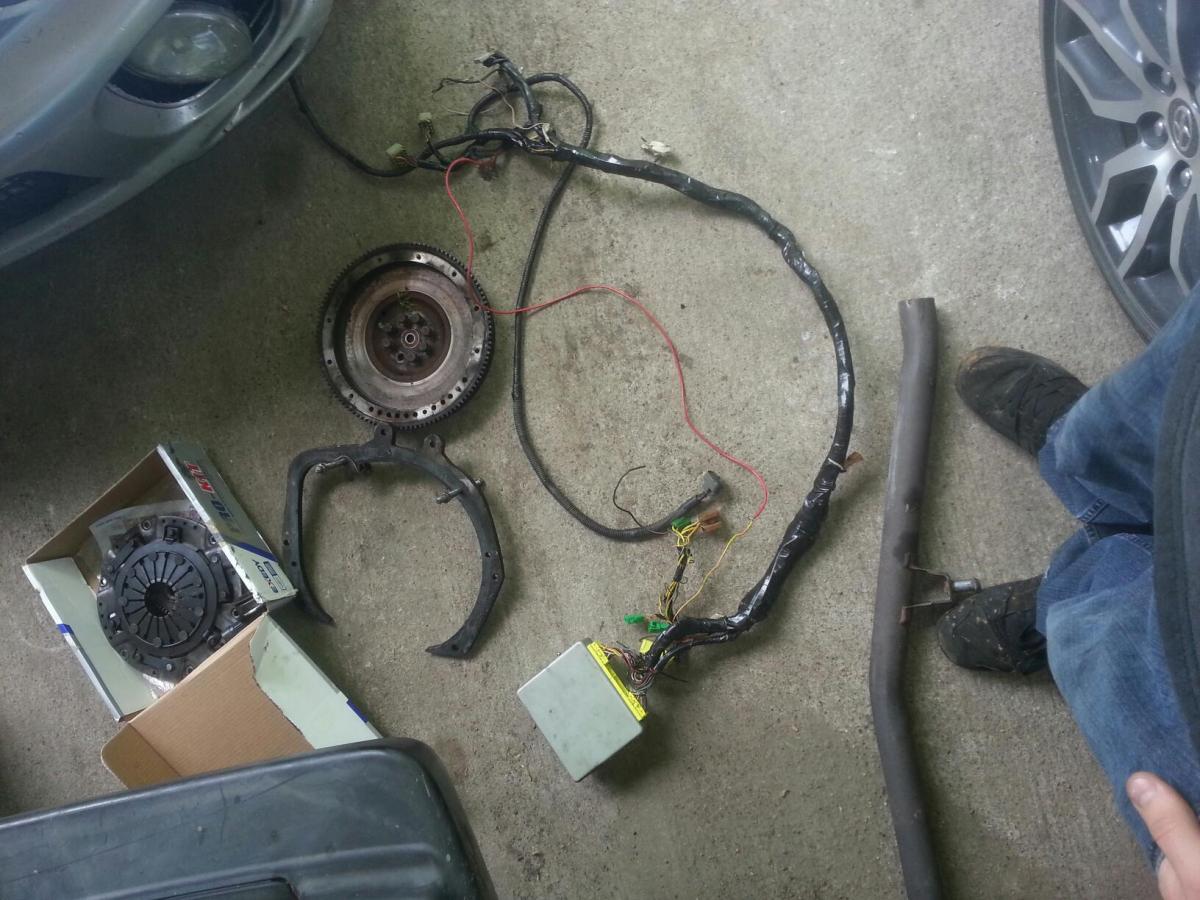

Engine Prepped.
Was this supposed to connect to something? Was held on with two bolt and not doing anything.
Transmission Freedom!

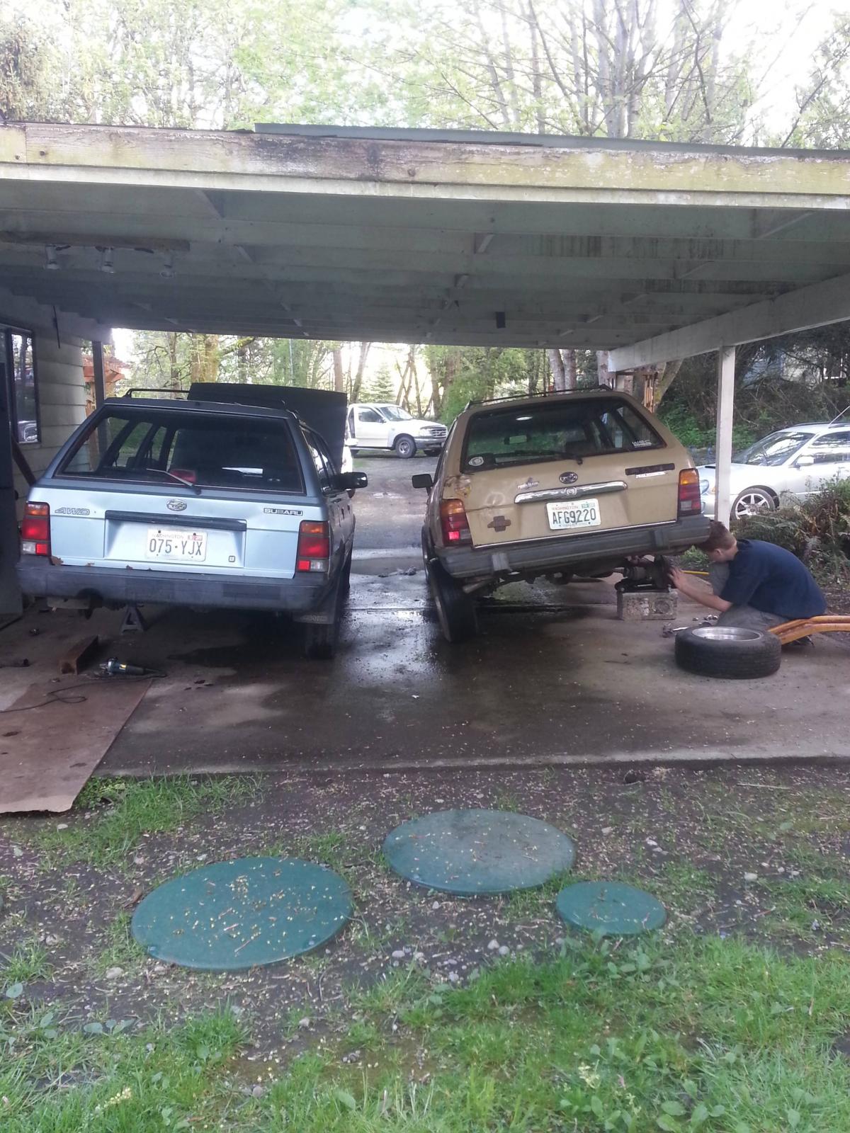

Engine out! Jusd used a old fense tentioner and a beam in my car port. I cant belive how light these engines are.

I also started to install my lift kit. I bought a 4'' lift from sjr. No offense scott but i'm kinda upset with the quality. On the front strut spacers the bolts are only tacked on, not fully welded. And the back brackets are different lengths.. They will work i just wish they were done better for the price. I decided i could build the rest of the kit myself. I bought 5 ft of 1/4 3'' by 2'' square tubing for 30$ from ziglers welding. Cut, Drilled, and Painted by a friend.
