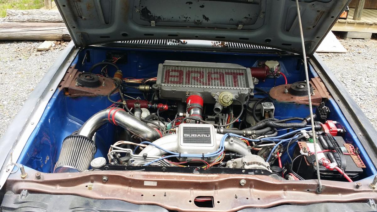

I don' know what the mpfi manifold for an ea82 looks like but that is not an ea82 turbo intake manifold. Also, what did they do with the disty?

its a manifold from an XT series car. and it looks like electro ignition like MSD or something.. ive seen the MSD swap with the disty hole just covered before

yes it has stand alone msd coils to fire the engine and powered by megasquirt and a trigger hall sensor.

SO COOL!!!! At first i was a little worried but seeing that spider intake and TMIC it looks really good in there. I really like the modified strut towers looks like a simple way to do it that wide body isn't to shabby either

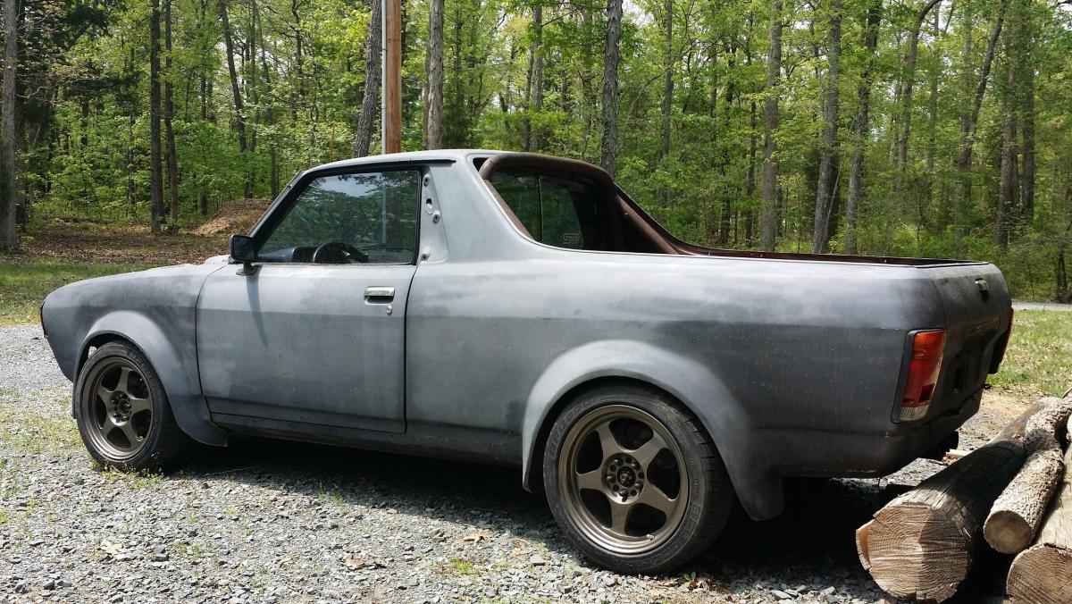

I wonder if Loyale lower control arms have been fitted. No reason for the wheels to be that far out to fill the flares (apart from looks). Spacers put on the rear to compensate
