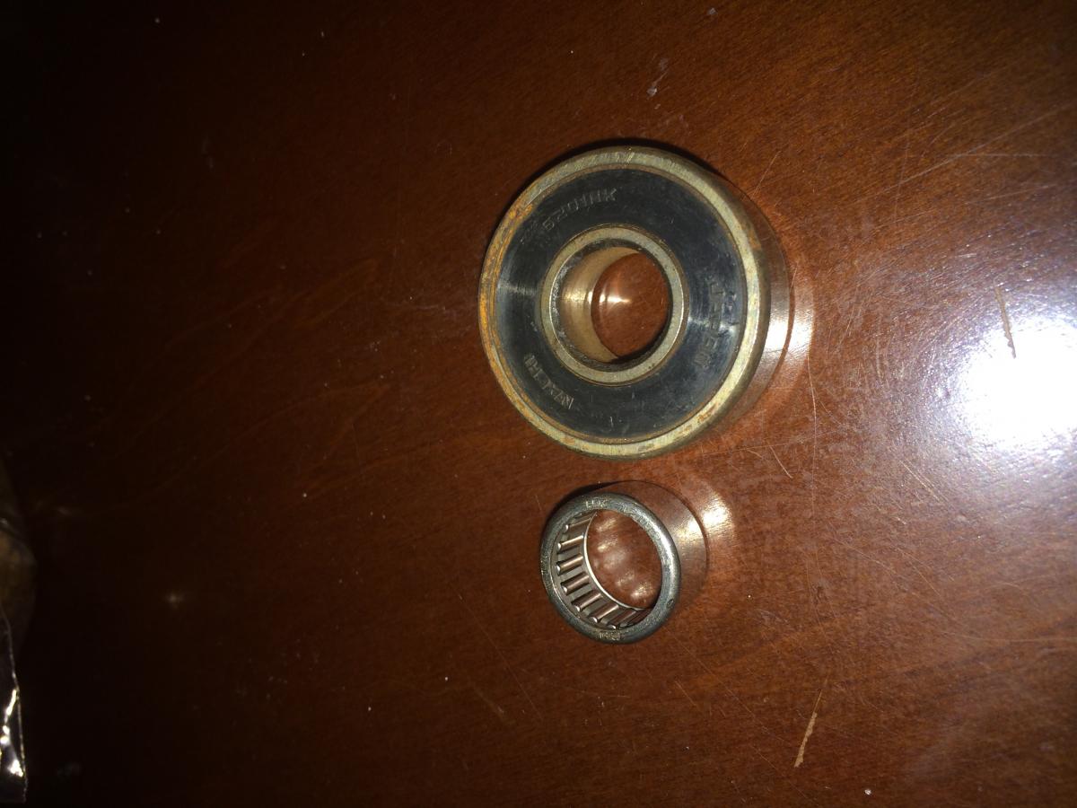

Gwywnc Posted June 10, 2014 Share Posted June 10, 2014 I got a clutch kit and all went ok but I'm not sure were this "spline" bearing goes. Can someone help me? It's for a subaru gl 1984 thanks Quote Link to comment Share on other sites More sharing options...
Gwywnc Posted June 10, 2014 Author Share Posted June 10, 2014 And the bearing that is sealed goes in the flywheel it's the small one I'm not sure about Quote Link to comment Share on other sites More sharing options...
bratsrus1 Posted June 10, 2014 Share Posted June 10, 2014 Hi This is Jerry, the top bearing is the pilot bearing that gose in the flywheel. The other bearing is a thorrington bearing but it's not for the clutch. Thanks Jerry Quote Link to comment Share on other sites More sharing options...
ivans imports Posted June 10, 2014 Share Posted June 10, 2014 The small one is ea71 they give both in the kitt do not use. But save for that ea71 brat you will find one day helped me out when I installed my ea71 in my 80 Brat last week. Had saved the bearing for 8 years before I needed it But I had it ! 1 Quote Link to comment Share on other sites More sharing options...
Gwywnc Posted June 10, 2014 Author Share Posted June 10, 2014 Thanks guys! I was stuck thinking "I don't remember seeing this one!" Lol Quote Link to comment Share on other sites More sharing options...
