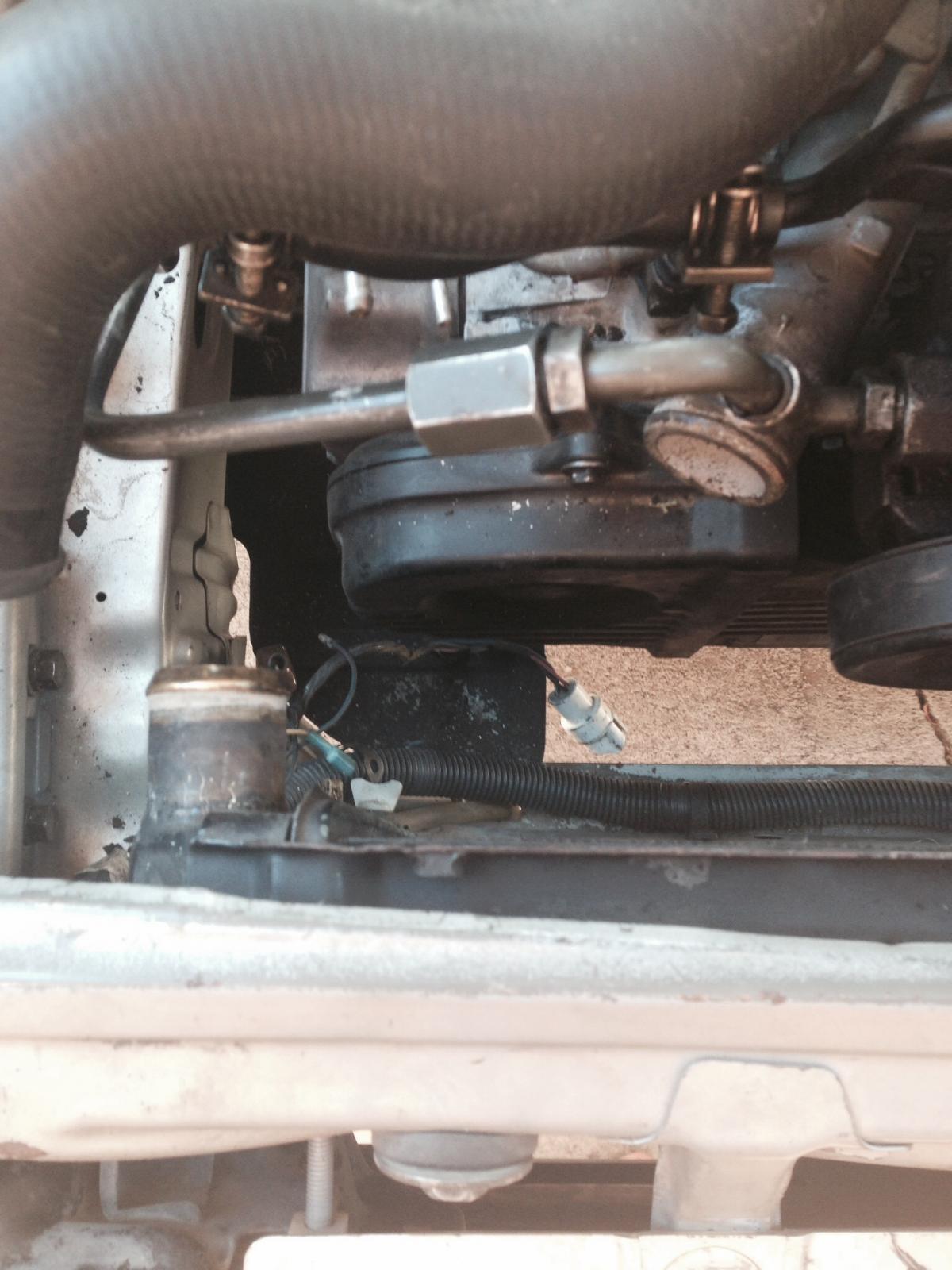

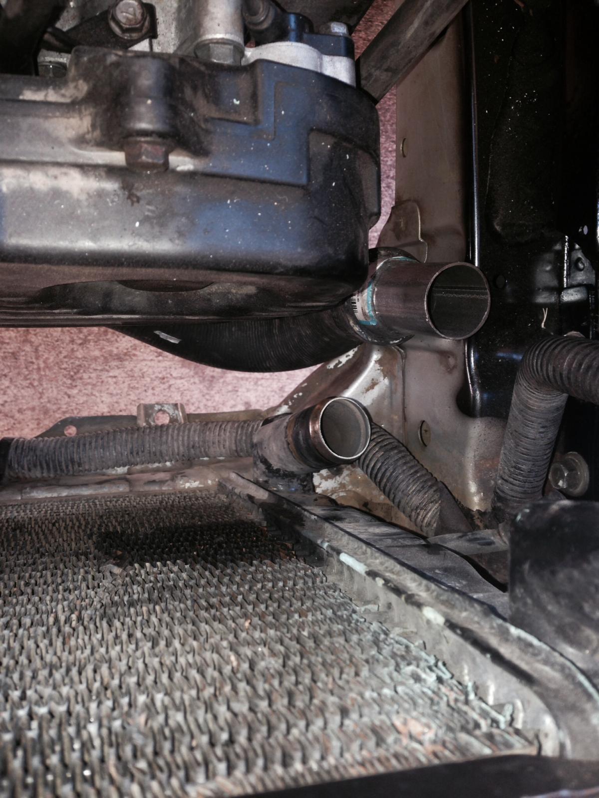

Suba_GL_87 Posted July 14, 2014 Share Posted July 14, 2014 I did already swap ej22 egine into GL. But I have gl radiator but need to know what shape to look like upper and lower hose fix to ej22 Thanks. Quote Link to comment Share on other sites More sharing options...
idosubaru Posted July 14, 2014 Share Posted July 14, 2014 if one outlet/inlet is smaller you can cut a section of the smaller hose and use it as an adapter for the larger hose. Quote Link to comment Share on other sites More sharing options...
Suba_GL_87 Posted July 17, 2014 Author Share Posted July 17, 2014 (edited) Like to photo... Just like to get idea. Thanks Edited July 17, 2014 by Suba_GL_87 Quote Link to comment Share on other sites More sharing options...
Suba_GL_87 Posted July 17, 2014 Author Share Posted July 17, 2014 That's all I've been find it out... Which right to correctly. Thanks Quote Link to comment Share on other sites More sharing options...
Suba_GL_87 Posted July 19, 2014 Author Share Posted July 19, 2014 Can use flex hose? Quote Link to comment Share on other sites More sharing options...
Scooner Posted July 19, 2014 Share Posted July 19, 2014 I used a flex hose with built in spring for the bottom hose and it's worked great so far, i got it from advance auto. Quote Link to comment Share on other sites More sharing options...
Suba_GL_87 Posted July 19, 2014 Author Share Posted July 19, 2014 How about top hose? Quote Link to comment Share on other sites More sharing options...
Scooner Posted July 21, 2014 Share Posted July 21, 2014 You can use the same thing, just a shorter one. Quote Link to comment Share on other sites More sharing options...
