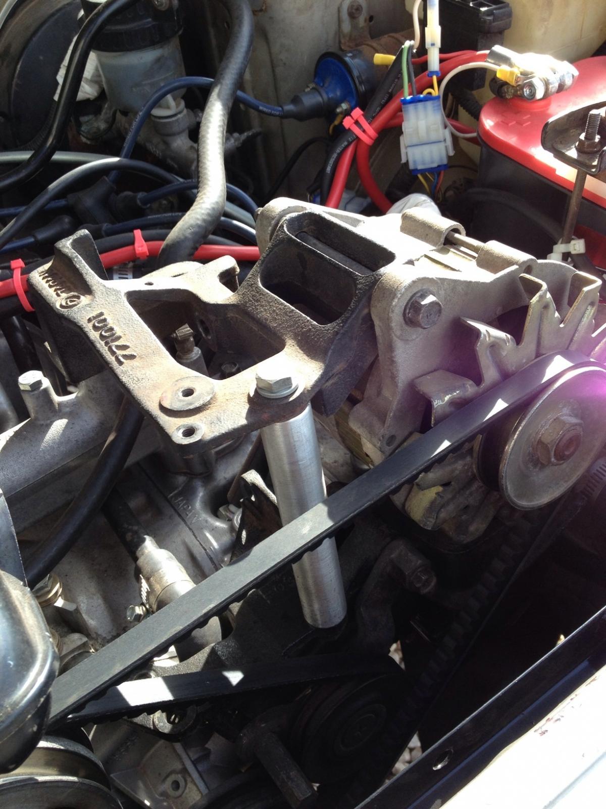

My '87 is not a turbo, but the bracket is the same. I yanked the AC compressor, took a length of 1" aluminum rod stock and cut it to length to fit where the compressor was, drilled and tapped it 3/8-16 on both ends, and bolted it in as a support pillar where the compressor used to be. You could also use a piece of pipe cut to length and a LOOONGGG 3/8" bolt and nut.
You will need a different length inner V-Belt if the compressor pulley is gone, I used a NAPA Premium XL belt, size 9345. The longer outer belt that runs the alternator doesn't need to be changed, only tensioned tighter.
