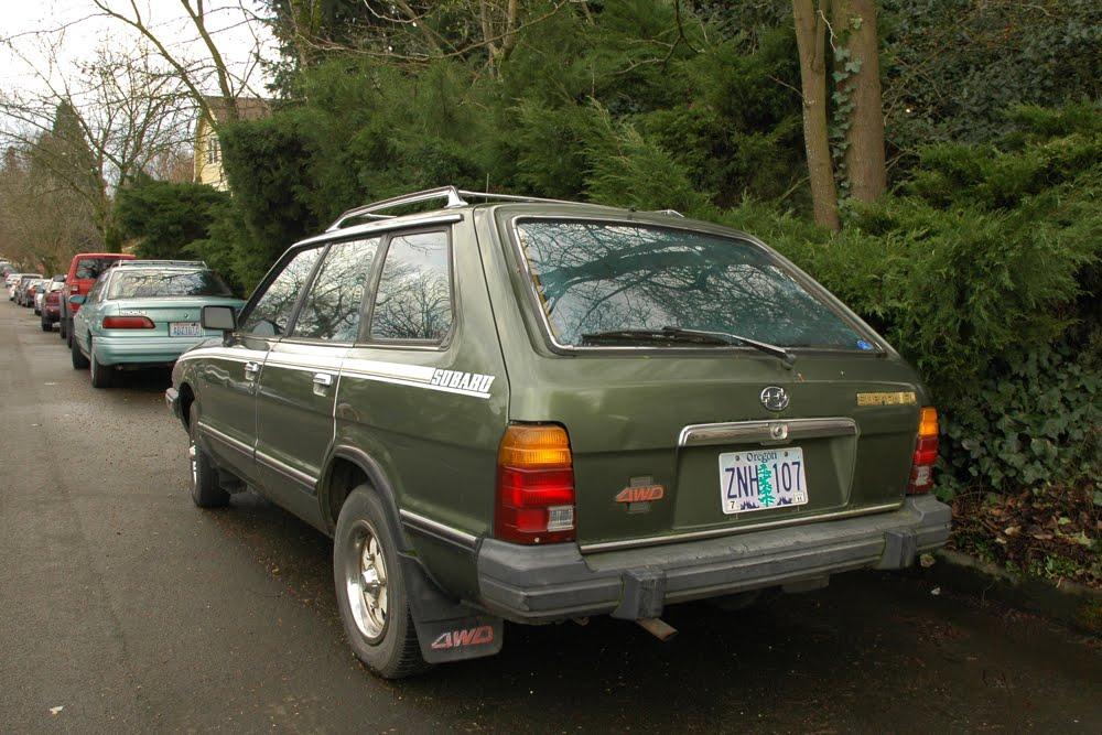

Subruise Posted August 2, 2014 Share Posted August 2, 2014 that is a beautiful wagon! 2 Quote Link to comment Share on other sites More sharing options...
OTTO69 Posted August 2, 2014 Author Share Posted August 2, 2014 THANK YOU! Quote Link to comment Share on other sites More sharing options...
