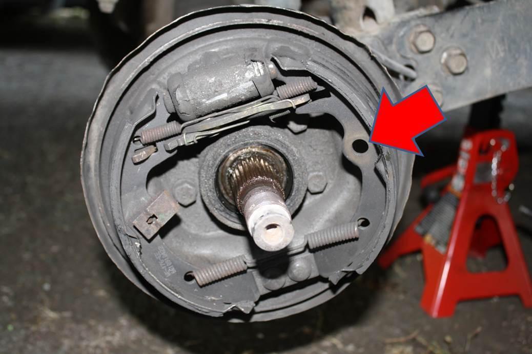

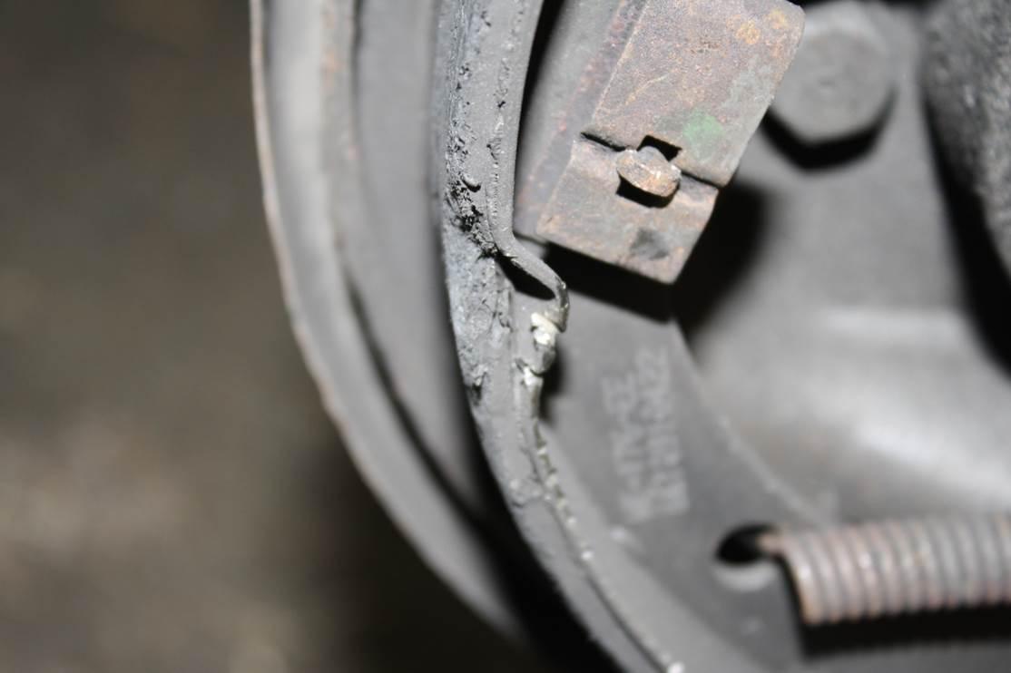

Thanks everyone for the input. PROBLEM FOUND! After fighting to get the drum off, I can see the thing that holds the brake shoe in place fell apart causing the shoe to pop out laterally into the side of the drum.
Attached File  brokenbrake1.jpg   77.94K   14 downloads
Attached File  shoepoppedout.jpg   93.6K   18 downloads

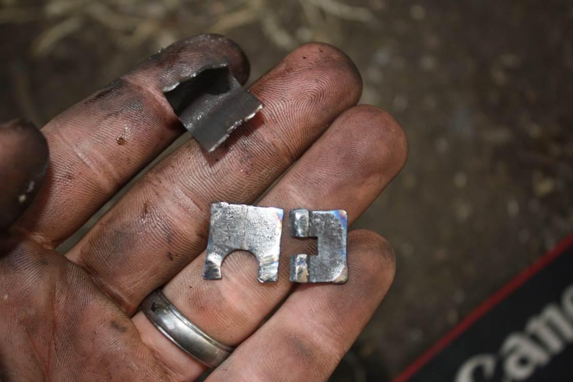

Here are the rogue broken pieces...Attached File  brokenbrakepieces.jpg   75.16K   15 downloads
And well crap...cuz they successfully damaged essentially every other component of the brakes

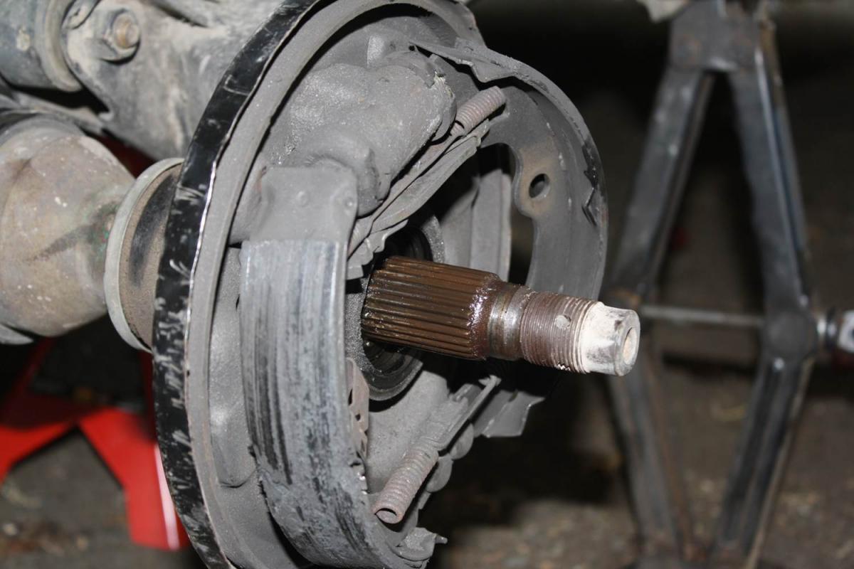

Here you can see both boots on the cylinder got sliced up and if you look hard you can see a gouge in the brake cylinder itself...
Attached File  chippedcylinder.jpg   73.81K   15 downloads
Here you can see the shoe got a nice chip in it...(less than 2K on these shoes too)
Attached File  chippedshoe.jpg   48.28K   15 downloads
I don't have a picture of it, but the drum itself also got a nice gouge in it from the shoe pressing out into it.
