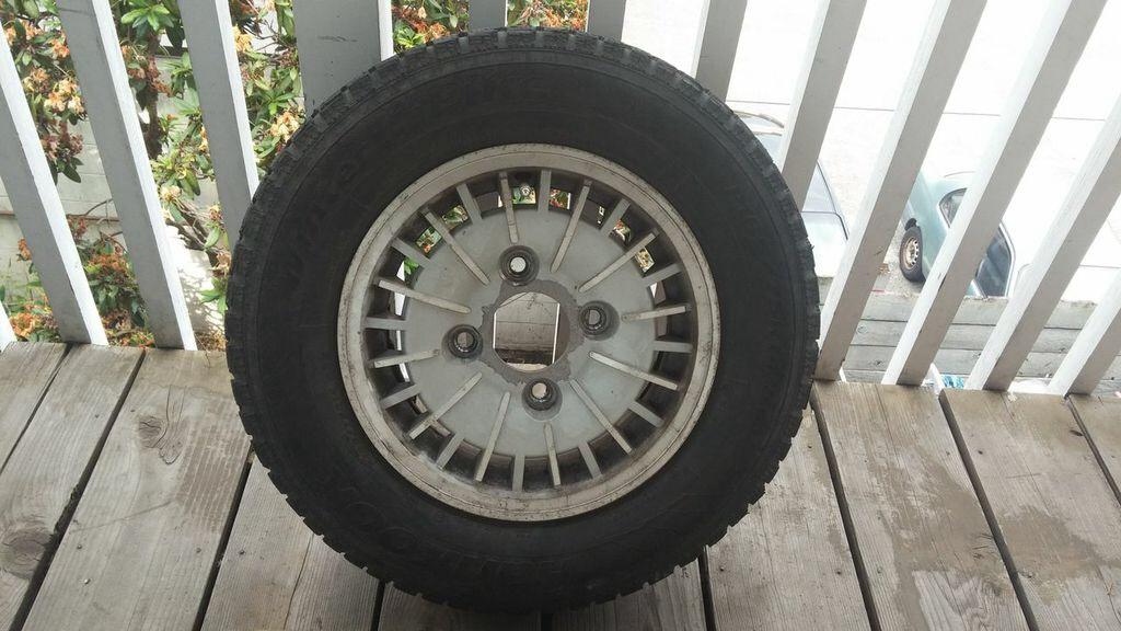

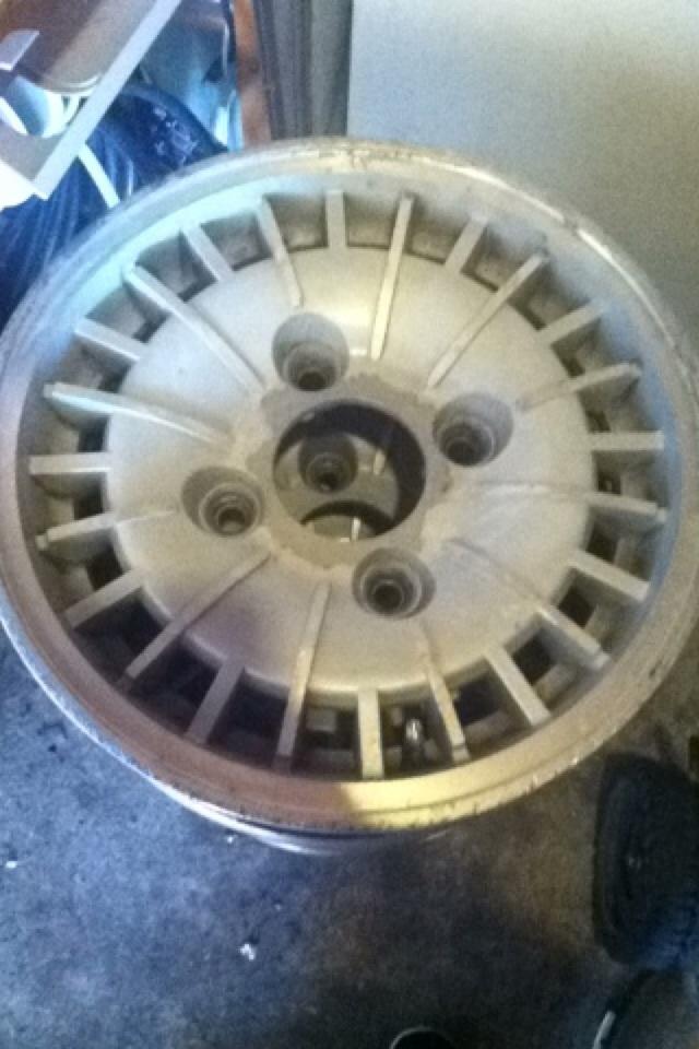

So what kind of tires can I mount my 14" pug alloys on that are bigger then stock? Going to get a 2" lift so I wanna know what kinds of tires are out there as in mud or all terrain. Thanks.

Yes the 88. And just the lift for now no other suspension mod. And the members profile name is Prwa101. He's building a lift kit for me. And the pugs are 14x6.

You make sure these aren't the 390mm wheels? Because they made wheels both in metric and American. I saw a peugeot sedan off of Orient drive this weekend thinking i might score a set of 15 inch alloys because the car has sat since 96. Once i saw it had the 390's i left because im not going to pay 1500-2000 for a set of metric tires.

How can you tell? Each one of the rims say 6j 14 on them.
