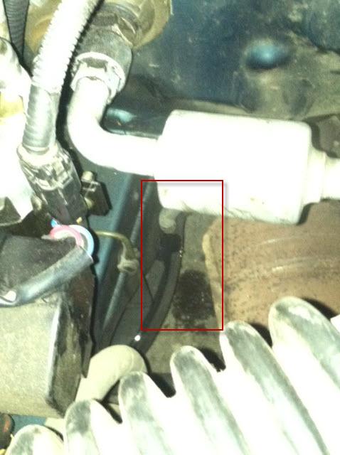

I'm trying to ID what part is leaking on my 92 Legacy Wagon. I recently replaced a bad A/C compressor unit and noticed liquid under the car (maybe 12oz or so). I started the engine and traced the leak to the front left of the engine near the outer passenger CV boot area. I have not seen the leak again and the day it appeared, the heat was about 99F and the car was running with A/C for 45 min.
Any help on finding out what this is would be greatly appreciated.

A/C drain for water drip for condensation

Andddd leaking fluid out of this is A-ok?

Can you identify what the "liquid" or "fluid" is?

That would be water. Not uncommon to find puddles if it under a car that has had the AC running for a while.

Better it drains out than soak your carpet. This is normal operation for a working AC
