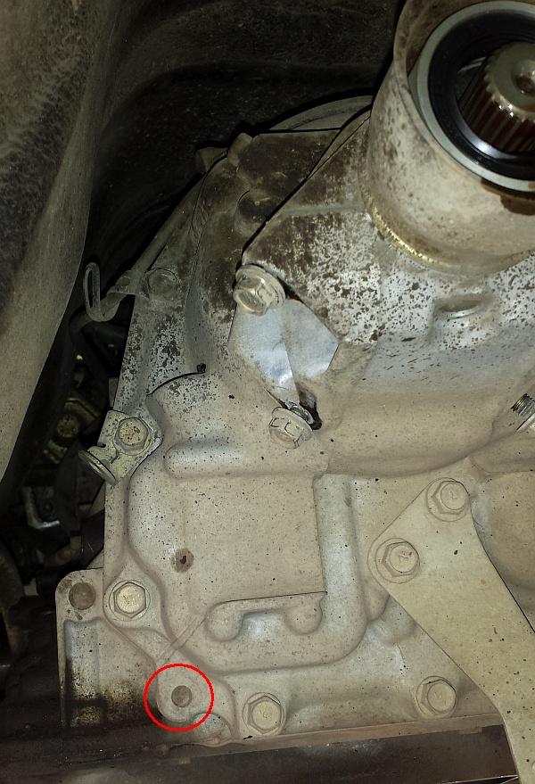

I am working on replacing the duty C solenoid in my 1998 OBW.  I have everything removed except for the darn tail housing on the transmission.  All 11 bolts are out but the thing won't budge.  Am I missing a trick?
In this photo (taken prior to bolt removal), see that thing circled in red on the lower left?  Is that an alignment pin, or a bolt threaded in from the other side?
Thanks.

Pin. There are two of them. Thay make getting the thing off a pain, they fit quite snugly.

Gotcha, I saw the other one and lubed both with PB Blaster.  Was finally able to work the housing off.  Not easy!  Thanks.
