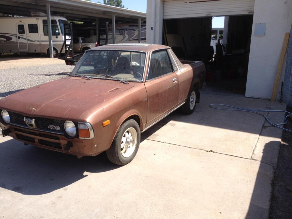

G14 James Posted August 20, 2014 Share Posted August 20, 2014 i purchased a 79 Brat about a month ago and im a little confused on the healights. It has the two headlight grill and they work on low beam but not high beam. What is strange is that there is four headlight plugs but only two healights. are these the wrong headlights. the grill seems stock since it matches the the headlight cutout in the body below it and the four headlight design is stright across. Quote Link to comment Share on other sites More sharing options...
turbosubarubrat Posted August 20, 2014 Share Posted August 20, 2014 They only made one harness for both the gl and dl models. You have a dl so you only have 2 head lights instead of the four that came with the gl models. If you want you can swap over gl head light buckets, 4 head lights, and a gl grill to have 4 lights. Your problem is a bad connection from the head light switch connector most likely. Quote Link to comment Share on other sites More sharing options...
G14 James Posted August 20, 2014 Author Share Posted August 20, 2014 (edited) sweet thanks i might try swithching to four since it came with a GL grill but might look funny with the cutout under the light. Would it matter if i had the wrong plug attached to the light? Edited August 20, 2014 by G14 James Quote Link to comment Share on other sites More sharing options...
djcommie Posted August 21, 2014 Share Posted August 21, 2014 I had the same issue and had a dirty switch, dirty fuses, AND blown bulbs on my 4 headlight GL. If you want 4 headlights I have the buckets/brackets and grille... Quote Link to comment Share on other sites More sharing options...
G14 James Posted August 21, 2014 Author Share Posted August 21, 2014 I had the same issue and had a dirty switch, dirty fuses, AND blown bulbs on my 4 headlight GL. If you want 4 headlights I have the buckets/brackets and grille... i have the grill, guy i got it from gave me three extra and one was the 4 headlight, i would just need the buckets and brackets but havnt decided which looks better Quote Link to comment Share on other sites More sharing options...
