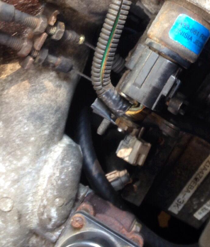

The new one is in. It starts, runs and drives, but has wicked case of torque bind. That's a whole different topic to be addressed at another time. Plenty of reading on here about that. I've got more basic questions.
There's a connection to what I think is a knock sensor that I can't get to connect. I'm attempting to upload an image but should it not work, the wires that appear to need to hook up are just a bit more toward the drivers side of under the throttle body. Large white female end and a gray male end. Both are super short and don't want mesh. If they don't, what happens?

Yes that's the knock sensor.  The ECU will flag it and retard the timing, less power, bad gas mileage.  Make sure the knock sensor is installed correctly and the wire leads are not tangled.  Its a tight area, sometimes it's worth unbolting the throttle body (4 bolts).
