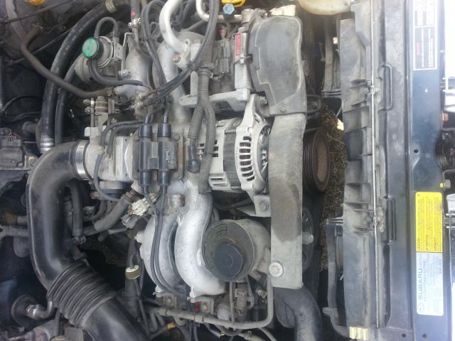

troys75 Posted September 2, 2014 Author Share Posted September 2, 2014 Not sure how to tell engine type I will include pic. It has 170k miles. I did replace the battery last week. Tried disconnecting the battery but not with a load. I will test that next Quote Link to comment Share on other sites More sharing options...

upnorthguy Posted September 2, 2014 Share Posted September 2, 2014 Not sure how to tell engine type I will include pic. It has 170k miles. I did replace the battery last week. Tried disconnecting the battery but not with a load. I will test that next That should be an EJ22 (same as my 95 LS). Can't quite tell from the photo you posted, but if you look down between the power steering reservoir and the alternator it will say the engine model on the block (EJ22 or EJ25). You can also tell by looking at the valve covers or the number of cam gears on the front. EJ22 EJ25: Quote Link to comment Share on other sites More sharing options...

troys75 Posted September 2, 2014 Author Share Posted September 2, 2014 Ok I see it. It says EJ22. Tomorrow I am gonna check out some wiring, grounds ect. Anyone think a possible o2 sensor issue? With loss of power/bogging down. Just a thought. But really only issue with ac/defrost Quote Link to comment Share on other sites More sharing options...
