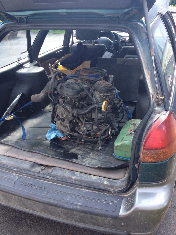

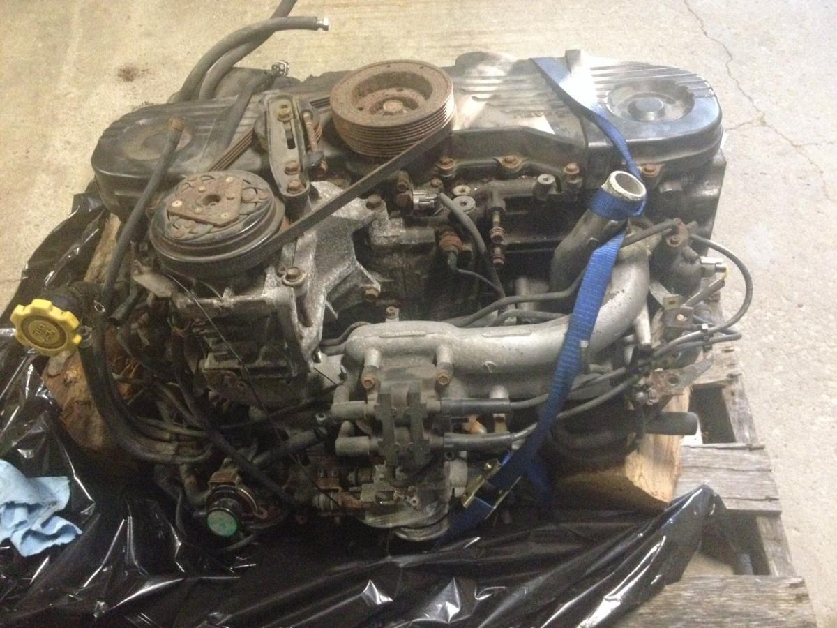

I recently purchased an EJ22 from a trusted friend of mine. Got it for $200. Includes sensors and wiring attached to the engine (no harness), and AC compressor, flexplate, valve covers, etc.
EDIT: does have the harness
'NOTHER EDIT: SHE'S STAYIN' STOCK. My EJ25's starting to overheat so I just need this one together sooner than later... :/

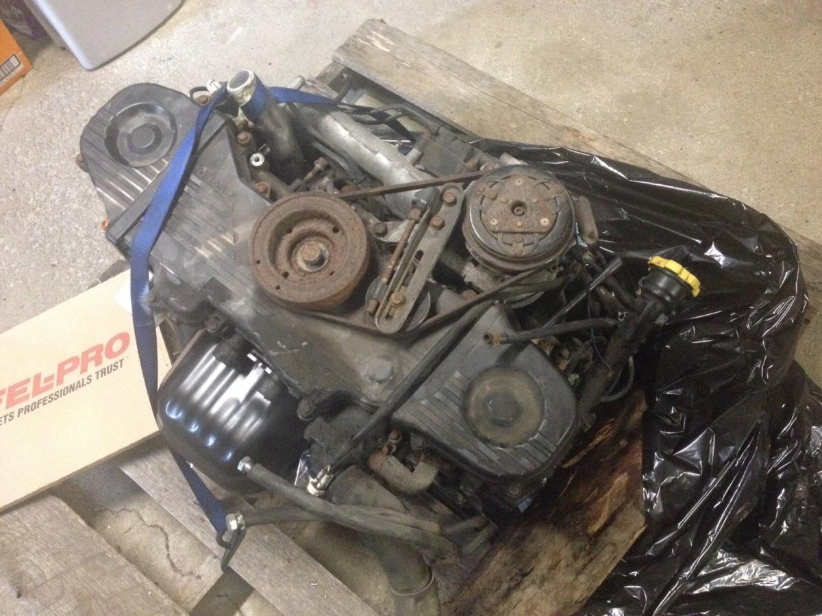

The story I got is that it was pulled from a car that hit a deer and tweaked the frame, was wrote off as totaled. The last owner intended to build it, however never had the time and hasnt done anything to it. It supposably has 140k on it. Did not come with an oil pan, stored in a cool, dry, fairly clean area as far as I know. I got a "money back guarentee," so if I take the motor apart and find its blown up, the person I bought it from will buy it back.
Discovered it is most likely a 97 (see thread "What year is my engine?") however by the way it sits I cannot access where the VIN is supposed to be, so the manufacture date on the oil filler cap is what I am going by for now.

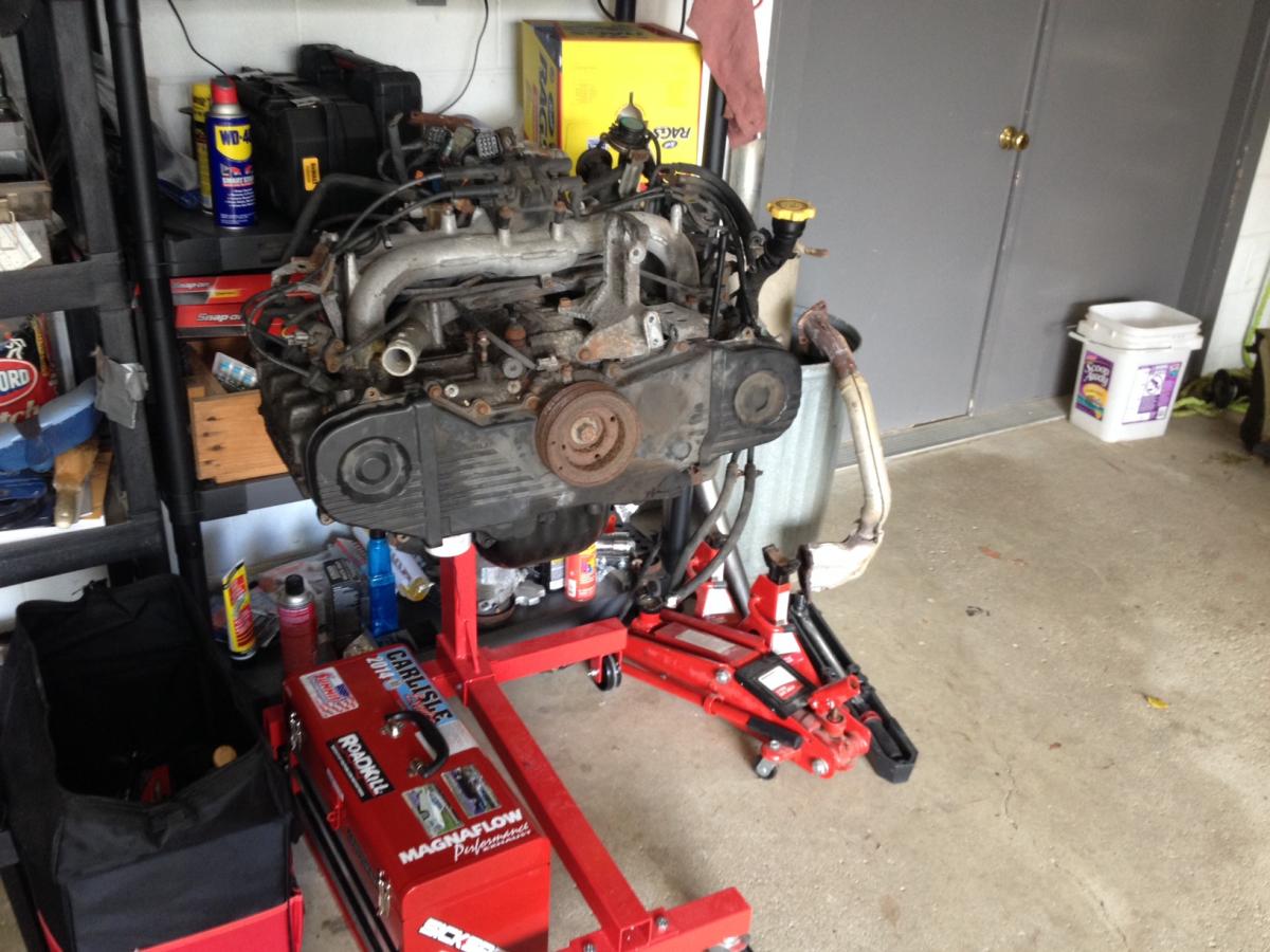

Those engines aren't that heavy. Flip it onto some blocks so you can bolt the bracket part to the bellhousing, then just pick it up and put it on the stand.
As far as a build. Delta cams are cheap and add a few ponies for daily driving.
Thats not a great block for a turbo setup. It can be done with enough work but you're talking full-on build with low compression pistons. Otherwise you're limited to about 5 psi. The way I see it a turbo just isn't worth it if you can't run at least 10.
The main thing ill stress with any build: cleanliness is key. Make sure your parts are clean, and your work area is clean. These engines have very tight tolerances, and making sure everything is clean during assembly goes a long way towards reliability.

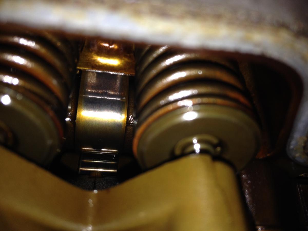

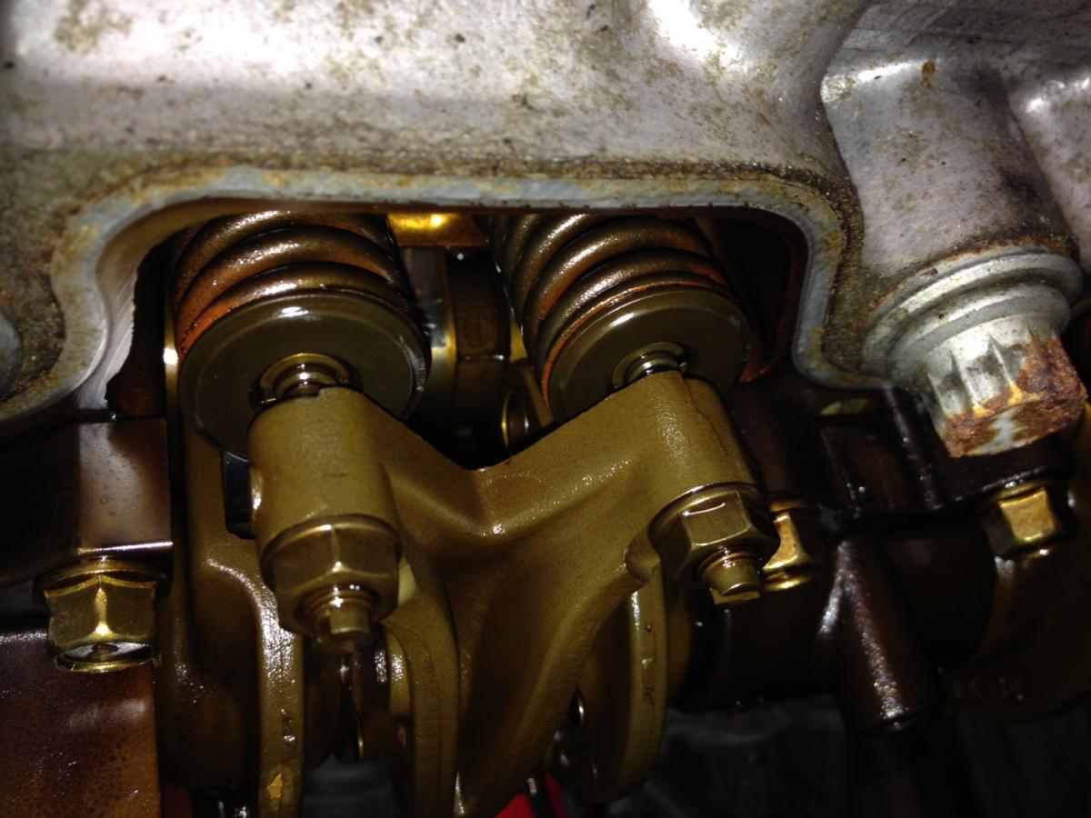

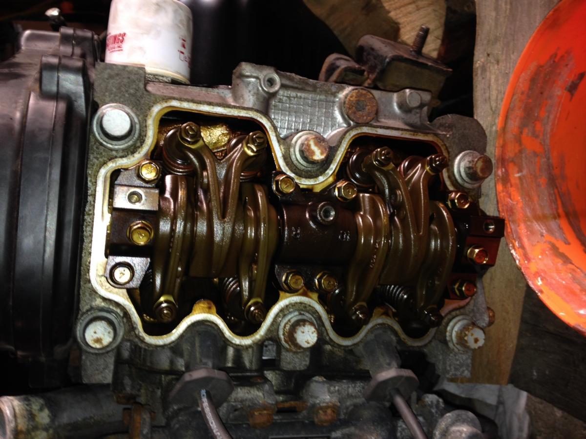

Finally got it on a stand. Like I said before, I bought this engine and didn't really have an idea of what shape it was in, told it had 140K and came from a deer victim car. it came with an oil filter on it, so i drained that into a clear container and ran a magnet underneath, then through it. No metal shavings or slivers. Oil smelled healthy, looked to have about half of its life left. I then pulled off a valve cover. No sludge. appears to have roller followers from what I could see, so the cam was like new, no scoring.
Anything else I should look for? Im going to be tearing it down eventually, so ill be looking at pistons, rods, crank, etc.

Just basing this off your pictures and person experience, that's a 97/98 motor, from the coilpack and valvetrain and presence of egr. I've never heard of different timing belts for the ej22e, it's possible their listings are mixing in the ej222 which does in fact have a different timing belt. In the 15 years I've been working with ej series cars I've never seen a phase 1 sohc not use the same belt.

Any advice on how to remove the harmonic balancer without an impact? Im currently using a chain wrench to hold the pulley with one hand while using a breaker bar on the bolt with the other hand, but thats pretty cumbersome and I cant get enough torque on it. As the engine is on a stand, it just spins the motor if I dont hold the pulley. Is the bolt reverse thread? Should I just break down and finally get an air compressor or battery impact?
Good strap wrench, then take your ratchet & 6 point socket, put it on and hit the ratchet handle with a heavy hammer.
If the flexplate is still on you can use it to lock up the crank.  If option 1 or 2 does not work, you can pull a plug and stuff a bunch of rope down the plug hole to lock the cylinder as the piston comes up against the rope.

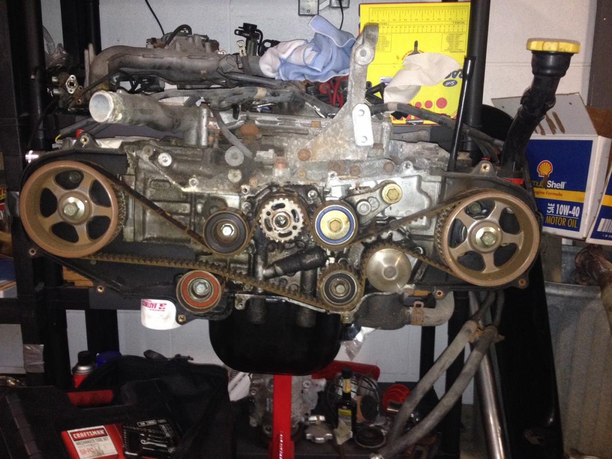

What should I do/mark timing-wise when I take the heads off? Ill be doing the timing belt once the new head gaskets are in. Also, what should I look for to check the condition of the tensioners? And will spraying brake clean harm anything? Thanks, yall
Edit: any good/bad brands for belts and tensioners I should be aware of?

Don't bother with head gaskets - throw on a gates timing belt kit, cam/crank seals, cam support o-rings and valve cover gaskets and just run it if you are otherwise leaving it stock.
GD
Probably not a bad idea. Saves me money and trouble of having heads sent out to be resurfaced (yes i read how to do it myself but dont have the space/tools/confidence to do so)
What about the oil seperator? They leak on all of these engines... Anyone make aftermarket metal ones or do i have to go to the dealer?
reseal Oil Seperator, Subaru metal ones are $12 0r so.
locktite oil pump rear cover plate, new o-ring & reseal
Cam & crank Seals
New ngk plugs
New valve cover gaskets
