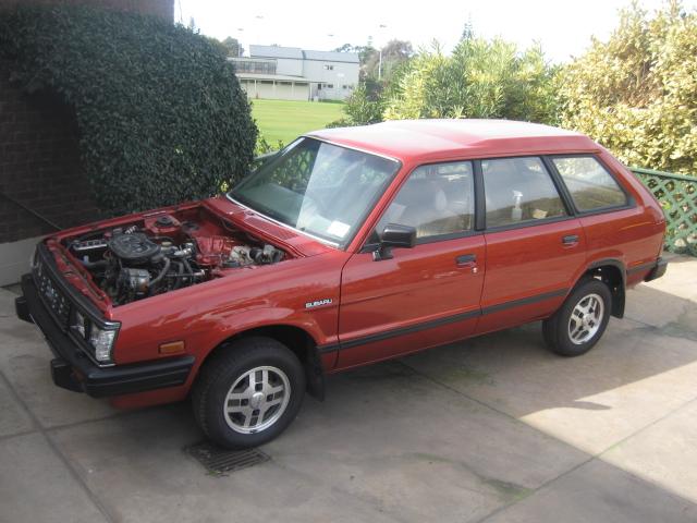

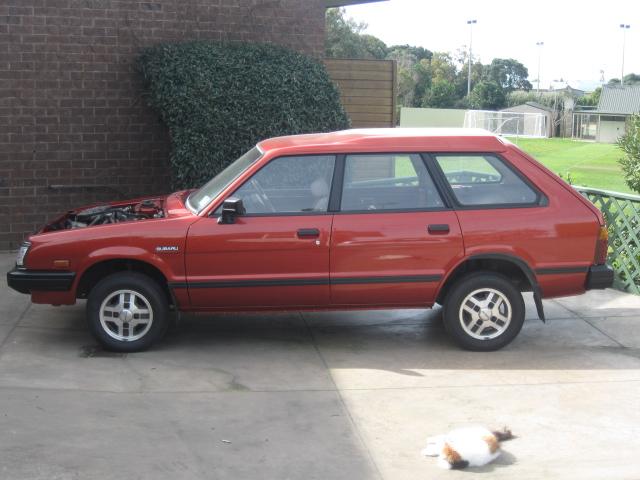

sub1980s Posted February 22, 2016 Author Share Posted February 22, 2016 Paint matched to sample,of old colour cheers. Quote Link to comment Share on other sites More sharing options...

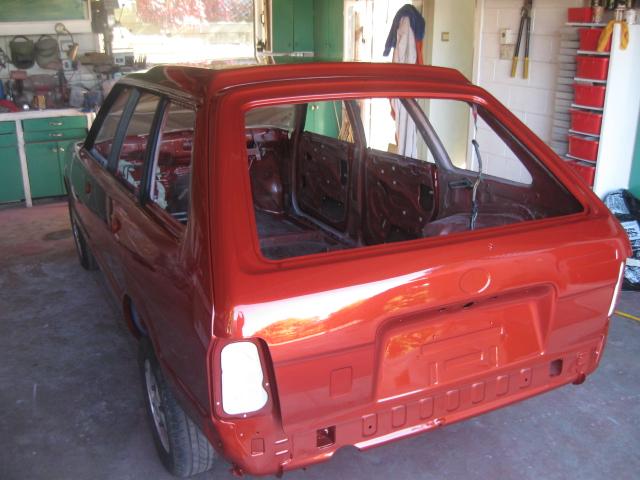

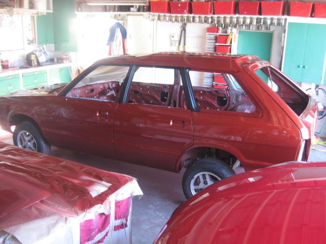

sub1980s Posted April 8, 2016 Author Share Posted April 8, 2016 painted this week,was going to get someone with a spray booth to do it,as less crap ending it, and it makes a mess.Plus if it goes wrong apply 2 pack clearcoat,as more work to fix and tidy up.I would rather only spray a couple of panels at most.Some of the soft edge masking has a hard paint edge now,yes some bits are disappointing ,won't to any way.thanks for looking Rowen. Quote Link to comment Share on other sites More sharing options...
sub1980s Posted April 8, 2016 Author Share Posted April 8, 2016 was painted at home, not ideal, fumes, mess, neighbours 1 Quote Link to comment Share on other sites More sharing options...
sub1980s Posted April 8, 2016 Author Share Posted April 8, 2016 Did buy a Iwata AZ3 HTE 2 for topcoat as the cheap gravity feed gun I had bought using it as a primer gun only on this car.as owned a suction spraying gun for 20 years,they still do a good job. Spraying the 2 coat of clear found it difficult as seeing what I was doing with overspay mist in the garage, and the shiny surface from the from first coat, made hard to see an judged.And no iam not a spraypainter. Quote Link to comment Share on other sites More sharing options...
sub1980s Posted April 8, 2016 Author Share Posted April 8, 2016 Have 6 places the size of a pea paint runs to fix up. Quote Link to comment Share on other sites More sharing options...

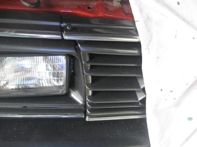

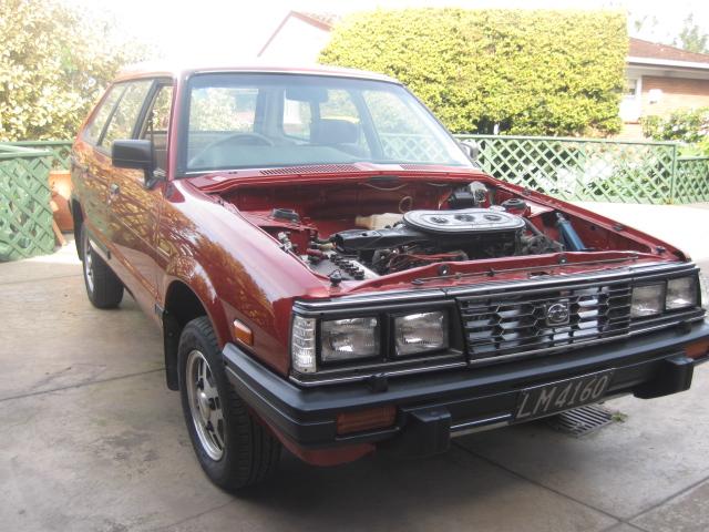

sub1980s Posted June 17, 2016 Author Share Posted June 17, 2016 Finished painting bumpers in lacquer black textured bumper paint.The rest painted in 2K matt black the tailgate handle fascia, door handles ,door mirrors, window wipers,petrol flap,brake booster,headlight bases,wheel nuts, done before winter sets in. The bumpers needed repairs,a few scrapes here and there that needed filling. Used flexible bumper body filler. the area I wanted to fill any dags or ridges nock them off with sandpaper.I run the sandpaper in the gouges so the filler has a good key to stick to.I think usd 120 grit.Final sanding used 240 grit maybe a bit of 280 grit, sprayed a light dusting of plastic adhesion primer twice, ten minutes between coats.Then primed the whole bumper with grey lacquer primer 3 or 4 coats. Enough of the boring talk its assembly,luckly I did take plenty of pictures of car to help reassembly.As you do forget things ,where does go ??? looks simple enough at the time. Quote Link to comment Share on other sites More sharing options...

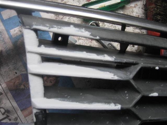

sub1980s Posted August 26, 2016 Author Share Posted August 26, 2016 Tidy up grille and headlight surrounds, cracked grille only super glued with plastic patch on the side to give more contact area for strength.On the top there was little broken piece broken, super glued it in, see photo red arrow.Finish off with body filler,and sand it back. Quote Link to comment Share on other sites More sharing options...
sub1980s Posted August 26, 2016 Author Share Posted August 26, 2016 filled a few gouges then,brushed some 2k primer on repair area. Quote Link to comment Share on other sites More sharing options...
sub1980s Posted August 26, 2016 Author Share Posted August 26, 2016 Sanded back with 400 wet on repair area.Then went round with scotch pad to ruff it a little any other bits that funny used some sander to it nocked back.Mist coated some plastic adhesion primer,20 mins later grey lacquer primer sprayed on.The next day used grey scotch pad gave it a bit of rub.Then used degreaser on rag and wipe it all over, with another clean rag wipe it dry.Sprayed the three items gunmetal lacquer paint. job done. Quote Link to comment Share on other sites More sharing options...

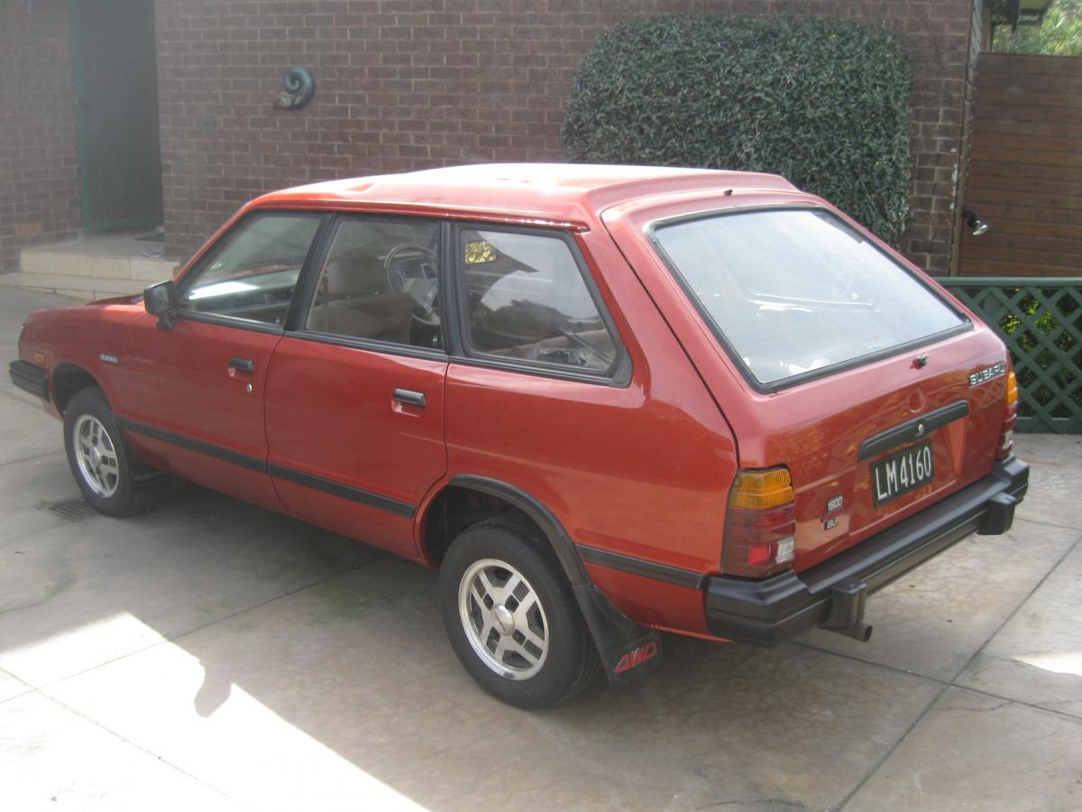

subnz Posted August 27, 2016 Share Posted August 27, 2016 (edited) Nice work / progress - have always liked the look of these last 2nd Gen Leone GL touring wagons especially with the factory alloys fitted. And original black NZ new registration plates - nice. My 1st Subaru was an 83 wagon sort of similar but flat roof and with single uglier headlight enclosures (a lower spec one 2nd hand ex japan JDM a mix of DL / GL features. Edited August 27, 2016 by subnz Quote Link to comment Share on other sites More sharing options...
sub1980s Posted August 27, 2016 Author Share Posted August 27, 2016 Thanks thought show some pics,alloys looks alright,like look the brumby brat steel rims?on the wagons. Quote Link to comment Share on other sites More sharing options...

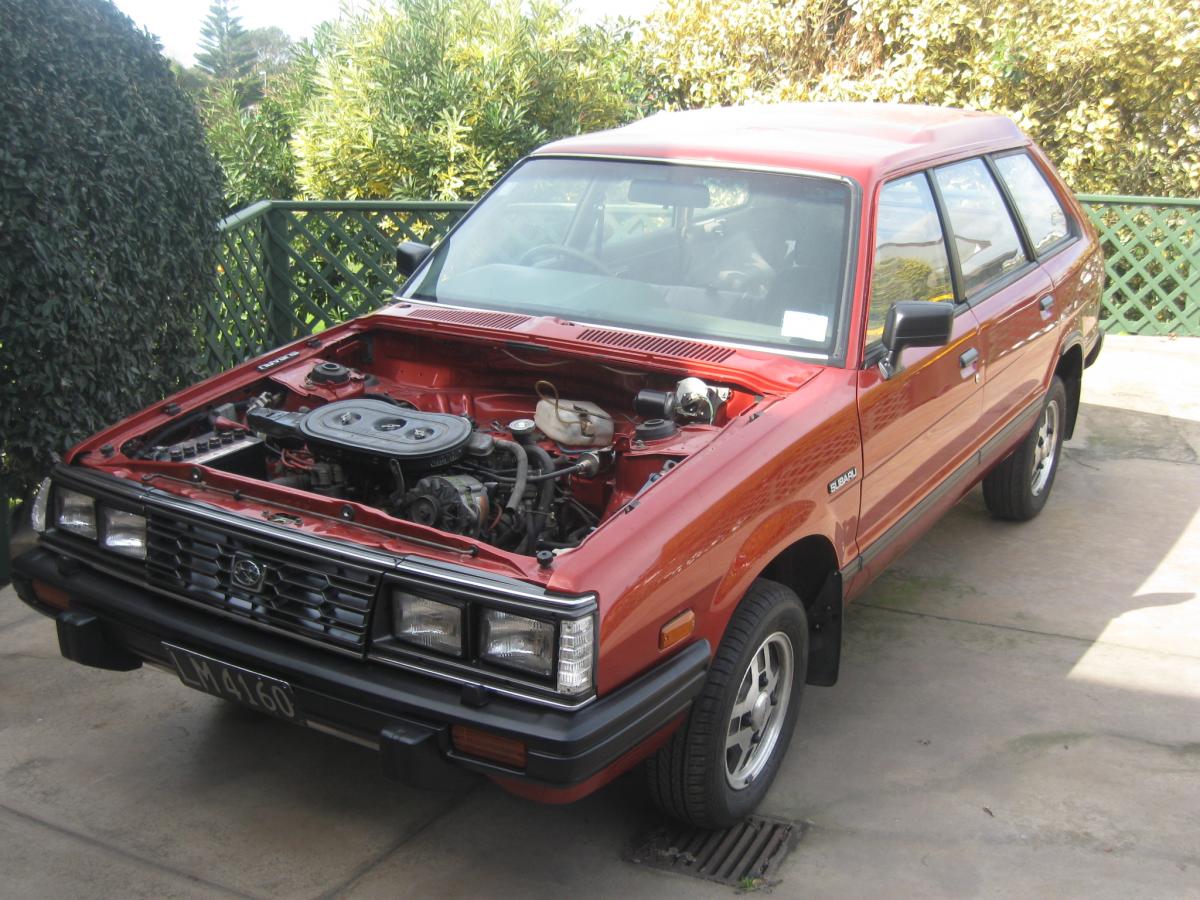

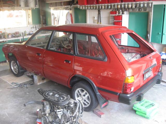

sub1980s Posted August 27, 2016 Author Share Posted August 27, 2016 1600 in car,to be taken out. Quote Link to comment Share on other sites More sharing options...
sub1980s Posted August 27, 2016 Author Share Posted August 27, 2016 pushed outside to clean garage. Quote Link to comment Share on other sites More sharing options...
sub1980s Posted August 27, 2016 Author Share Posted August 27, 2016 Needs drivers door moulding. Quote Link to comment Share on other sites More sharing options...

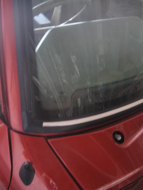

sub1980s Posted August 27, 2016 Author Share Posted August 27, 2016 Bought front windreen rubber from OZ Auto Moulds & Rubbers, for sub brumby rubber approx. $120.00 NZ dollars. Reused old mouldings ,some of the black alloy foil? peel off,will paint mouldings paint black later. Quote Link to comment Share on other sites More sharing options...

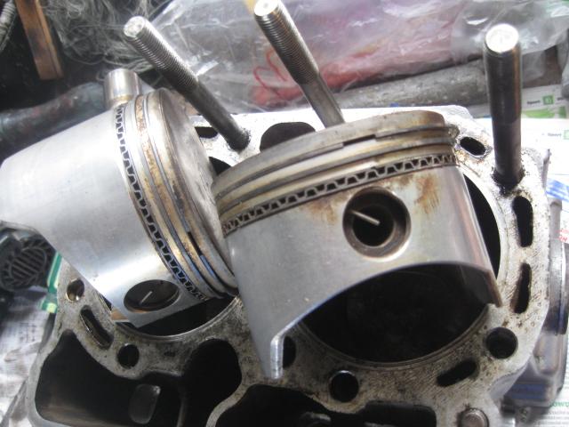

sub1980s Posted August 27, 2016 Author Share Posted August 27, 2016 Cleaning engine EA81.Have another crank shaft and conrods.Did get someone to look at pistons and rings,said I needed news ones,as rings to loose on pistons I think, and being a flat four would be a oil burner,so rebore 20 thou piston and rings. .New main bearings and conrod bearings.So will take to someone else not sure who to use for engine reconditioning.Plus they want me to buy pistons & rings bearings etc.Hard to source pistons in NZ for some cars I think as less engine reconditioning being done.One place in Auckland would get them for $400.00 NZ for 4 pistons and rings from Aussie.Not sure where this is heading but will get something sorted soon. Quote Link to comment Share on other sites More sharing options...
sub1980s Posted August 27, 2016 Author Share Posted August 27, 2016 The tired pistons and rings done 240.000 kilometres. Quote Link to comment Share on other sites More sharing options...

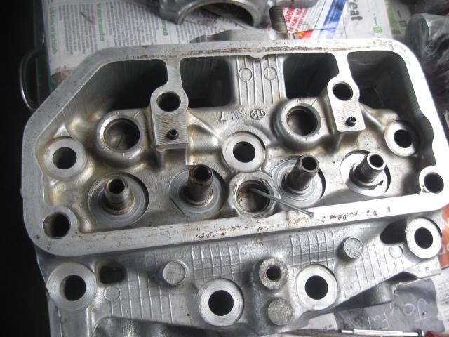

sub1980s Posted August 27, 2016 Author Share Posted August 27, 2016 Cylinder head Frost plugs rusty not far off from leaking water in the engine oil. The nail in the picture sitting in the hole.Other side cylinder head frost plug, brown more rusty, pushed through like card board. Removed the six plugs new ones soon. Quote Link to comment Share on other sites More sharing options...

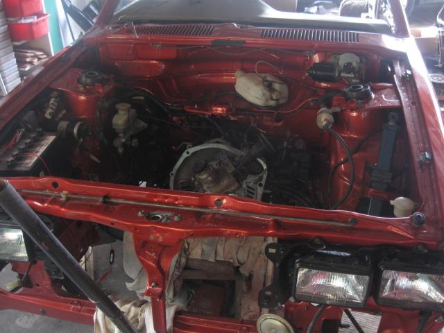

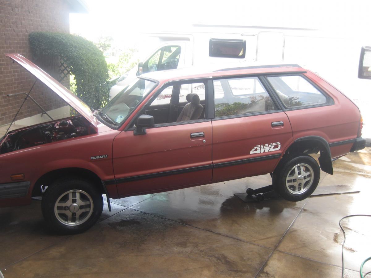

sub1980s Posted August 27, 2016 Author Share Posted August 27, 2016 The wash down of car and engine removal nearly 2 years ago.before complete strip down,i nearly gave up on it? 1 Quote Link to comment Share on other sites More sharing options...
