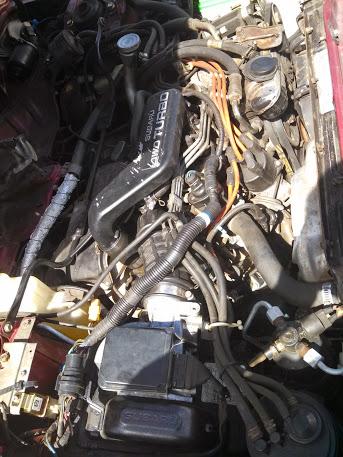

coronan Posted September 22, 2014 Author Share Posted September 22, 2014 So, the weather here has been sh*t for taking pictures for the last few weeks. My area has been getting all the smoke from the California fires. Its like smoking a pack a day. But here she is.... Can someone point out the transmission dipstick tube for me? I'm either a complete retard or its not there. I read that all MT and autos got a dipstick and it is used as the fill hole. Should be near the Bell housing, right? I want to change the fluid. Maybe someone can circle it. Transmission identification Dizzy a 4 wire. I don't think the Turbo motors got a choice between Hitachi or Nippon-Denso. Think it has knock suppression???? Can someone tell me what Relay has been bypassed? Most cars have 3 relays here. I only have 2 sockets here. But I do have AC. On to the oil pump: Does this cap mean that my oil cooler has been bypassed???? I did find and oil cooler in front of the radiator, But I couldn't easily follow the lines. So i added one of these I had laying around to the oil filter. It is good for a few extra pounds of oil pressure. I also got my butt kicked by the water pump last week. Subie knows how to pack it in there. If you have AC you know what I mean. Cheers! Quote Link to comment Share on other sites More sharing options...
Silas Cruse Posted September 22, 2014 Share Posted September 22, 2014 that finned thing is an oil cooler! ha Quote Link to comment Share on other sites More sharing options...
turbosubarubrat Posted September 22, 2014 Share Posted September 22, 2014 You cant find the dip stick since its hidden under the turbo shroud. It mounts with 2 bolts one on each side of the engine bay which need taken out and the sensor unplugged. The ignition module its self it specific to the ea81t and ea82t but the mechanical parts of the distributor are the same as a non turbo. You see the two hard lines coming off the oil pump? Those go to the oil cooler on the front (you can see part of one of the lines in the picture). Quote Link to comment Share on other sites More sharing options...

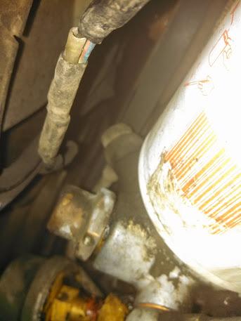

coronan Posted September 23, 2014 Author Share Posted September 23, 2014 Thanks TSB! Did subie use magnetic drain plugs on the trany & rear diff? Do do i need to get some? @ Jono: Got a write up for that temp monitor install??? I'm curious how and where you mounted the probe. Quote Link to comment Share on other sites More sharing options...
coronan Posted September 23, 2014 Author Share Posted September 23, 2014 So I took the Brat out on some dirt yesterday... I tried to do a hand brake turn......HEAVILY DISAPPOINTED. Where is the rear hand brake conversion mod?????!!!!!! Is it possible with the rear caliper upgrade or did all 80 cars get front e-brakes? 1 Quote Link to comment Share on other sites More sharing options...
jono Posted September 23, 2014 Share Posted September 23, 2014 (edited) Well, the watchdog TM2 comes with instructions to mount the probe which is mounted to a ringed electrical connector conveniently and heatshrink wrapped - mount it under a thermostat housing bolt. Have since made my own with ebay unit at 1/10 the price found an electrical lug supplier....started with a ring lug suitable to bolt an M8 through the hole. Then, found next size down, its wire connect end, fitted its butt inside the wire end of the larger terminal, so soldered it in place, chopped its smaller lug head ring off, drilled out new reduced size wire end to 4.0mm to take the 4.0 mm probe nice tight fit and wire up an intermittent screaming alarm from jaycar. If you have finance the watchdog is easiest option. The ebay units are nice price and a small challenge, are panel mount for best look and Subie grey to begin with .... http://www.ebay.com.au/sch/i.html?_from=R40&_trksid=m570.l1313&_nkw=12v+aquarium+temperature+controller&_sacat=0 a current link in A$ used 12V aquarium temperature controller as search words ..... just ensure you get the one with buttons on the front panel ! If you search harder, there have been two channel units that could use to switch relays for a pair of fans at different set temps, or fans on for lower setting, alarm for overheat higher set temp. When first played with them, watched them change temp reading with probe in the breeze 0.1 deg C changes ! The vac cans are turbo specific too as they are boost retard as well as vac advance in the EA82T of 85,86. Yours likely the same and is common for the diaphragm to be shot and leak boost into the distributor. Took me five months to learn this - with the help of pressured proppane vapours sneaking inside the spark chamber on light boost - BOOM !! Edited September 23, 2014 by jono Quote Link to comment Share on other sites More sharing options...
