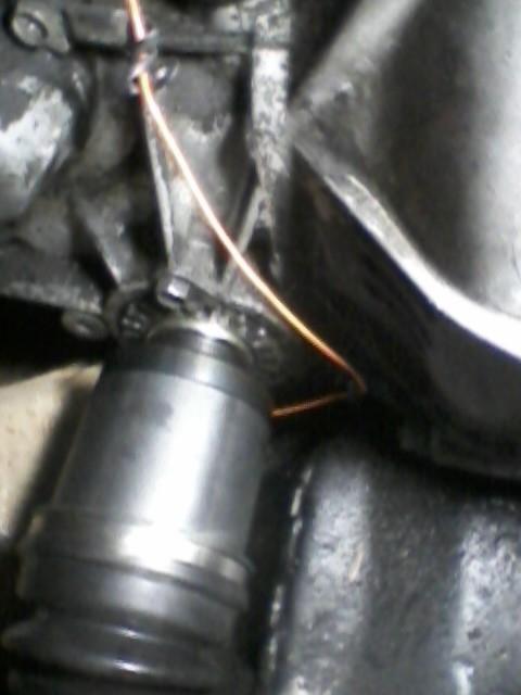

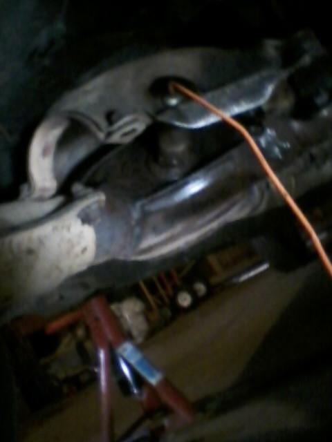

Dee2 Posted September 23, 2014 Share Posted September 23, 2014 The old CEL came on today and when I checked the code I got 32 - Oxygen sensor. This will be the first for me on this old car. Doesn't look too bad I can see the sensor is located below the passenger side axle with an orange wire running up to a plug above the transmission. Any tips on replacement brands or will any brand do the job ? Special tools look to be required because of the wire, or can I do this with an open end wrench ? Any warnings/tips on what I'm going to break along the way ? Quote Link to comment Share on other sites More sharing options...
robm Posted September 23, 2014 Share Posted September 23, 2014 Use a box end wrench, just undo the wire first and slide the wrench over the wire. The offset type work best. Start the car and run it for a bit before starting, they are supposed to be easier to change if hot. Lots of penetrating oil can't hurt either. Try to get one that is OEM replacement, as it is easier to use the connector than have to cut and join the wire on a generic one. Quote Link to comment Share on other sites More sharing options...

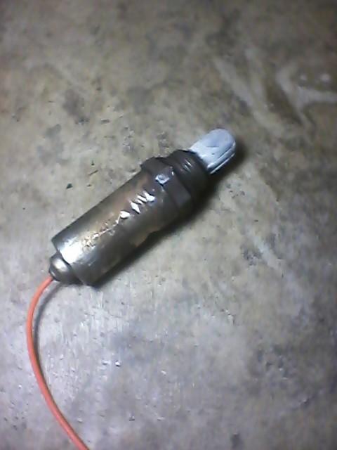

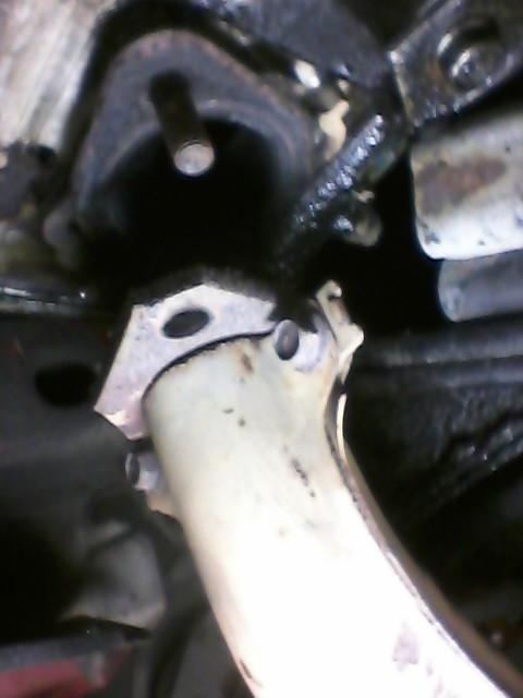

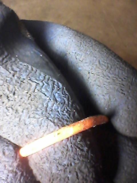

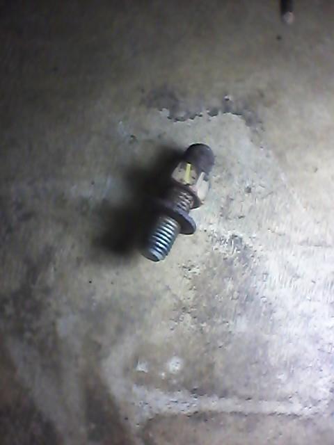

Dee2 Posted September 23, 2014 Author Share Posted September 23, 2014 (edited) So I've been digging out the old sensor. --disconnect the battery --raise car, set on jack stands --disconnect sensor wire from harness --remove heat shield around sensor --spray sensor with penetrating oil --remove heat shield around exhaust manifold to engine --disconnect manifold from engine had one problem occur, a manifold stud came out on one side. Not sure how much of a problem I've created there. --pry heat shielding away from top of sensor area --remove sensor with 22 mm open end wrench and pipe extension Lots of white ash on the sensor.... After inspecting the wire, I found a few spots where the casing had been worn through, which I now think caused the trouble code. Not sure how to test these units but it's probably overdue for replacement anyways. Edited September 23, 2014 by Dee2 Quote Link to comment Share on other sites More sharing options...
stratman977 Posted September 24, 2014 Share Posted September 24, 2014 Best bet on the stud is to replace it with a new one. Any auto parts store will have it on the shelf for a few bucks. Those aluminum threads in the head are prone to stripping out so be careful. I use loctite sleeve retainer to keep the studs in and liberal amounts of anti-seize on the exposed threads to keep the stud in good shape. Quote Link to comment Share on other sites More sharing options...
Dee2 Posted September 25, 2014 Author Share Posted September 25, 2014 (edited) Picked up my new O2 sensor today. Decided to just go with a full wire Bosch, same as what was in there before. It was available locally. Put it in, got everything reassembled, cleared the old codes and fired up the car. No more CEL. Also, just before I started getting the CEL, I noticed the engine was surging a bit when idling. Now, with the new sensor, no more surging As for the manifold stud, I just put it back in as it was. I thought about using loctite but wasn't sure. Glad to know it can be used. I'll probably watch it for a while. If it loosens up, I'll redo it with loctite. A little side task, I noticed the bolts on the oil pan were all loose, so I snugged them down with a phillips screw driver, (except the back few I can't get to). Hopefully that will help resolve some of the oil mess I found under the car. Thanks for the feedback, it makes the job a whole lot easier, and now it's done! Edited September 25, 2014 by Dee2 Quote Link to comment Share on other sites More sharing options...
