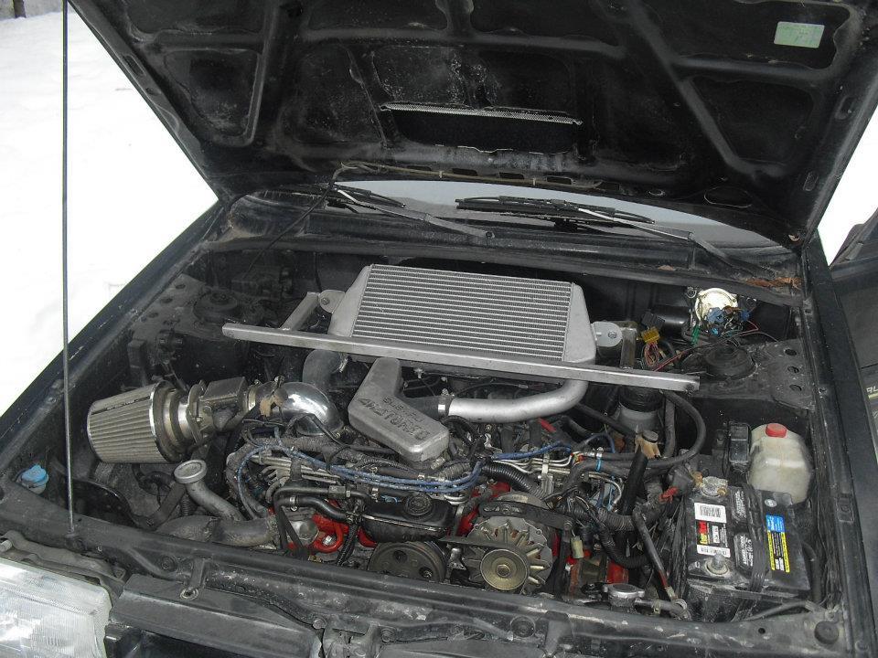

Crazyeights Posted November 10, 2014 Share Posted November 10, 2014 (edited) This is a Mitsubishi Starion cooler unit on an EA82. Something like this might work. This is not my picture. Edited November 10, 2014 by Crazyeights Quote Link to comment Share on other sites More sharing options...
coronan Posted November 10, 2014 Author Share Posted November 10, 2014 I cant believe they used the stock Throttle body tube. It seams so restrictive. Also there are at least 2 vacuum line that come off the stock rubber boot going into the turbo. Idle air and something else. Are those still there??? NO BOV? Does the turbo surge? Quote Link to comment Share on other sites More sharing options...
skishop69 Posted November 12, 2014 Share Posted November 12, 2014 Blow off valves are used to release pressure at high revs/pressure when you come off the throttle so you don't fubar the compressor. Chances of that happening on an EA81: Zero to none. If you have an FI turbo'd rig, the 'blow off' needs to be rerouted back to the intake side of the compressor or you get a 'hiccup' since the MAF has already seen the air coming in and the engine is 'expecting' it. Again, still not necessary with the little EA81. Quote Link to comment Share on other sites More sharing options...
