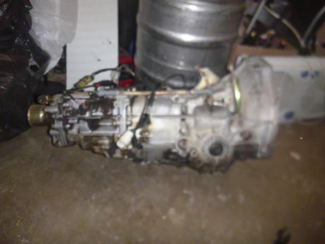

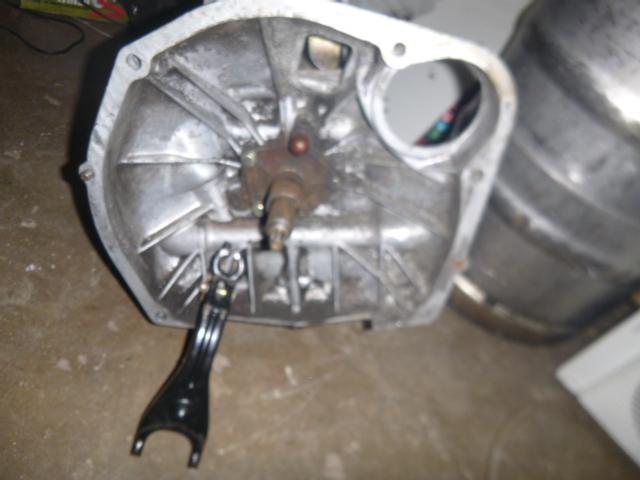

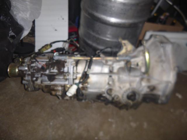

O.K. just to specify, we are talking about transmissions here, not the other trannies. I am trying to piece meal a 1978 Brat together with parts that I have. The problem is I have no idea what they are out of.
This is what I know:
     I have a 1.8 with hydro lifters.
     I have a AWD/4WD transmission that bolts to it. (I believe it is a 5 spd)
     The tranny have a 24 spline shaft
     The stationary shaft that comes out of the front of the tranny is approx. 33mm.
     It is a pull style clutch
Here is my real questions. I do not have the throw out bearing carrier or the clutch/pressure plate. I have the larger flywheel. I bought a bearing carrier (part #431527000) but it is to small to fit over the stationary shaft that comes out of the front of the tranny. It is also too small to hold the bearing. I assume this is due to it being a 24 spline not a 21 spline.
I pulled the tranny and engine out of the car. The cv joints were attached and I believe they are the original 1978 brat joints.
The more info I could get the better. I have the original DR 4 speed but would rather use this 5 speed. I have to order the carrier and the full clutch kit before I can put it all back together and back in the car/truck/toy.
Thanks,
The pictures are of the trans you are trying to identify right? If so, it has dual range, and that leaves you with only one possibility, 5MT D/R. You'll want a 4wd clutch kit for an 86 or so GL. Rockauto has many options that include pilot bearing and throwout bearing assembly. I swear by exedy, but they aren't cheap.

Oh, and yes those are pics of the transmission.
