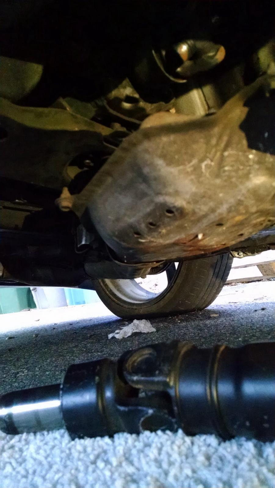

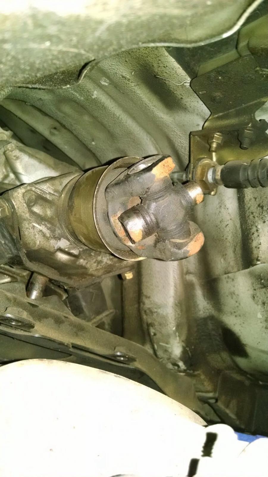

Quick fix for Torque Bind, a fixable transmission problem.  Search Torque Bind and you will fine lots of good info.
And this may be the very reason that the PO removed the driveshaft, you think that's likely? Thank you for that, I will start looking into that as well, I saw a few related postings in searching for the AT MT conversion or driveshaft interchangeability. Thoughts?
No need to swap yokes. The rear half of the driveshaft is the same for auto or manual. Just unbolt it at the center flange and bolt the rear section onto your car. Be sure to pay attention to the way the yokes are oriented. If the rear section is 90° off it will cause vibration.
The driveshaft has nothing to do with the sluggishness. The crushed exhaust pipe could cause that if the actual pipe is crushed. The heat shields on the outside of the y-pipe can be pretty badly bent and not affect the pipe inside.
Thank you for the info, maybe I simply don't understand or didn't explain my problem very well. Ok, so I have an AT with no drive shaft at all going to the rear. I have only the small yoke piece just to prevent ATF from spilling out.
I think the length is different.  If you have one, it's easy to check, just jack up the rear get it on jack stands and then try the drive shaft you have.  Slide it into the trans, see if the mid bearing bolts up.   Bolt it to the rear dif.  It will either work or not.  If not, you will see what you need.
Yes torque bind is likely!
Ok, thank you very much. I can't seem to figure out how to get the last section of propeller shaft from AT, I will start a new post.
I think that torque bind is almost a given now based on circumstances, thanks for that. Looks like it can be relatively easy to resolve.
