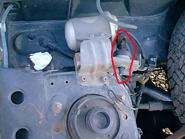

subiemech85 Posted May 17, 2004 Share Posted May 17, 2004 WTF DID YOU DO WITH THE OIL? DIDN'T YOU READ "5.1 oz" OIL IS REQUIRED! evacuate to remove the AIR, it has moisture, impurities, and is VERY hard on the system IF it is carb, you have a vac. line, controller, and the compensator, look by the pas. side of carb and for what I marked in red Quote Link to comment Share on other sites More sharing options...

Hondasucks Posted May 18, 2004 Share Posted May 18, 2004 If you converted to R134a from R-12 you better hope you got all the R12 out, if not you have just created about two pounds of hazardous waste tha will cost about $400 to dispose of legally. Evacuating the system ensures all the old refrigerant is out, as is any moisture and impurites. Proper way to do an R-12 retrofit is to have a shop evacuate the R-12 (most will do it for free since the R-12 tha is removed is worth about $20 a pound) and then pull a vacuum fro 15 minutes or so.. Maybe overnigth if it's been open for a while.. then install the new O-rings if necesary, and then the oil and refrigerant... as for your idle problem, I think your IUCD (Idle Up Control Device) is bad, or one of the vacuum lines to it or the solenoid that engages it is bad. Pull the vacuum line from the IUCD and apply vacuum, IUCD plunger should move. If it does not, replace IUCD. If it does move, check lines and solenoid. Quote Link to comment Share on other sites More sharing options...
nutt7 Posted May 18, 2004 Author Share Posted May 18, 2004 there was no r12 when I started, everything eventually escaped those bad o-rings I replaced...its been dry for at least 4 months. where is this IUCD? thanks, eric Quote Link to comment Share on other sites More sharing options...
