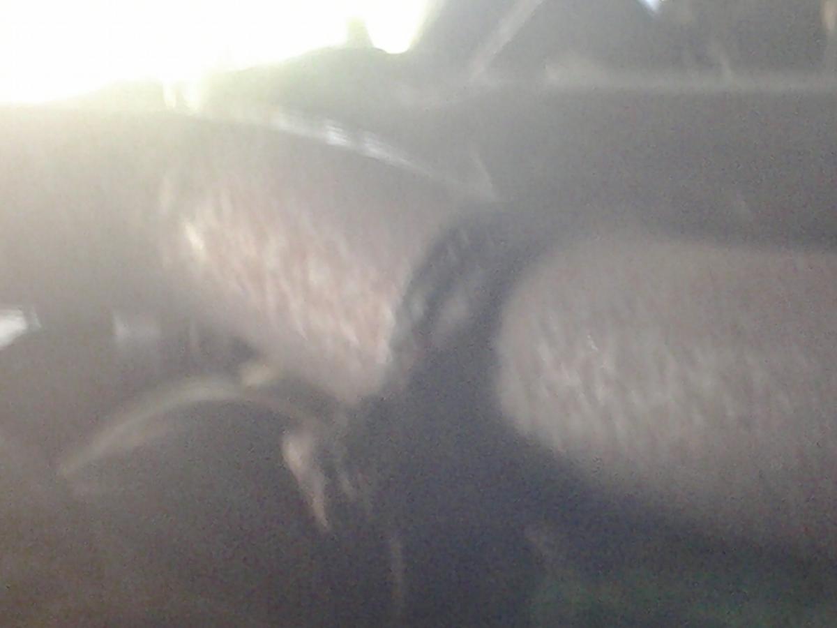

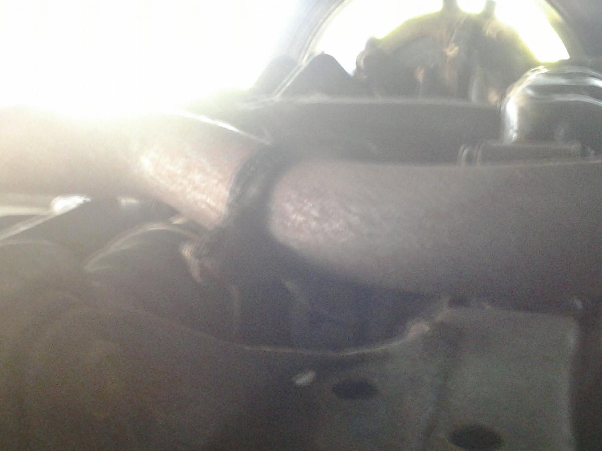

shortlid Posted December 16, 2014 Share Posted December 16, 2014 (edited) Find attached a picture of the resonator pipe to muffler pipe connection that is leaking on my '03 Legacy GT sedan with 107k on the clock. my guess is the flanges will not put up with me taking them apart. Once apart they will never go back together again. Is my best bet replacement over flanges, and new donut and call it fixed for awhile. Or is there a stainless kit I should put in it and fix it right? Cause only thing I am finding on Rockauto and at local autoparts stores is Walker aluminized stuff? Edited December 16, 2014 by shortlid Quote Link to comment Share on other sites More sharing options...

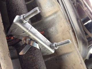

pginter96 Posted December 17, 2014 Share Posted December 17, 2014 I absolutely have, it broke off cutting off my muffler. Ill upload a picture of my... "Fix" later Quote Link to comment Share on other sites More sharing options...

pginter96 Posted December 17, 2014 Share Posted December 17, 2014 believe it or not, this held together very well. my car has taught me to do some very redneck repairs that work. (Its also taught me when to give up). I wouldn't recommend this, if you can afford to go for stainless steel flanges, or do what I ended up doing and cut out the flange all together and weld a small stainless steel pipe in the gap, eliminating the new flanges/redneck repairs that have a much higher possibility of failing than a weld. Or just slap 2 pounds of exhaust putty on there. that works. not for long, but it works! Quote Link to comment Share on other sites More sharing options...

shortlid Posted February 1, 2015 Author Share Posted February 1, 2015 Ended up having a local custom exhaust shop cut out the two flanges on the resonator, and replace with sections of pipe. Hopefully the rest of the factory system will last for awhile. Was $140 Quote Link to comment Share on other sites More sharing options...
