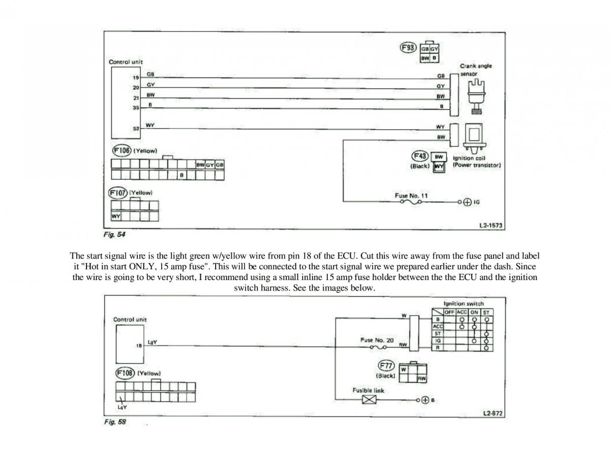

Skylar Posted January 29, 2015 Author Share Posted January 29, 2015 Can anyone tell me what these abbreviations mean ? Mainly the "R" where the start signal wire is supposed to go. Quote Link to comment Share on other sites More sharing options...
