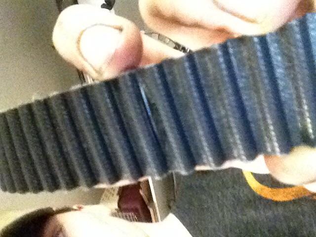

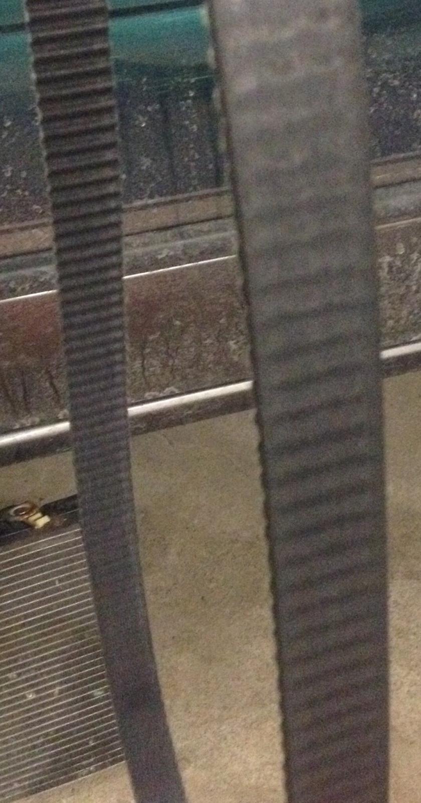

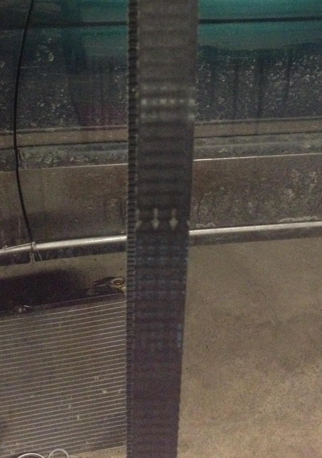

pginter96 Posted January 12, 2015 Share Posted January 12, 2015 Is this normal wear for only 150 miles? Just finished swapping this engine, replacing a profusely leaking oil pump and noticed this. Don't know much about the health of this motor. Is this normal? Quote Link to comment Share on other sites More sharing options...
Fairtax4me Posted January 12, 2015 Share Posted January 12, 2015 The "window blind" effect on the smooth side is normal. Can't see what you're pointing at on the toothed side. Unless a chunk is missing its probably fine. Quote Link to comment Share on other sites More sharing options...
heartless Posted January 12, 2015 Share Posted January 12, 2015 while 150 miles may not seem like much, it is many thousands of revolutions of the motor, so some wear is to be expected... the pics arent really clear enough to really see what you are pointing at, but as fairtax said, unless there is a chunk missing, or the tooth is starting to tear away, then the belt should be fine. I have to ask - did the idler pulleys get replaced when the timing belt was? what condition are the pulleys in? (all of them) any rough spots on any? Quote Link to comment Share on other sites More sharing options...
pginter96 Posted January 12, 2015 Author Share Posted January 12, 2015 (edited) I did the idler pulleys, tensioner, and water pump with the belt. All looked ok from what I could tell, nothing abnormal. Same with last night, I had all idlers and the tensioner off (to be able to remove the oil pump) and nothing looked wrong with the idlers. Tensioner was actually pretty loose, which Ive heard about, but I have the washer and o-ring on the back of it so... On second thought about the tensioner, I may not have torqued it correctly the first time. I thought the engine was a 97, its actually a 98 (the tensioner, of all things, gives that away) so I torqued it to 20-something ft-lbs instead of 32 ft-lbs. Edited January 12, 2015 by pginter96 Quote Link to comment Share on other sites More sharing options...
952.2LX Posted January 13, 2015 Share Posted January 13, 2015 Belt could of been a bit loose from the tensioner slipping. and slipped a tooth in the 150 and then caught on and was hanging in there so to speak Maybe? If not maybe a bad tensioner? Quote Link to comment Share on other sites More sharing options...
efseiler Posted January 14, 2015 Share Posted January 14, 2015 Do you mean 150 miles or 150,000 miles? Darned decimal point! --Damien Quote Link to comment Share on other sites More sharing options...
