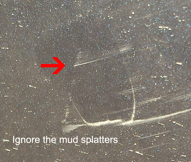

That should buff out fine except for the one you have the arrow pointed to.
If you run your finger nail across that one do you feel your nail catch on it?
If your nail catches on it, it is probably too deep to buff out, though a skilled detailer can make that "disappear".
I used to detail for a living and would cover up scratches worse than that on a regular basis.
I happily defer to the opinion of Fairtax4me. If you have someone who knows how to detail a car saying they can buff this out for free, go for it. It's very unusual for green wood to scratch through the finish. You may be in for a pleasant surprise to see that this buffs out because the scratches are actually residue from the bark and sap. But as Fairtax said, if your fingernail catches on it, it needs a skilled detailer. I hope you are pleasantly surprised if all of this buffs out!
Edited by BB's93LegacyL
if they dealer offered for free - let them have a go at it.
+1 if the finger nail catches it - probably won't come out.
dealers routinely have a guy come to their lot and prep all their vehicles and they usually specialize in prepping paint, etc.  you need to find one of those guys - they're subcontracted by the dealer though so it may be hard to get in touch with them or find out who they are.
