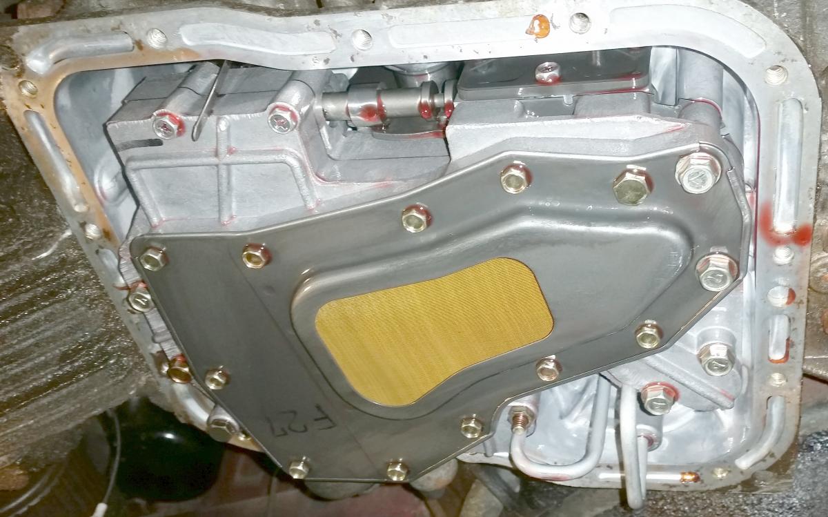

DaveT Posted January 25, 2015 Author Share Posted January 25, 2015 Pan dropped. Nothing but clean ATF in there. Ran my finger across the bottom of the pan, no gunk. Quote Link to comment Share on other sites More sharing options...
ihscout54 Posted January 25, 2015 Share Posted January 25, 2015 Might as well pull the filter too make sure theres no obstruction behind it. Im guessing u checked everything made sure it was tight, how bout those tubes? Had my fingers crossed but i guess this is the real world and nothing is that easy. Quote Link to comment Share on other sites More sharing options...

DaveT Posted January 25, 2015 Author Share Posted January 25, 2015 (edited) Nothing under the filter. Tubes look ok. One bolt won't screw back in. Like it had a nut, and the nut is gone now. Setting up to get the doner car in the garage. Edited January 27, 2015 by DaveT Quote Link to comment Share on other sites More sharing options...

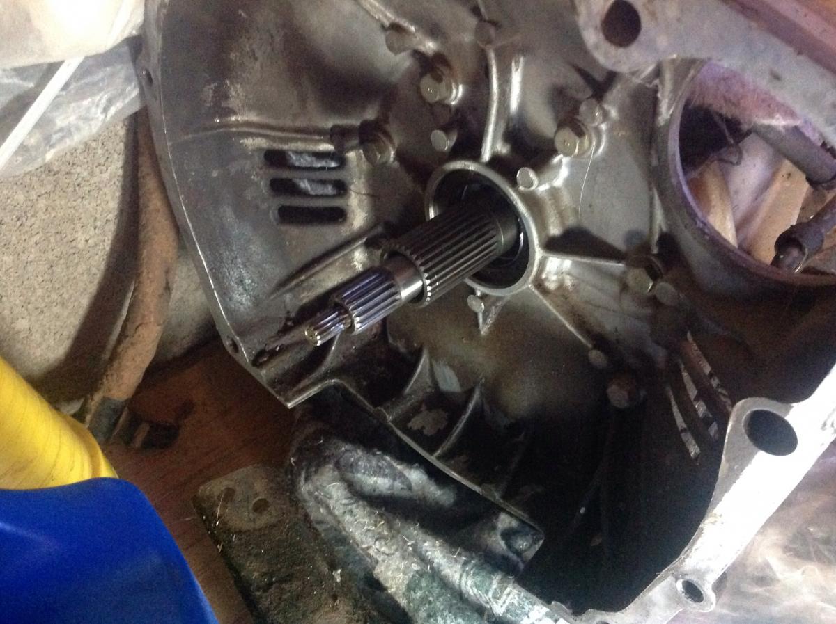

DaveT Posted January 27, 2015 Author Share Posted January 27, 2015 That pump shaft isnt much thicker than a sharpie pen. Its long too. I'll check that. Anyone know if that shaft can be pulled out & re inserted without parts dropping out of place? Quote Link to comment Share on other sites More sharing options...
ihscout54 Posted January 27, 2015 Share Posted January 27, 2015 When I removed the one in thats my garage I tilted it and one or both shafts slid out partially. I remember fiddling to get it/them back in. Its been a couple years, and I cannot remember if it was just the turbine shaft or just pump or both. When I took the photo i wasnt able to easily slide them out. Its possible something caused play in this shaft and the splines failed. Could it just need a shaft... I hope so. But ide still be afraid to put a new one in until I know why it failed. Quote Link to comment Share on other sites More sharing options...
silverhelme Posted January 27, 2015 Share Posted January 27, 2015 I'll check that. Anyone know if that shaft can be pulled out & re inserted without parts dropping out of place? Yes it can be pulled and replaced without any problem once the engine or trans is removed and the converter is taken out. Just be sure and reset the converter correctly when it goes back. A stripped pump shaft would cause your problem but it also could be the splines in the converter or the pump. I've seen them fail for no known reason but a seized pump would cause it. Quote Link to comment Share on other sites More sharing options...

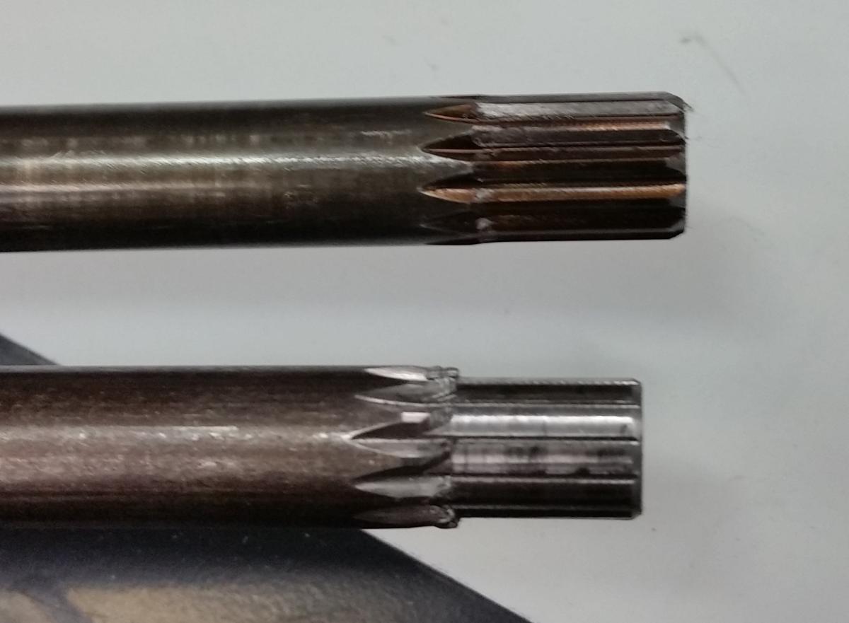

DaveT Posted February 1, 2015 Author Share Posted February 1, 2015 Well, there's my problem... Pump drive shafts. Top one is from my 86. Bottom one is from my 90, which is the one that was in my 87 when it broke. The 87 now has the transmission from my 92 installed, and it's working. Now for the $64,000.00 question - why did the pump get stalled so bad the splines stripped clean off? Quote Link to comment Share on other sites More sharing options...
Loyale 2.7 Turbo Posted February 1, 2015 Share Posted February 1, 2015 (edited) I've been following this thread silently, in "Learning Mode" as I do with many threads where I am not Sure what could be going on, I've dealt with Automatic Transmissions in the Past, even with broken differential's Spider gears, etc... but about this: ... why did the pump get stalled so bad the splines stripped clean off? This is the very first time for me to see something like that Happening. Could it be a worn bearing or gears that broke off, blocking the Pump from spinning? You might need to disassemble further, to reach the mere pump's area to know the truth... I hope that your transmission could be Fixable after that... Good Luck! ...Kind Regards. Edited February 1, 2015 by Loyale 2.7 Turbo Quote Link to comment Share on other sites More sharing options...
ihscout54 Posted February 1, 2015 Share Posted February 1, 2015 (edited) Well they are just big oil pumps. The innards are tight, and it wouldnt take much the stop them up. That shaft looks professionally lathed and polished. I dont beilive that happened instantly, i was expecting a shearing or splitting. Could it just be a clearance issue with the shaft itself? The shaft is nearing 2' long right? Perhaps that thing has been wallering around back there for the last 10k, and the final 1/16th of an inch of spline failed. I am glad your back on the road. This has been alot of work. Edited February 1, 2015 by ihscout54 Quote Link to comment Share on other sites More sharing options...
