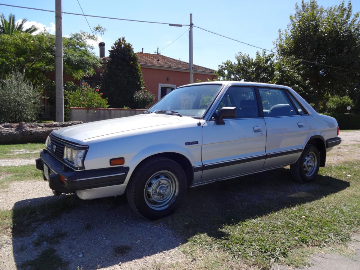

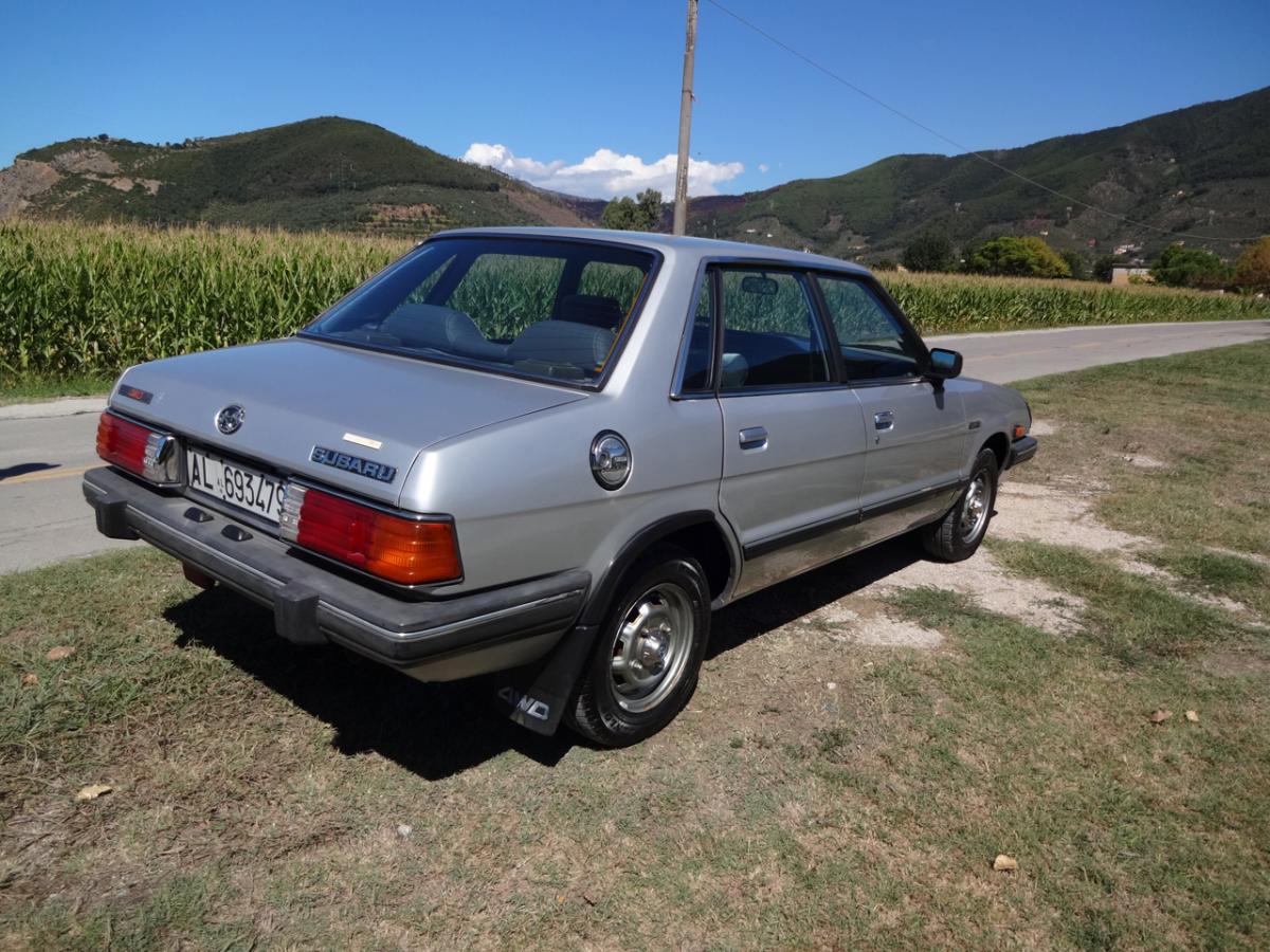

alastor555 Posted January 28, 2015 Share Posted January 28, 2015 Being a devoted Subaru fan, last year when I saw a 1984 Leone for sale in northern Italy I just couldn't let the occasion go, and I went on and bought it. It is now in good company with a 1999 Impreza type-r and a 2004 Impreza WRX Wagon. It is very rare to find 1980s Subaru cars in Italy and Europe in general, I think they are much more common in USA and Australia, so I didn't want it to end in a scrapyard. The car (I attach a couple of pictures) is a metal grey Subaru AB5 sedan with 1.8 liter engine, 4 gears manual gearbox and AWD. In over 30 years the car has covered only 90000 miles. It was in decent condition when I bought it but it had a bit of rust, a rotten exhaust and a noisy wheel bearing, so I had some mechanical work done at my Subaru dealer and fixed the rust. For the past year or so and few thousand miles the car has been great, I think one wheel bearing is still making a bit of noise so it will have to be changed soon. The front windshield has many little scratches which are annoying when facing the sun, I think I will change it with a newer, safer one. Recently I also started to hear on startup a loud noise similar to that of a liquid flowing in a pipe - apparently located just behind the dashboard - proportional in intensity to how one accelerates... It goes away after a few miles once the car is warm.... no idea what that is, it would be a great help if someone had any suggestions about it. What I would like to do is to slowly "rejuvenate" the Leone, changing the parts that are going to break eventually, before they actually break... Some preventive maintenance to avoid things going wrong, with a budget of around 1000$ per year. I hope some of you have experience of these cars and know what needs to be done to keep them fresh... I was thinking for instance to replace the water pump, gasoline pump, clutch and brake lines. Maybe the gasoline tank also? Any suggestions and feedback would be very welcome to make a proper to-do list for keeping the Leone in shape! 1 Quote Link to comment Share on other sites More sharing options...

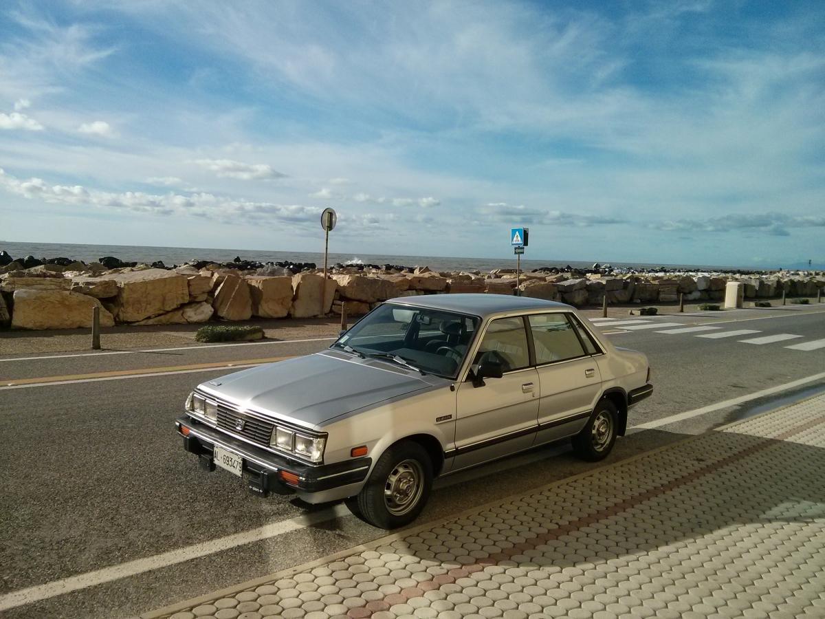

alastor555 Posted January 29, 2015 Author Share Posted January 29, 2015 Another picture, at the sea, near Pisa Quote Link to comment Share on other sites More sharing options...
