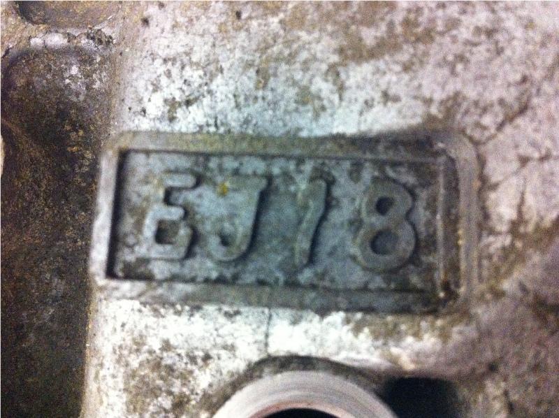

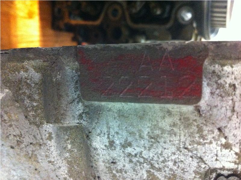

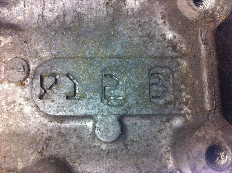

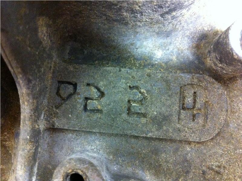

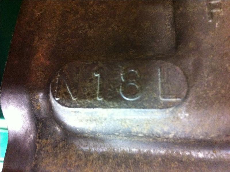

First: Best web place to ID this block?  All I can see is cast numbers: 92-2-4 on one half, 91-2-3 on the other.
and AA 22212 I can figure out eventually. Any other numbers I should look for? I cant find any Serial numbers....

   Looking at the block cast numbers of 91-2-3 and 92-2-4 do I have 2 different engine's block halves?
   And having the numbers AA 22212 and AB on the other block half could roughly guide me as to where to place the pistons? They came disassembled from the rods.

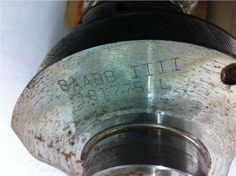

I don't know the situation and I could be way off base. You do realize that these engines are easily available for very little money if you shop right. There really isn't a good finacial reason to re-assemble these. From the looks of the crankshaft in the picture this engine will need some attention before it put back together. I would polish and mic the crank at the very minimum. I am not trying to offend you or rain on your project in any way.  It could be a good learning experience ;)

Crazyeights, thanks for your candor.  I had a nice review of the parts with my machinist and we came to the conclusion the block needed honing at $80, the crank needed grinding at $175 and then there's rings, bearings, seals. About the same $ as a used low mile 1.8 engine. Alls to be gained from rebuilding is the knowledge that there's new parts and I know the condition intimately.
