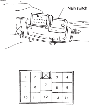

Khamier Posted March 10, 2015 Author Share Posted March 10, 2015 Looking at this diagram, points 7 & 12 are power/ground, and the rest are for the switches. I put a meter on 7 & 12 but only get 4V. Should this be 12? Quote Link to comment Share on other sites More sharing options...
Fairtax4me Posted March 10, 2015 Share Posted March 10, 2015 Yes there should be 12v going to the switch. Diagram says it should be a black and yellow wire. That's your 12v source. If it's less than that check voltage on the Black yellow wire in the door harness connector down behind the kick panel. Its a large 24 pin connector. Quote Link to comment Share on other sites More sharing options...
