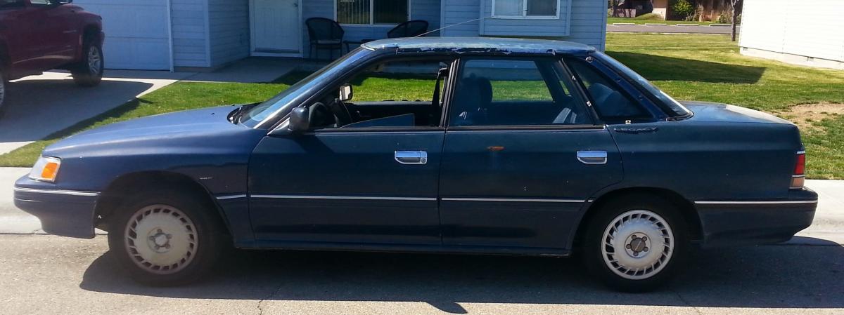

lstevens76 Posted April 1, 2015 Share Posted April 1, 2015 (edited) Prior to roughly Spring of 2014 I know nothing about this car, other than it was in Washington. My grandfather bought it for my Uncle who had fun getting a title. It started making a horrid noise (will get there) and he parked it so I bought it for what was originally paid ($200) minus any costs getting the title. I already was sure of what the problem was when I bought it, and I was right. One of the idlers (the cogged one) for the timing belt had blown apart internally. Fortunately it wasn't driven really after this happened so a new timing belt, idlers, and water pump and it runs. Now to the issues: 1.) I get intermittent Battery, Stop Lamp, and Brake lights all at the same time on the dash. What's weird about this even more is the headlights brighten when these come on, not dim, and when they go off they dim. This light issue isn't consistent though (brightning and dimming) and I don't know if that happens much during the day. The battery has been replaced since I've owned (been running almost a month now). 2.) I need to pull codes (been reading on that) as I have a rough idle, but sometimes it smooths out, and sometimes it doesn't. Today was the first time I've seen the check engine light so I do want to pull codes, but I'm all ears for any other ideas. When the timing belt was done I also replaced the plugs and wires (NGK Platinum and Bosch Wires). 3.) When turning to the left I hear a "hum" from what seems to be the right front. This only occurs when turning to the left, and at no other times. 4.) Drivers side window (see picture) tilts to the front, likes it's off the front track. I looked inside and it appears it has a regulator and a slider in front. Does the slider actually hold the front of the window in place or is this a problem with the regulator staying level? I may come up with more issues later, but these are the most pressing ones. This is my "gas saver beater" I use to run my son to and from school so I want it to be safe and reliable. Thanks. Edited April 1, 2015 by lstevens76 Quote Link to comment Share on other sites More sharing options...
