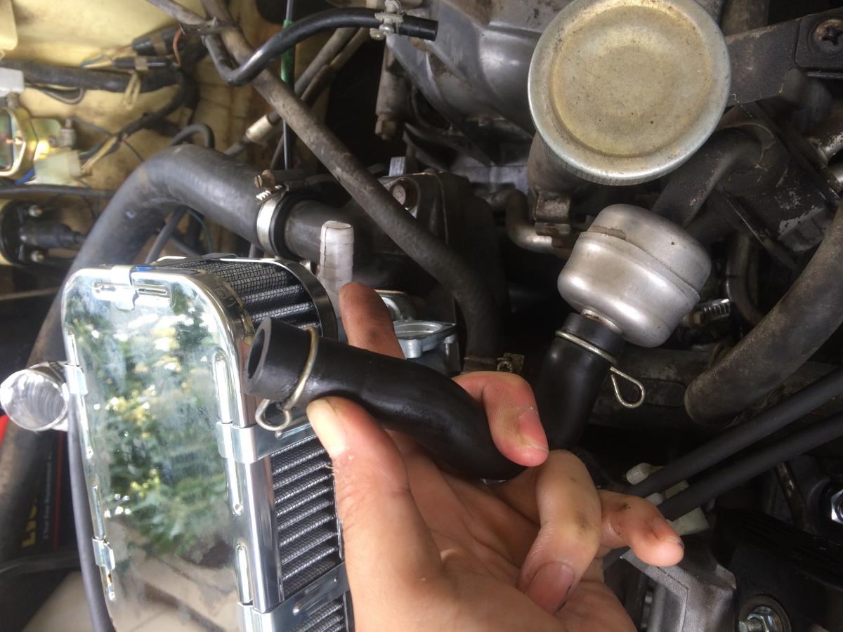

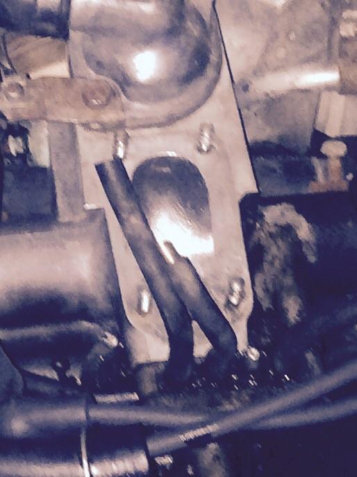

Here comes the questions. I put the weber carb on my subaru but not really sure what to do with all the lines because I'm really new to these DIY car fix. First of all, what do i do with the air intake hose? It was connected to air cleaner before but since i ditched the big blue air cleaner I'm not sure where to connect to air intake hose.

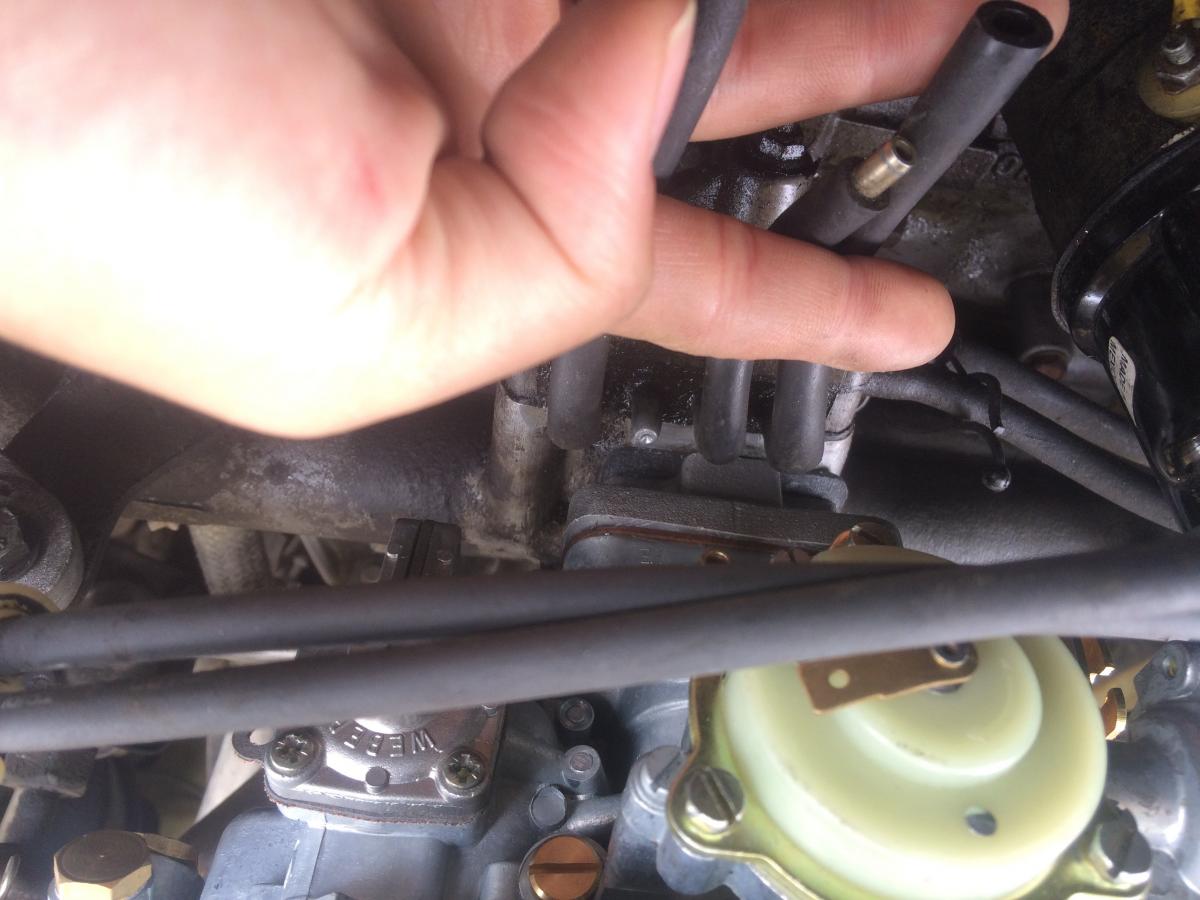

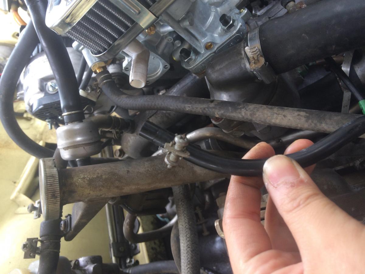

I have these three lines comming from the frot if manifold and not sure which one goes to carburetor and which one should be vacuum capped.

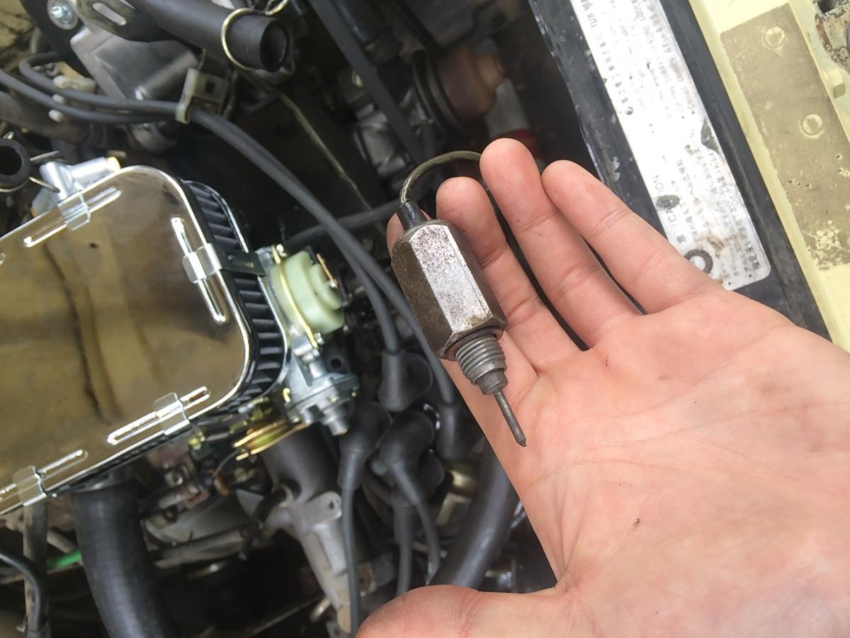

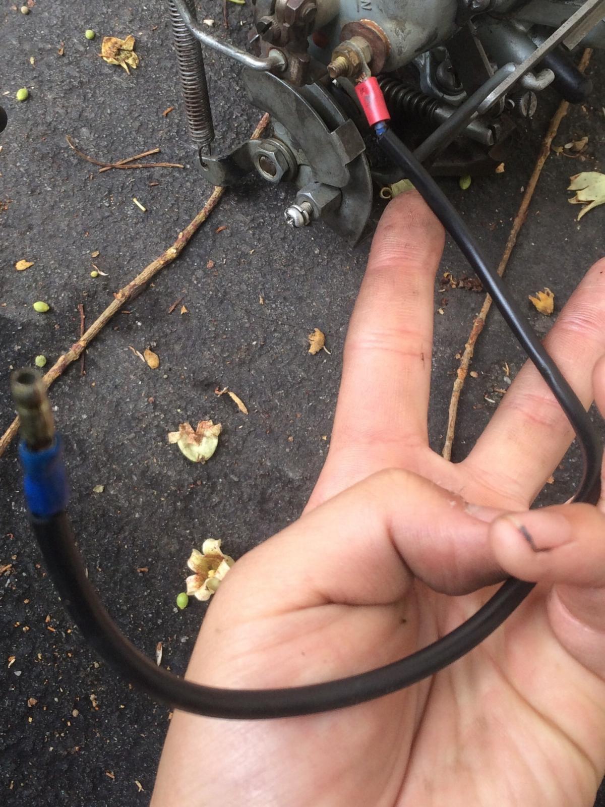

Finall two questions!! I not sure waht to do with the anti dieseling thing. It seems like there's no part for it on weber carburetor. And what do I do with the cable that was originally connected to thermosatat cover on old hitach carb? Help!!!! Thank you everyone!

The anti-diesel solenoid isn't used on the Weber. Make sure that your initial idle speed isn't too high and that your idle mixture is spot on to avoid dieseling.
On my EA71 with Weber, the previous owner plugged the three-nipple vacuum switch/solenoid and every other vac port. The EGR is unhooked also. The only vacuum hose being used is the one for the vacuum advance for the distributor. Not saying that this particular setup is correct, but my Subaru runs pretty spot great with all those vacs eliminated.
EDiT: I think I read somewhere on here that the vacuum line (the one that comes from beside the fuel line) is a vent for the fuel tank? I recall someone saying that it's okay to leave it open, and to put a filter on it to keep it from getting clogged with debris. The old wires from the Hitachi are eliminated. The only wire you'd need for the Weber is a switched positive for the choke. The PO of my car didn't have the choke hooked up, and it runs pretty decent cold. Something is askew with my linkage, as I can only get like a 1/4 of a choke with the air plates. There's a stop on the brass linkage that prevents mine from going any further. So with that, I figured I would leave the choke plates wide open so as to not affect performance once at operating temp.
If you were to run a choke, look for an electric solenoid as a power source to splice into. They are usually powered with the ignition switch. The PO is running my fuel pump off of such a wire.

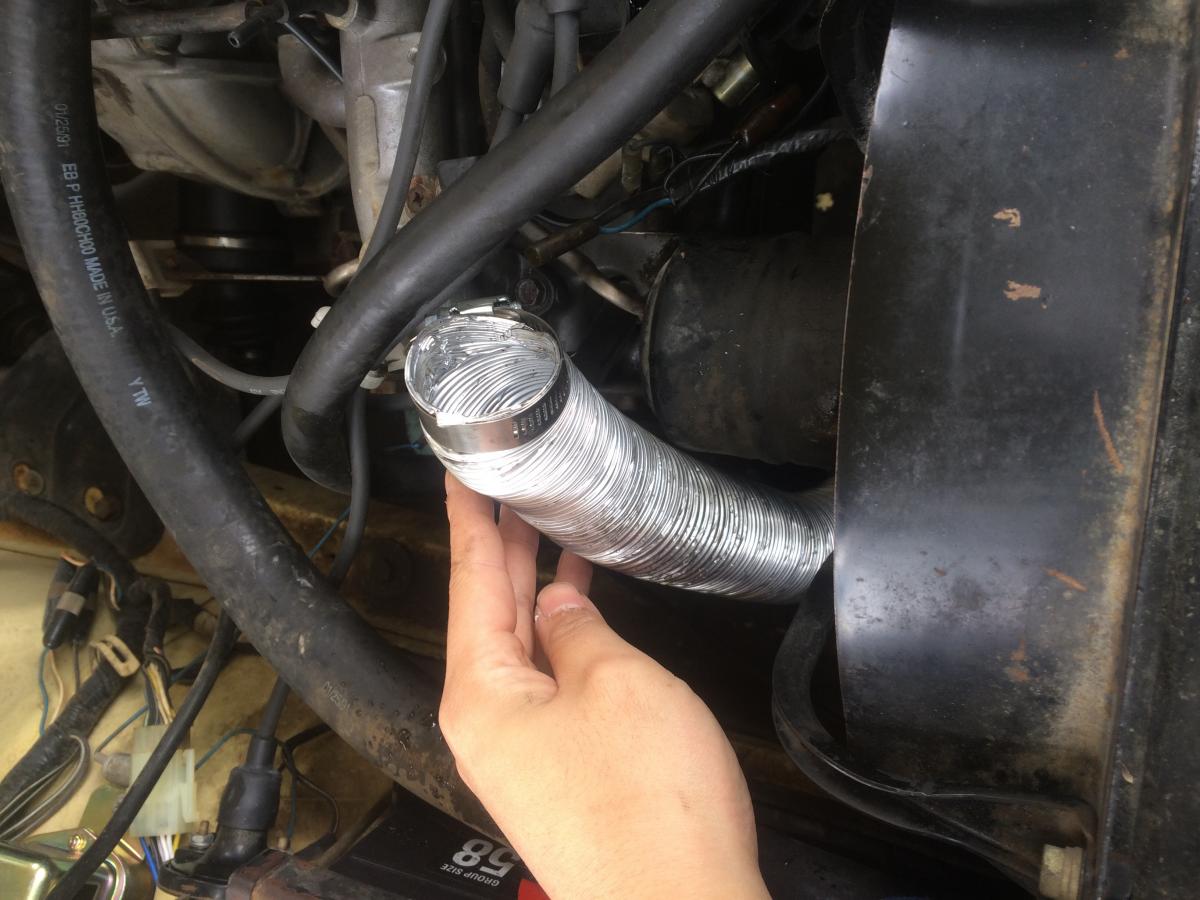

EDiT: And that big foil looking hose coming from beneath your engine (runs from your exhaust, your second picture post) is the preheat to your carburetor. You likely do not need it. If you were to use it, you would have to make a custom filter box for your new Weber. The easiest solution would be to take the new Weber lower filter plate and slap it on your old filter housing. Trace the new weber opening onto your old air cleaner, cut it out and put it on your Weber. Then you can hook all your old hoses back in their original locations.
I'm not sure exactly what this one is. Mine did not have this. It doesn't look like the line is factory, maybe it was a "cold air intake" hose?

Yes  I think it is cold air intake hose. I changed the original hose because it was getting ripped apart.

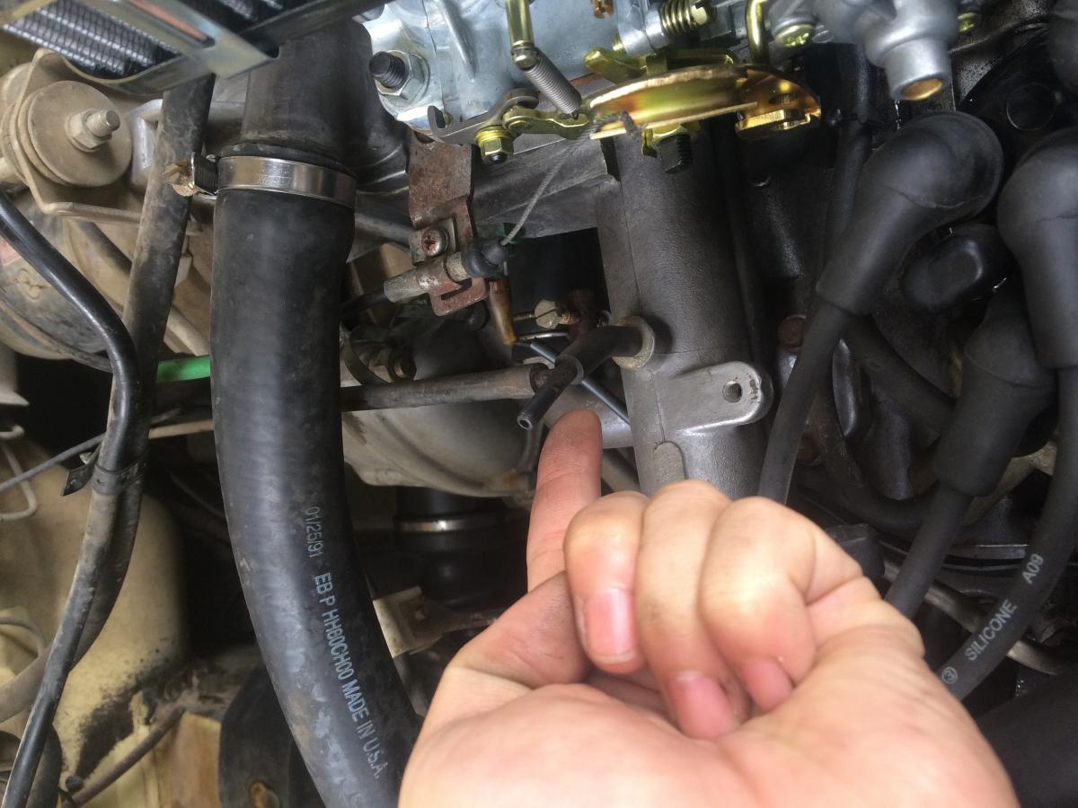

But the question still remains. I'm not sure what to do with the lines that was originally connected to the diaphragms.
And I still don't know which ones to cap and which one to connect to the carburetor among the three lines from the front of manifold... pleas help!

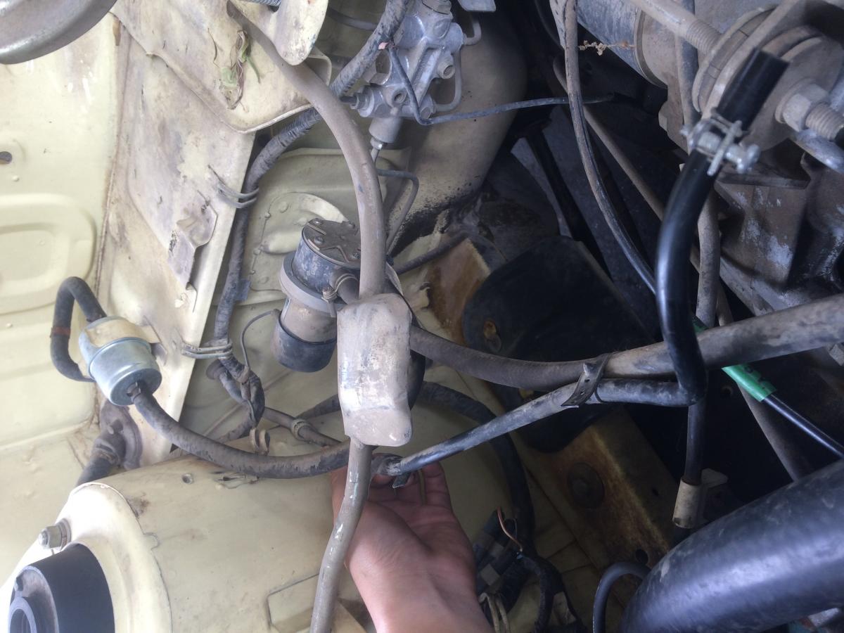

Also I have another line next to fuel line which was also connected to air cleaner and i don't know what to do with.. The line comes all the way from the back.
That line is part of the emissions system. I runs from the small expansion tank fitted at the rear of the wagon to catch fumes from the fuel tank. It is then feed back to the carb to be 'recycled'. Basically it prevents fuel vapour or fumes being released into the atmosphere.
