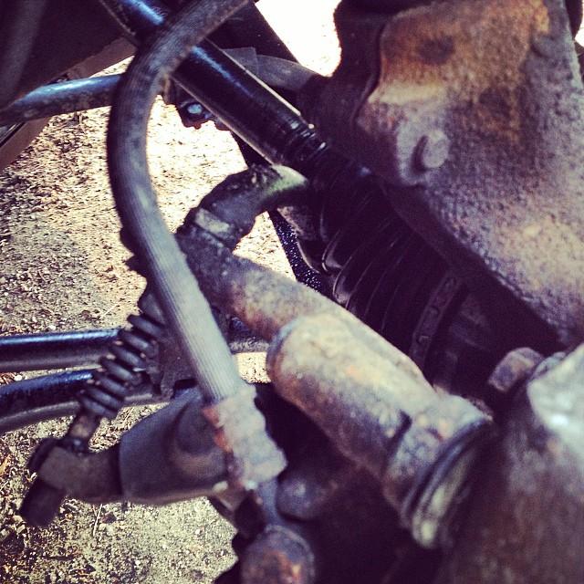

iluvdrt Posted June 14, 2015 Share Posted June 14, 2015 I had squishy brakes on my 82 Brat. Change the rubber brake lines. Chances are they've never been changed. When I did mine it stopped like I had Brembos...not really, but it was WAY better. You can get them off of Rockauto cheap. 1 Quote Link to comment Share on other sites More sharing options...
MDW Posted June 14, 2015 Author Share Posted June 14, 2015 I just returned from a trip up-north to the Manistee National Forest. The BRAT, rode like a CHAMP! all thanks to @Mechanical_misfit Before I took off, he hoisted it up in the air and did an inspection. Results were very encouraging. -Gas Tank, rusted, needs to be replaced or mended. -Oil pan needs to be re-sealed right away. -Need light patching on the undercarriage and a coating to prevent rust -The rubber boot is off of the right axel, I am uncertain if that is an issue or not, although I imagine it will be down the road. After the inspection he balanced the tires and tweaked the alignment. The ride was smooth, I am so thankful! I have had some time to think about what I would like to do with the BRAT and I'm fairly certain I have a good path. First it will be called Mission Control... I'm pretty much a huge space nerd and love being outside under the stars. This car will be command central, mission control. It will be taking on a futuristic spaceish theme too! It's going to receive a new paint job, flat black exterior, flat black interior. I would like to make a center council out of diamond plated steel. It's not structural so I am hoping to find a lightweight version and find someone who can shape it. CB-Radio and a small amplifier to use my iPhone instead of a normal car stereo. Something like this: (http://tinyurl.com/nutyzxp) I would like a roll bar and brush guard, but I am leery about adding too much weight to the car, function over form! I will most likely go with a 4" lift, which I might do sooner than later depending on the availability of ea81 4WD and FWD Gas tanks. I may buy larger tires, not sure how silly a 4" lift will look with the tread I have on it now. I'm going to use the Subaru Star Pattern and make an emblem, with "Bi-drive Recreational All-terrain Transporter" on the back, or somewhere. I would like the Weber carb, but I have a re-built Hitachi Carb and too much money to spend on crucial items right now. Although I have an odd feeling I will be picking one up much sooner than later. I would, however, like to remove some of the unnecessary emission control components. I have been thinking of designs for removable storage in the "truck" bed. probably be a framed with paracord sides that can be tarped, black or olive green tarp, when raining. Thats the idea so far. She is an empty canvas right now. @iluvdrt I had squishy brakes on my 82 Brat. Change the rubber brake lines. Chances are they've never been changed. I have a bunch of goodies coming from Rock Auto this week, I will see how it does after all that goes on. I'm thinking there is no way they have been changed either! Thanks for the heads up, I will add that to the grocery list! @dinky26 If you're pulling the mounts out, are you wanting to keep them or would you be game to sell em? I just have the mounts that the back rest slide up and down on, I don't have the platform that the seats rest on. If you need those back rest mounts, I am certainly game to sell them so they can go to a great home! @TomRhere If there is any play in the throttle shafts of those Hitachi carbs you have, they're done for. The Weber is a nice upgrade. Although, I prefer to install one using the EA82 intake instead of the EA81's. Only because of the larger port opening under the carb. I have been doing a bit of reading on this and would certainly be interested in making this kind of upgrade. I will probably install the re-built Hitachi that I have for now and cross my fingers that it will be better than terrible, until I can pour some cash into that part of the project. Unless I could get an alright price for my re-built hitachi... @TomRhere EA82 4WD models had the self-adjusting rear brakes. Not real sure of what years, but my '88 Wagon had them. Easy swap, slightly larger brakes too. @mechanical_misfit mentioned this too! This is why I love Old Gen Subarus! @tomRhere The gas tank is most likely rusting out on the top, at-least 3 of the BRAT's I've owned had that issue...... You can run the EA81 FWD tank in a 4WD vehicle if you lift it 4" or more. I suspect this is the case. It looks like there was some heavy hauling done in the past, the bed is concave and resting on the top of the tank. I am considering buying a welder to attempt to repair the tank myself, and add some structural support to the bed. It's a good excuse to buy a welder If that fails I am planning on a 4" lift so that broadens my scope, and might expedite the lift on my priority list. @TomRhere I have a few BRAT related parts here, not a lot, but some. If you need something, ask. I may have it. Thank you kindly, I will keep this in mind! Thanks everyone for the input, comments and suggestions! Quote Link to comment Share on other sites More sharing options...
