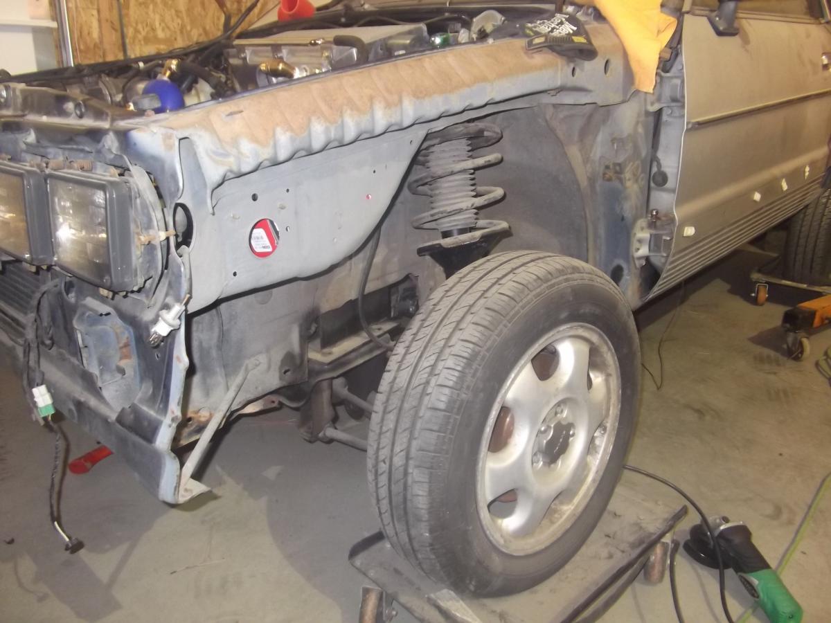

Posted 17 December 2015 - 07:18 PM
Here is one of the front suspension with a 4 inch lift.

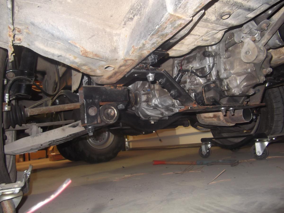

Posted 17 December 2015 - 07:22 PM
Here is one of the brackets I made to allow for the Ej suspension to bolt right up.
Attached File  DSCF3273.JPG   122.75K   83 downloads
Once the Ej suspension is in, it widens the Brat by 40mm on each side. So I had some 5x100 adapters made that gave me just that.
