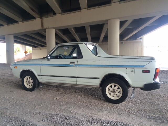

Hi folks,
I know this has been covered a million times, but unfortunately I can't find a clear answer.
I'm looking to swap out my old tires (165/65R13) for new shoes before attempting to drive across the country.
I'd like to go as large as possible without running into any rubbing issues or requiring any sort of lift or fender cuts.
It seems as though folks are recommending 165/80, 175/70, 175/80 and some 185/70.
Does anyone have experience/recommendations with any of these on a Gen1 Brat?
I'm leaning toward 175/70 to be safe, but I'd love to hear what people think (and see any pics that might be floating around).
Thanks!

Thanks for the help folks, just wanted to update and let everyone know I went with 185/70R13 and they fit fine.
A few more things to tackle (axle replacement, weber swap, pertronix installation) and I'll be attempting to drive my Brat from Vegas to Toronto via Route 50.
