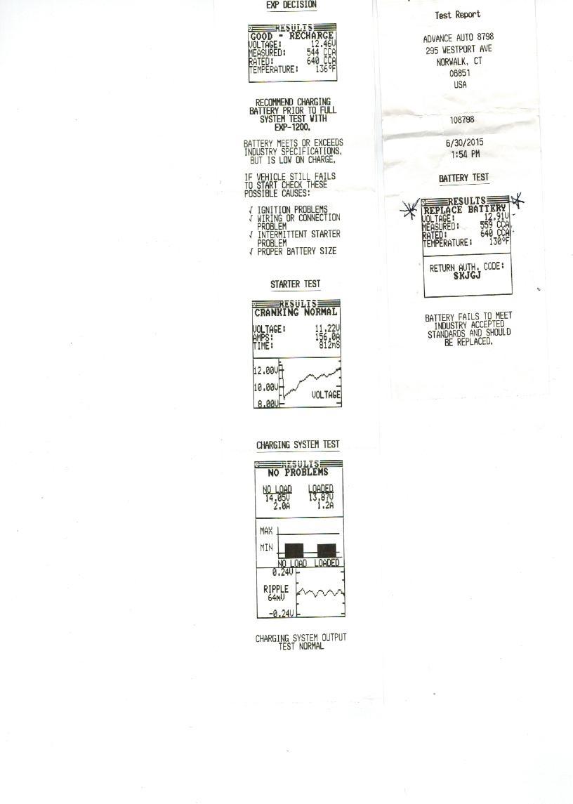

Figured battery at end of life so drove it to Advanced Auto for a free evaluation. Rep hooked up machine and got a readout "Replace Battery"
Drove a while longer (bought a replacement from Walmart) and then figured I'd check again so went to a different Advanced Auto and it now appears to pass.
I have attached both printouts. The "replace battery" was the first. Any feedback appreciated.
The first store told me that the system couldn't be checked any further with a reading of "replace battery". I took the rep's word but then did go and get the second opinion and that was the complete readout.
The second one says the battery is good... that was about one hours worth of highway driving after the death sentence...
Still puzzled.

Too hard to say based on very limited info on the printout.
The thing that puzzles me about that is the Voltage reading says 12.9v. A battery at rest should not be above 12.6. That could indicate a damaged cell in the battery.

but getting back to the odd readouts - how long had the car been run before the 1st reading (the "replace battery" one), and yeah - 12.9 v? i missed that...

Car started without issue and was run for about 20 minutes before the first test that resulted in the "replace battery" reading.
Similarly, car was run for about 20 minutes before the second test (good-recharge)
BTW: looking at the test results, is there any explanation for the variable CCA readings? The battery is rated as 640 CCA. The initial test result (replace battery) was 559 @ 130 degrees and the second (good battery result) was 544 @ 136 degrees. Each of these represents a reduction of about 15%

Trying to charge a almost dead battery by running a vehicle 20 minutes is going to be iffy at best, and they may be the reason that it tested bad on the first test.  You should of put it on a charger overnight and then had them test it.  I believe what happened on the second test is that you ran the car enough to fully charge the battery, so it tested good.
I would still put the old battery on a charger overnight and then have it retested.  Also have the charging system also tested.  You may of just had a light on inside the car that drew the battery down when it didn't want to start the first time.

replaced battery today sticker on old one indicated 7/10 so at or near the 5 year mark
the rest of the discussion is academic at this point
yea, at 5 years, it is worn out or nearly so. Bet all is well with a new battery.
