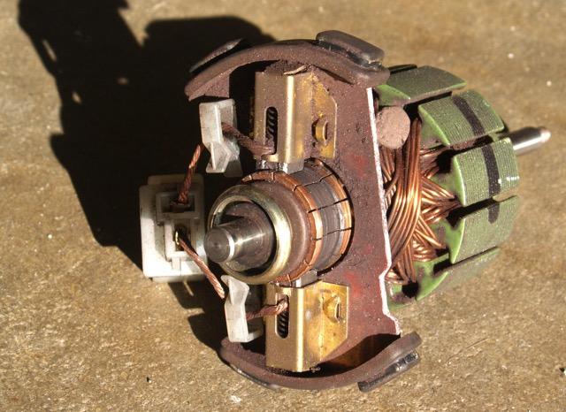

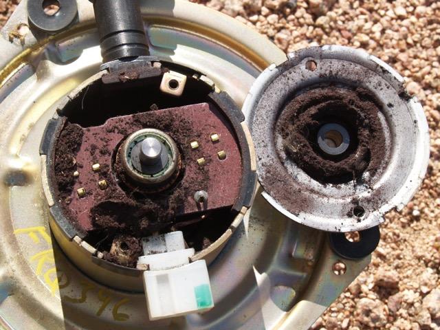

The blower motor brushes eventually wear out causing these symptoms of intermittent failure. Sometimes just removing and cleaning out the motor helps if something is physically interfering with the fan. Here is what a dirty motor looks like when you remove the base plate, and what the worn brushes look like.post-50719-0-98206900-1513261100_thumb.jpgpost-50719-0-05775700-1513261117_thumb.jpg
