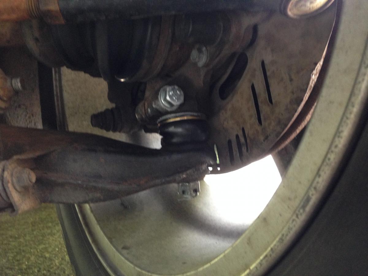

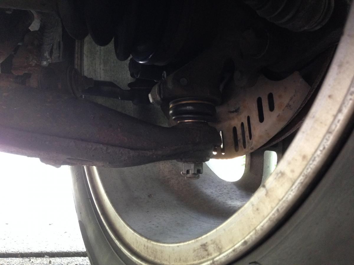

rendoll911 Posted August 29, 2015 Share Posted August 29, 2015 (edited) I installed two new MOOG ball joints on my 96 legacy. Got the car aligned and noticed the next day that driver's side BJ boot was torn with grease leaking out. I replaced the ball joint thinking it was defective or the shop messed it up somehow, but now the second new ball joint looks like a balloon ready to pop, perhaps the same fate as the last ball joint. Did i mess up the install or something? first picture shows bulging ball joint boot 2nd shoes normal ball joint on passenger side Edited August 29, 2015 by rendoll911 Quote Link to comment Share on other sites More sharing options...

Fairtax4me Posted August 29, 2015 Share Posted August 29, 2015 Did you apply grease to the outside of the boot at the bottom? The boot has to slide around when you turn. If there is no grease on the bottom it sticks to the control arm and can rip. Should be able to pull the boot up with a small screwdriver or pick and wipe some grease under it. You could also try poking a small hole at the bottom so air can get out. Quote Link to comment Share on other sites More sharing options...
rendoll911 Posted August 30, 2015 Author Share Posted August 30, 2015 i didn't apply any grease thanks for the tip Quote Link to comment Share on other sites More sharing options...
