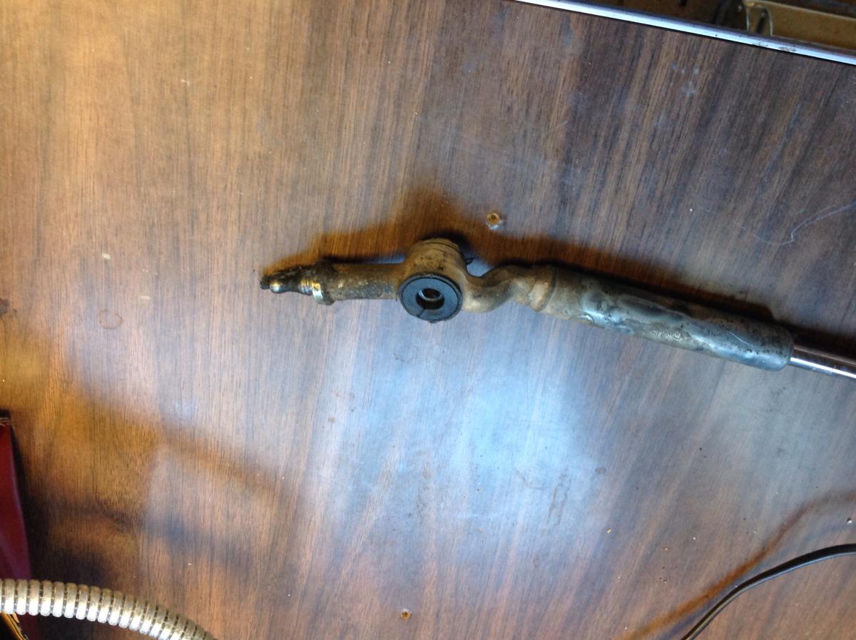

clantieri Posted September 16, 2015 Share Posted September 16, 2015 Hello, I've read a few posts about fixing shifter slop on a 4 speed D/R transmission. I used the tap method to change the roll pin to a 3/8 bolt. Worked great, thank you. Before I put the trans back in my car (just swapped due to synchro probs with a junkyard unit), I wanted to tighten everything else up. I've seen multiple posts stating that the bushings are still available from the dealer. I am specifically looking for the bushings where the shfiter attaches to the shift mechanism and a bushing at the bottomwhere the bottom of the shift rod anchors and pivots. I called a few local dealers here in CT and they dont list any parts prior to 1989. Do you have any info on who I can call to get these parts? Part numbers? My car is a 81 GL wagon 4 speed D/R, trans is from an 84 (exact match) Any help would really be appreciated. Thank you. Chris Lantieri Hebron, CT Quote Link to comment Share on other sites More sharing options...

ihscout54 Posted September 19, 2015 Share Posted September 19, 2015 GDs tap n bolt trick will fix 90% of the slop. You could easily rig up replacements for the shift shaft bushings after a trip to the hardware store. Seems SOAs system simply calls the parts bushings, some of this stuff is still available via Subaru and third parties. Some google-ing of these p/ns will get you close to what you need. Thanks plucky from ausubaru for these numbers. Shift shaft to lever: Rubber bushings 733229010 Nylon 633124170 Sleeve 633042030 "Ball joint pivot" bottom of lever: Boot 631504021 Bushing 733146090 Parts for the lower "ball joint" pivot seem semi extinct. Quote Link to comment Share on other sites More sharing options...

clantieri Posted September 21, 2015 Author Share Posted September 21, 2015 I am unable to do links. Go to the Repair Manual forum on here, then the Transmission/axle/brakes section. "Tech tip-EA81 4-speed sloppy shifter bushing fix", by pressingonwards. He has a good write-up on hardware store items for the upper shifter bushing. Thank you, i actually used that one and made my own for now. If I can get an OEM set for spares, even better! Quote Link to comment Share on other sites More sharing options...
